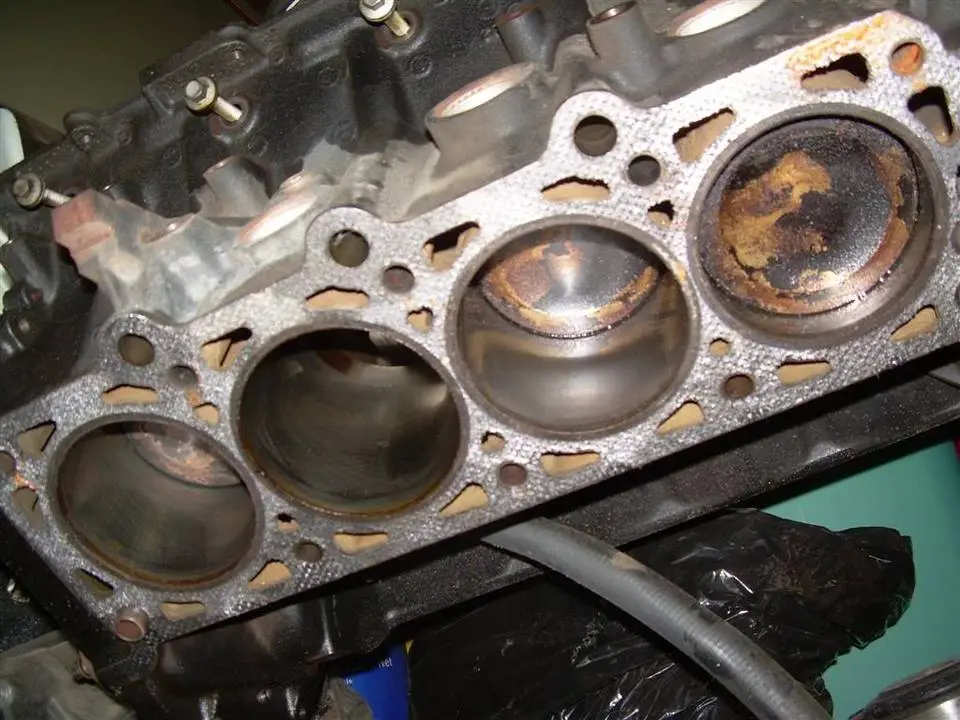

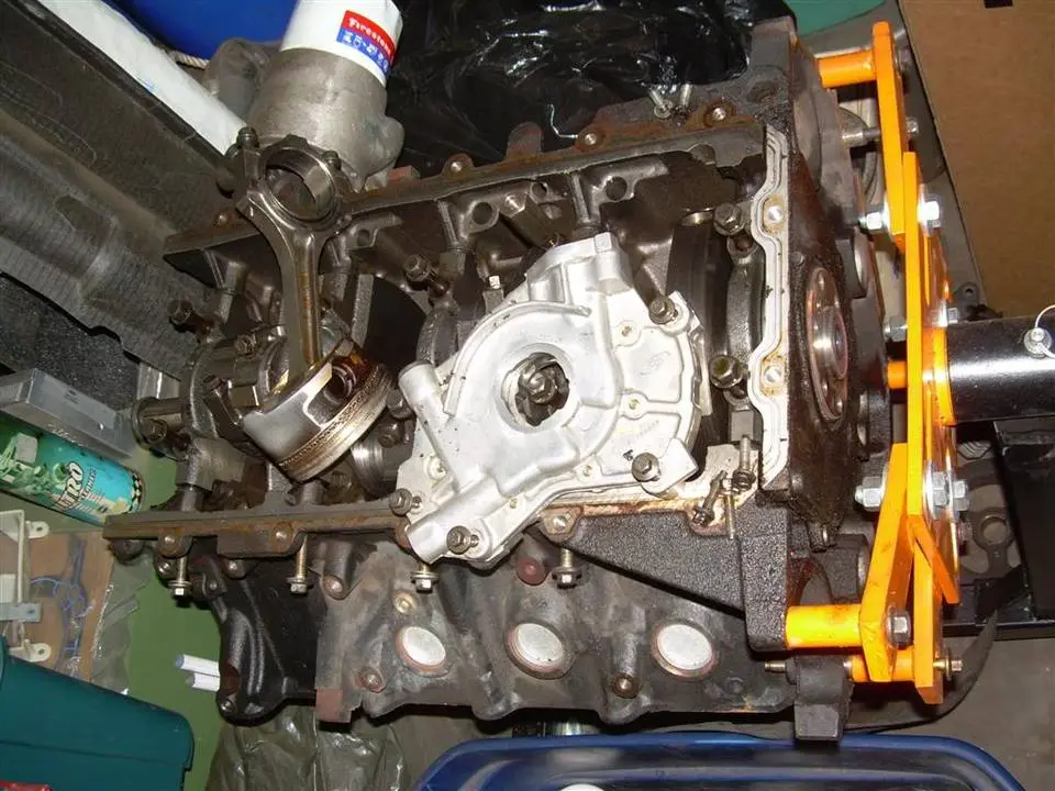

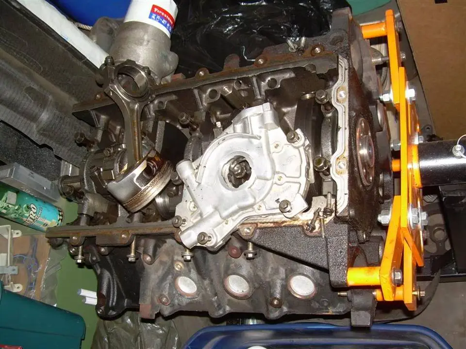

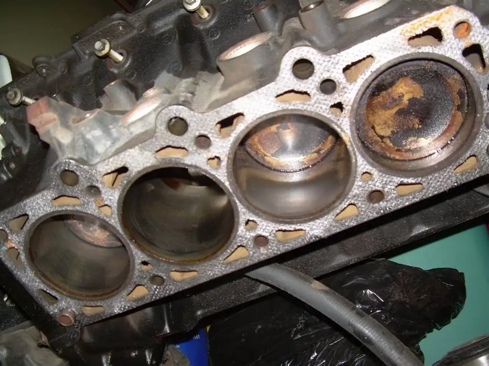

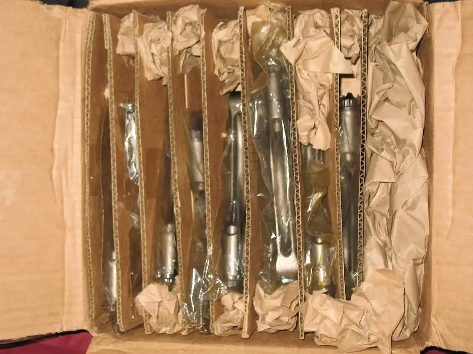

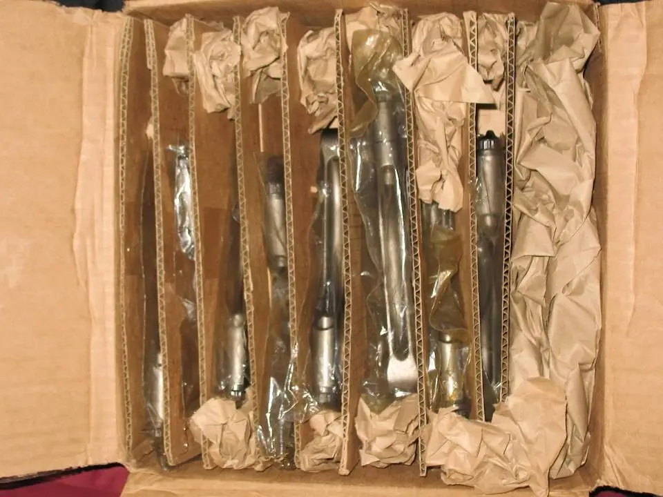

Free '97 shortblock (spun a rod bearing, may or may not use crank based on that)

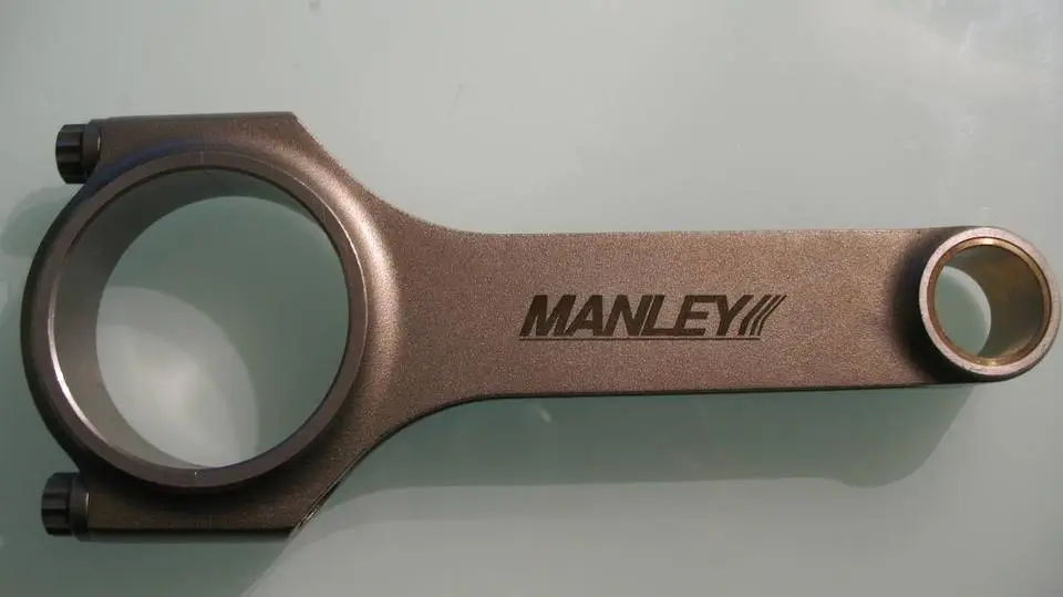

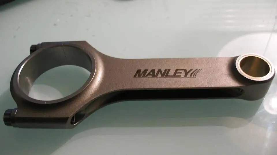

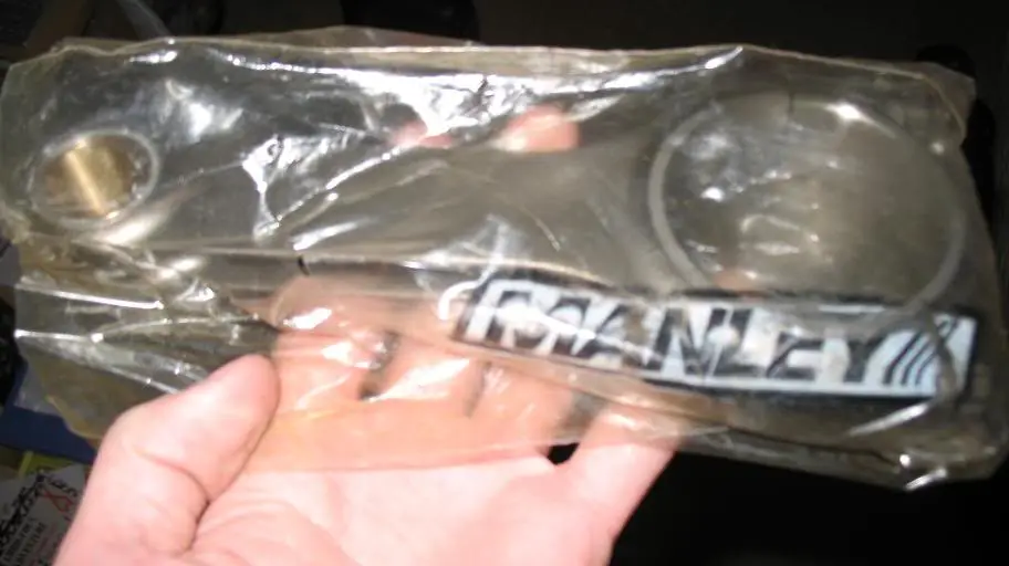

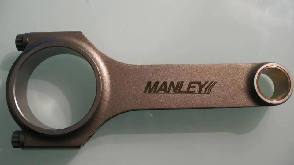

New Manley H-Beams with ARP rods bolts

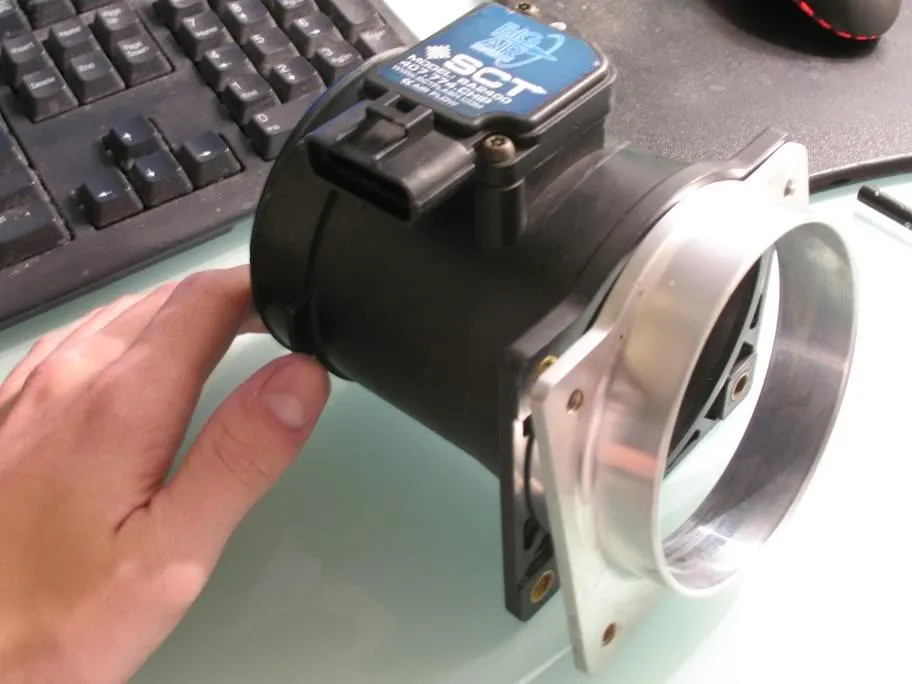

SCT Big Air 2400 (pending sale)
255lph Walbro Inline pump, soon to be coupled with 255 intank pump using stock lines
- First of all if I told you guys how cheap I got each of these pieces you wouldn't believe me - so I wont.
- Block has a hot date with MMR starting halfway through December. They've agreed to keep it for awhile after checking to block to see if it need a boring job (4.7L FTW?), and checking the crank. That way they can hold it while I shop around for pistons (.20 over or stock) and maybe crank.
- Not sure what I'm doing for crank right now. May use this one, it may need a thousandth taken off. May find another. May find an 8 bolt cobra crank and have to buy an 8 bolt flex-plate.
- Stock 2000 GT flexplates will work for 8-bolts right?
- I'm taking opinions of what people think I should do. I've researched many routes for this build. I'ma let stangnet have some fun in working through my wallet - especially since there's no rush on this, it's mainly a through '09 build unless I put the shortblock in with my current heads earlier and do boost after that.
- My housemate is trying to get me to go single turbo:shrug:
- First question: Should I have MMR put in a high flow oil pump while they have it? At what power level is it required.
- To give you guys an idea of power target, refrence the SCT 2400 MAF and stock fuel lines, stock fuel rails, and no fuel tank sump.
~Thanks got the long read~

Feel free. This is a good thread for anyone who has questions/discussions about a build, what internals to go with, what's needed for 400-500rwhp, 500-600rwhp ect. Yeah, i like that i got the shortblock for free too - just my price.
Hey cobrared nice first of all! How much are you looking at for MMR to do all this?
$300 to bore .20 over if i need it. Which isnt bad since that's only $37 a cylinder and they have to angle hone (or whatever you call it) and double torque plate. Balancing is $150 of full rotating assembly. It'll be $50 for MMR side block bolts for 500+rwhp apps. I think that's all, +bearings.

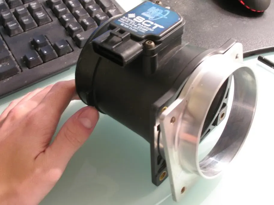

Got the SCT2400 BigAir and an adapter plate for almost the price of a LMAF.

As for rods/pistons, I've got Manleys on mine, and thought they were great bang/buck for what I'll be pushing mine to. What do you plan on doing for/with your heads?

The compression will be like 8.9:1 with 18CC pistons that I have yet to look for since i'm not sure on the bore yet. It's not the block that's in my car so I can make it what ever I want for now.
I plan on using my MMR stage II PI heads on the new shortblock. Take my engine out, swap over stuff like timing cover, pulleys, manifolds and then the heads to. Plop her back in. My main beef is my cams - if i don't go turbo i'll need to switch them out. Luckly they are worth as much as a good stage 2 blower cam.
