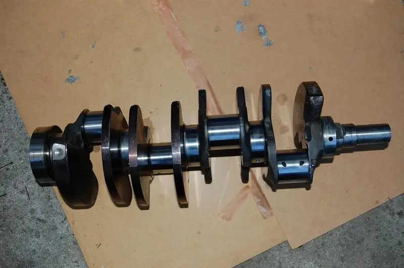

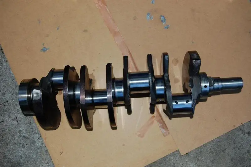

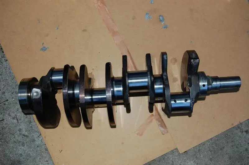

Bought today:
Speed Pro main bearings:
And ARP Mainstuds:
Man, I know it's a little late but this just popped into my mind...
Store that crank upright, and not laying down!!! I'm sure you know that and just took the pics with it laying down, but just in case...:nice:

Just curious, why is that?

Yeah, my crank is at MMR - so I assume that's what they are doing. I have a crank right now though that I'm selling, but it wont stand on the flywheel bolt end. It teeters over, she's pretty though:
The way I understand it is, with the crank laying on it's side, the counterweights over time could potentially cause the crank to bend or bow. Sitting upright the weights aren't sagging on it like that.
When the crank is in the motor of course it is supported by the main caps.

So then sitting upright wouldnt it put greater force on the lower lobes and cause more of a chance of bending the end of the crank its sitting on?
If you look at the last lobe all the weight would be pushing on it and close the gap for the end two cylinders, no?
I get what you are saying and it makes sense, but I really don't have the answer to that to be honest with you.
Just passing along what I have been told a few times...:D
I believe its balanced enough so that no more weigh is applied on the open journal-less end than at the journal bridged end. If you go to a place that rem-mans cranks you'll see whole floors of cranks standing on end shrink wrapped. The point is also to not have the counterweighs being layed on anything, they aren't really supposed to ever touch anything but oil in use.
