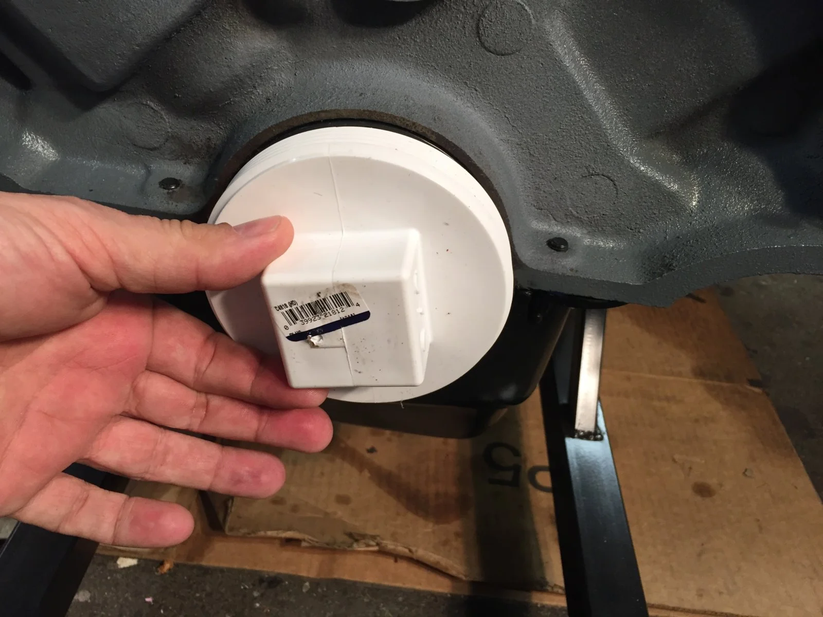

I used the fel pro sleeve. I think it’s Felpro 16250 and their install tool. The tool is listed on the package for the sleeve, so I don’t recall what it is now.

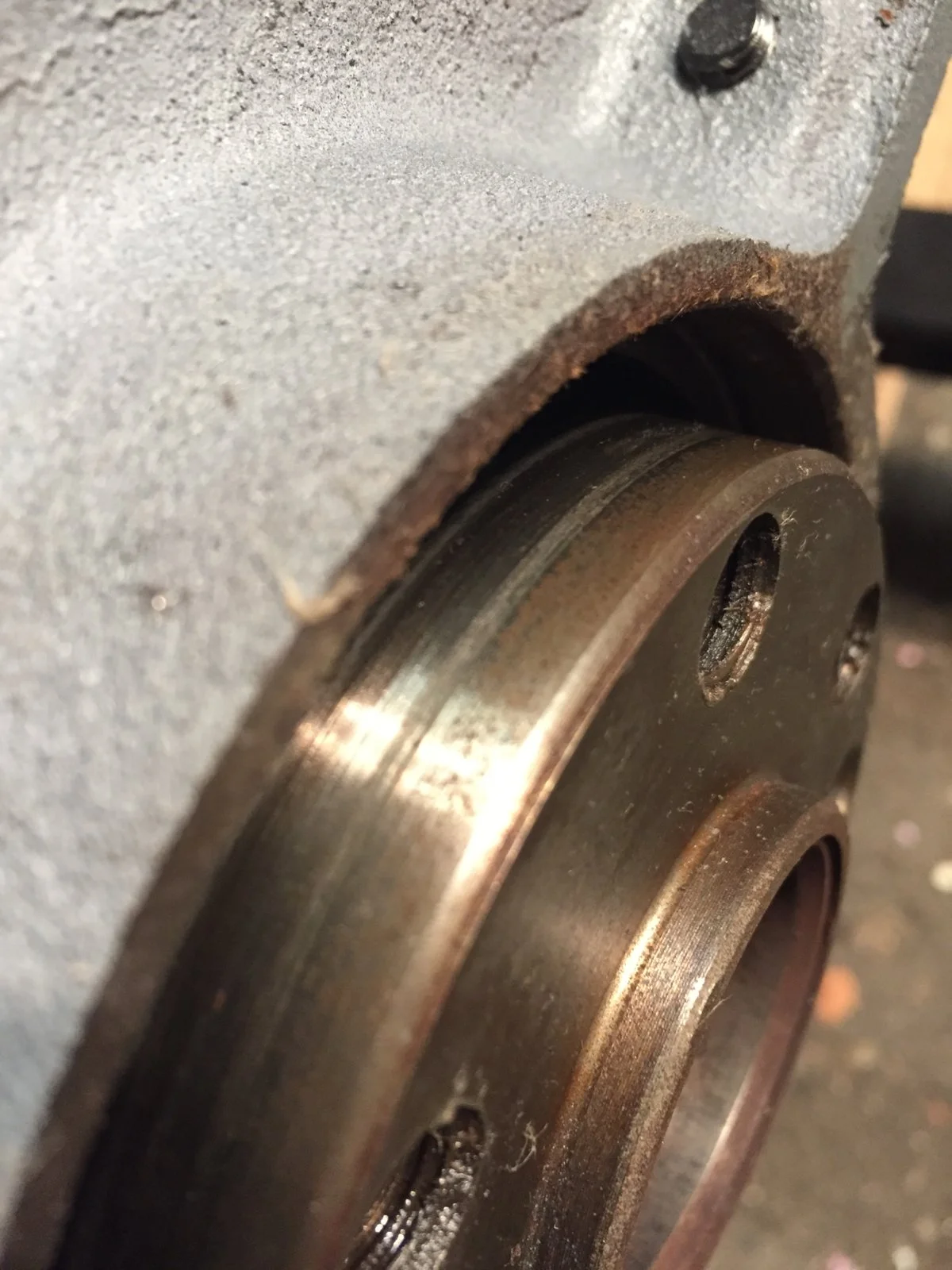

as to why I sleeved it? Well this was how my 100k mile crank looked. You can see the groove, but really can’t feel it. I did a RMS 3k miles ago and it leaked. This time around I inspected closer and saw the groove. Hope the sleeve and new seal work
picture looks way worse than it was. There was nothing you could feel with finger.

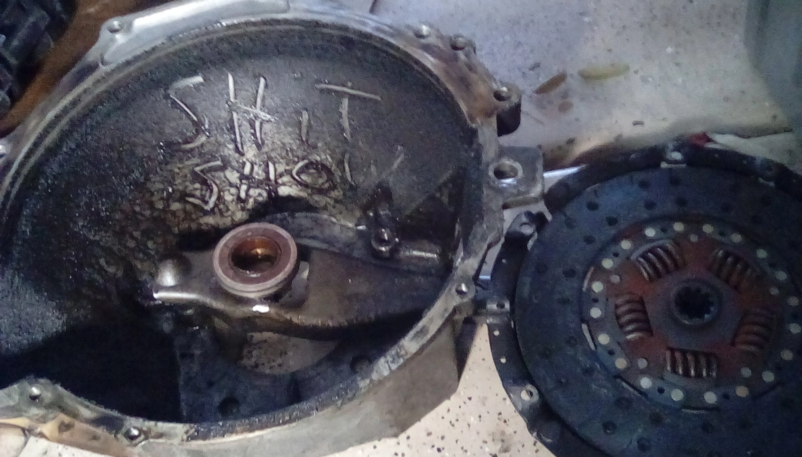

You need to get the skew number off his plumbing device. He will chime in he must of got it at Home Depot. Just for the record. When I changed my clutch I put on a Felpro teflon seal , and the sob leaked right away. Now, besides my clutch slipping and my car smelling with oil on the exhaust. I need to do this sooner, or later.
