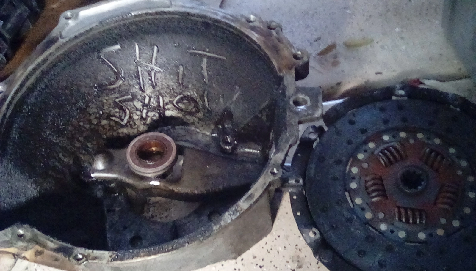

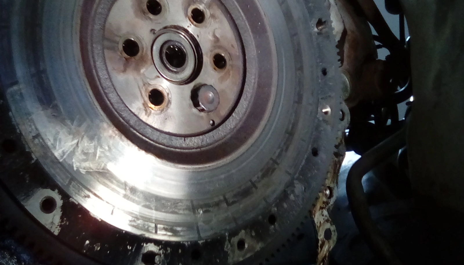

My car is also leaking through the bolt holes. I followed the directions with the new ARP flywheel bolts and used loctite on the threads and the supplied grease on the bolt head to ensure proper torque. :cautious:
It's leaking because those bolts go threw to the crank case where they get soaked with oil. They need thread sealant, ask me how I know.

I know, I saw this thread and went out to look at my car and it's leaking.
