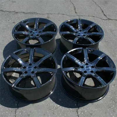

C cwest83 New Member Dec 12, 2008 10 0 0 Jul 13, 2009 #1 Jul 13, 2009 #1 I am planning on buying these rims in a couple days its 10 in the back and 9 in the front... What would be the best size tire to put on my car if I use the Ford suspension package. So as not to rub etc. The package lowers it by 1.5"
wusthof Member Nov 19, 2007 192 1 18 BC, Canada Jul 13, 2009 #2 Jul 13, 2009 #2 use the search function - safely........255s front, 275s out back - probably even 285 or 295's
allcarfan The Answer Man Founding Member Apr 8, 2001 2,458 1 56 North Atlanta Jul 18, 2009 #3 Jul 18, 2009 #3 I just purchased those same wheels.... running 255/35 in the front and 285/30s in the rear.
