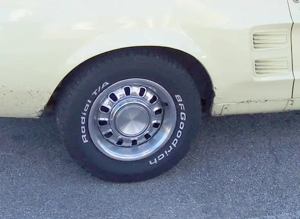

Answer is YES.....didnt think they would fit but they do. Heres my rundow:
67 coupe
shelby drop, 1 inch front drop springs
stock (worn out) rear leafs
front fenders lip trimmed
15x7 ss rims
mastercraft tires
225/50-15s front
265/50-15s rear
didnt have a chance to get pictures today, but will friday. They are BIG, but no taller than my old rears.
Old:
new (I will get better pictures when its not pouring)
:D

how much room do you have between your tire and spring? Have you taken them off again to see if there is any rubbing issues with your inner fender. They are a small tire for the rear, as for the front I'm not sure.

No rubbing so far, but i have not driven them much. I am still debating going back and swapping some stuff around.
