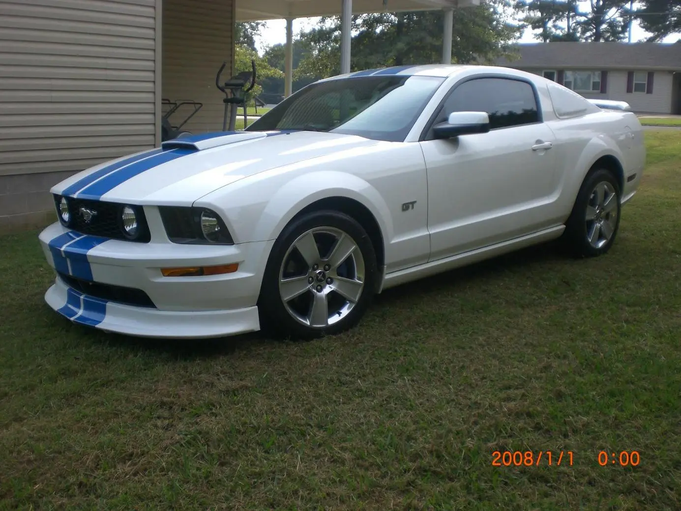

I'm going to get my car lowered today using eibach pro kit and I need to know what tire size I should go with my new rims. I'm getting the 18" Black Magnum wheel, you guys think they will look good on my ride? I'm thinking Nitto drag radials 305/40/18 rear and 275/40/18 front, Suggestions?
