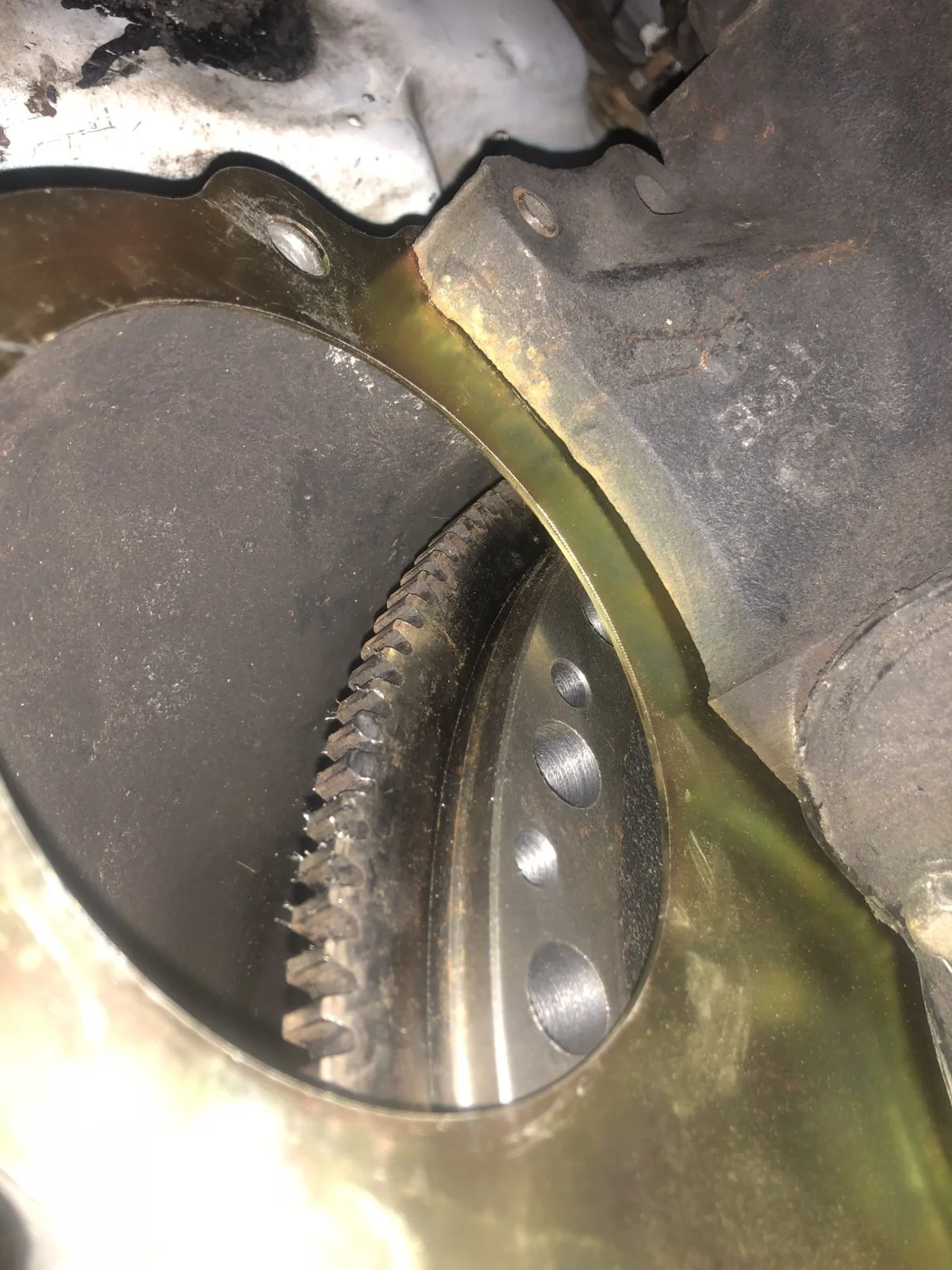

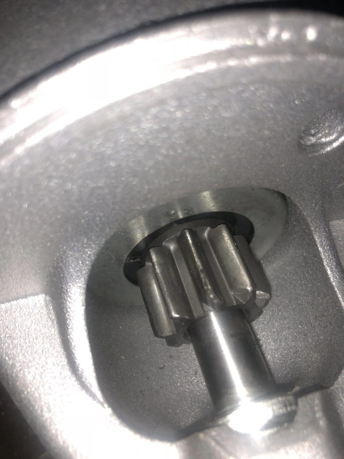

I bought an lmr HDX Ram kit with the clutch pressure plate and flywheel. Recently put it all together and I bought a (stock starter) from oriellys. It’s making a horrible grinding sound upon startup like it’s hitting the flywheel or not catching all the way. The motor spins over by hand fine. Any ideas guys?

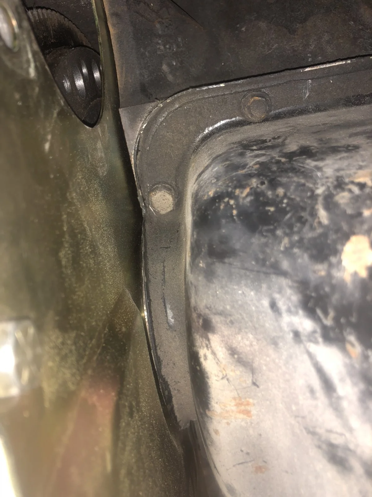

1990 Gt stock 302 I noticed there’s a gap between the bellhousing and motor? Is there supposed to be an 1/8 gap or no? Here’s some pictures of what’s going on. You can see the flywheel 2 teeth are worn out..
