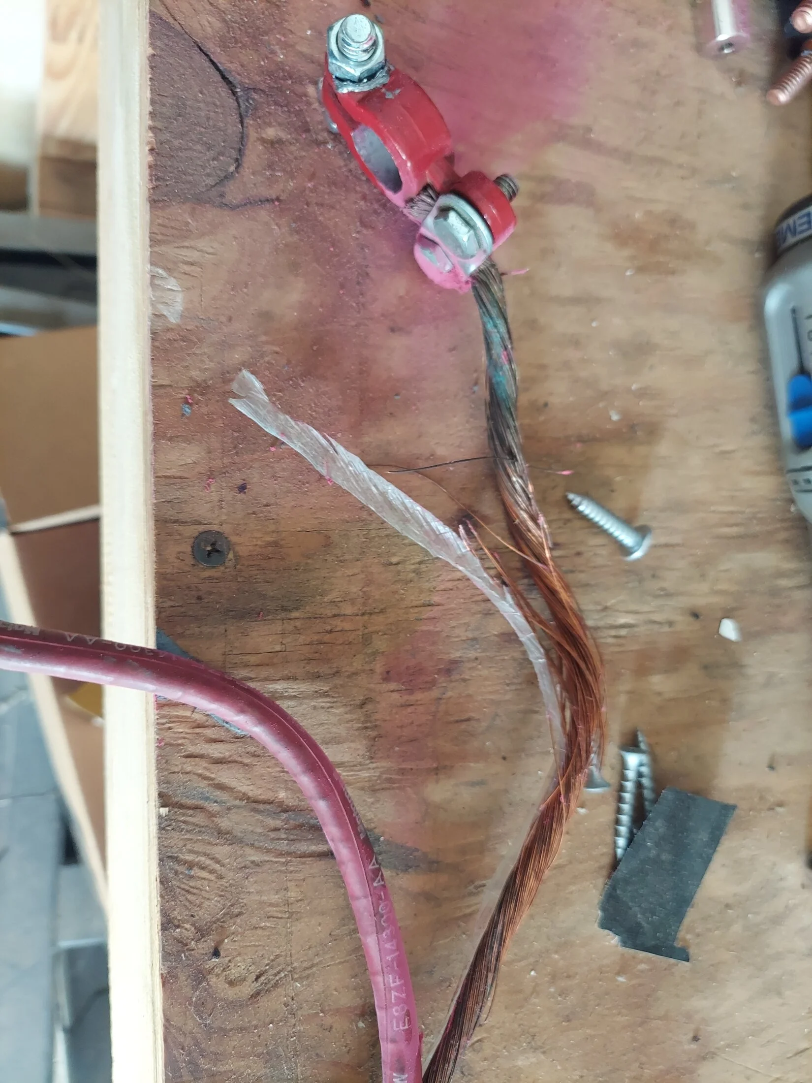

Humbly, I return to you fine folks which will give this problem a resolution. It would have been better if my car didn't start after replacing my solenoid, all it did was confuse me more than I needed.
Anyways, I left my keys in the acc position and decided to just start tapping random things and sure enough tapping on the positive terminal closed the circuit and returned power.
Switched it out and now it works of course.
Uploading a picture of the interior of the battery cable.
Thanks for everyone's interest, input, and patience. Great advice in these forums.

The condition of that wire tells me there has been a connection problem for a while.
Also that type of battery connection needs periodic cleaning and tightening, better to have a cable, in a larger size, with a battery connection swedged (is that the correct word?) to the cable.
Just say'n :shrug:

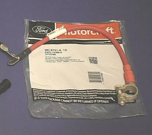

And its junk.... Hardware on mine rusted solid in less then a year lol
Wow, that's disappointing. Would've hoped for better than that from a Ford part.

The worst battery connectors made......
