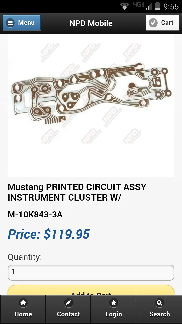

There's a place that sells reproduction printed circuits for pre 87 mustang gauge clusters. Might have been NPD or ...this may be better.
They don't make them for 87 to 93...smh
he could also use silver paste for $2 and fix it

Or solder a small jumper wire across the posts where the break is.

Update, I pulled the gages last night and the printed circuit seems ok. The circuits to the amp meter are melted, which was new to me. Not really important. Have not had the gages out in four or five years. Pita to remove.
Anyway the tach seems to have died, so I swapped in the Sunpro from the Chevelle and it seems to work. I did take out my Proform shift light, but maybe it and a plain tach would work.
