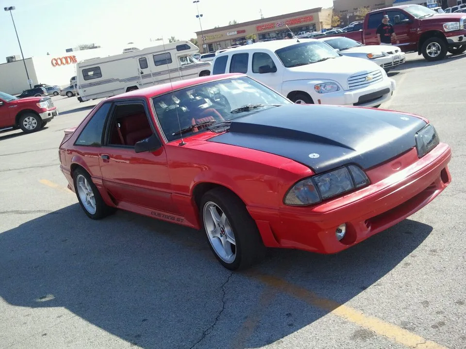

New to foxbodys. 89 GT. some mods, looking for mod suggestions to build off current
83Zombie
Oct 17, 2011
14
missouri
hello, just got my first mustang and had to go w the foxbody, im new to this car and V8's, used to be a Evo guy. the car has a decent amount of mods, looking for some tips on how to move foward..N/A for now. heres what i have
trickflow heads
cold air intake
1.7 rockers
cam( but the kid didnt know what model)
bbk headers
Y-pipe
flowmaster to the back
msd ignition w blaster coil /wires etc..
king cobra clutch
intake is stock and ive been around guys enough to hear of the Gt-40/trick flow/ or running a Cobra intake. whats the benifits of each.
thnx

Nice GT.. One of the things that I am doing is upgrading the Radiator mine blew out this weekend going with 3 core , 3G alternator with electric fan , I have the Trick flow intake setup on mine and the torque is much better than stock dont know much about the Cobra intake.
thanks i had already heard to look into the raidator+fan bid. what fan did you go with also my Rpms are sticking sometimes when i shift and not dropping and sometimes at idle when i rev. someone suggested to replace my IAC and throttle postion sensor

Intake should be your next mod in my opinion. First determine your needs: are you racing at the track or just toolin around town in your daily driver. TF Streetburner intake will give you more low end torque and TF trackheat will give you more on the higher rpms. Gear ratio and cam play a role also in torque so learn which gears and cam you have inside before making your final decision. Then get whatever supercharger your motor can handle.:D
It sounds like u need a new throttle body. I had the same problems with my 88 gt when i first bought it. RPMs not dropping between shifts. Also i was not getting enough power when i floored it. I could not even break loose in first from a rolling start. I tried cleaning up the throttle body a couple times and it didnt do anything. So I bought a new one and now im sidewayz again. Plus my rpms drop perfectly now. But i know the rpm thing is going to be the tb butterfly valve is not closing all the way. Good luck.

i have another daily driver so my plans w this car is to track it.but keep it enjoyable to drive around when all the friends cars go joyride i figured intake would be my needed upgrade the most, i gota get the idle surge under control, going through the checklist this weekend.
any easy way to find out what cam i have, theres def one in there , but the kid bought it from, he bought it modded as well, so guess i might have to just wait til i put the intake on idk

When you say you want to "track it", you mean drag racing? If so, you've got a good start. It needs an intake manifold, and I'd recommend trick flow. As for the hanging revs, you can remove the iac motor and clean out the valve with carb cleaner. If it's clogged, that will help.
