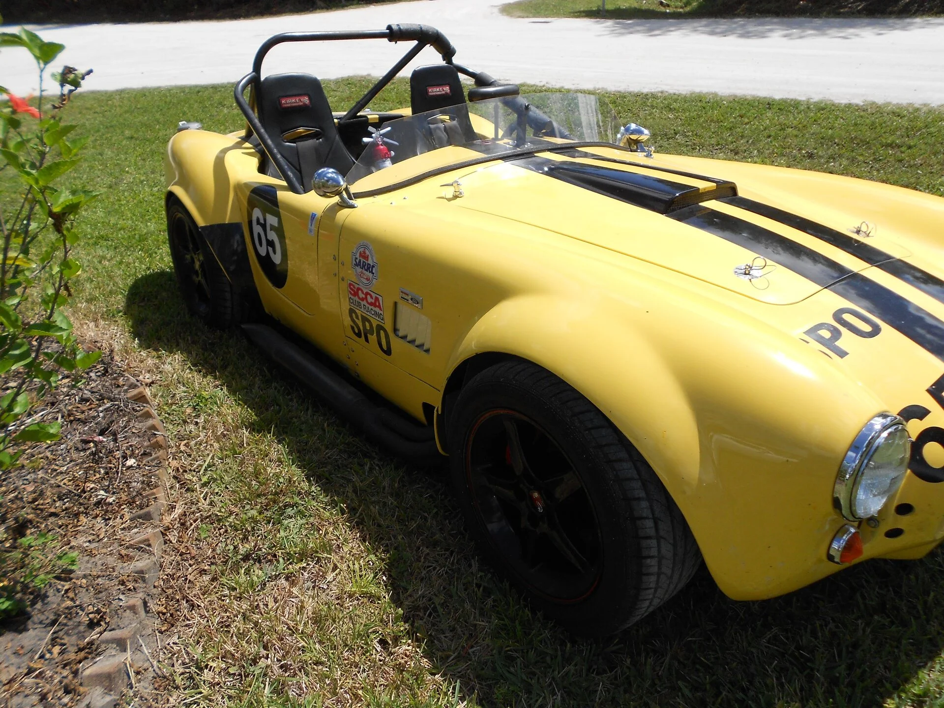

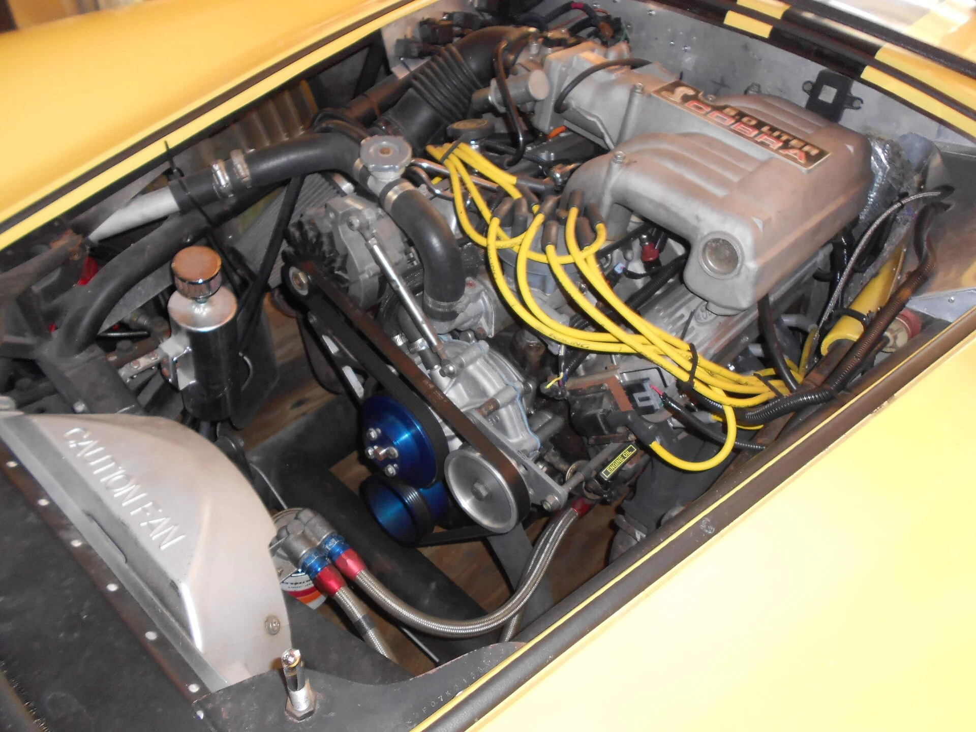

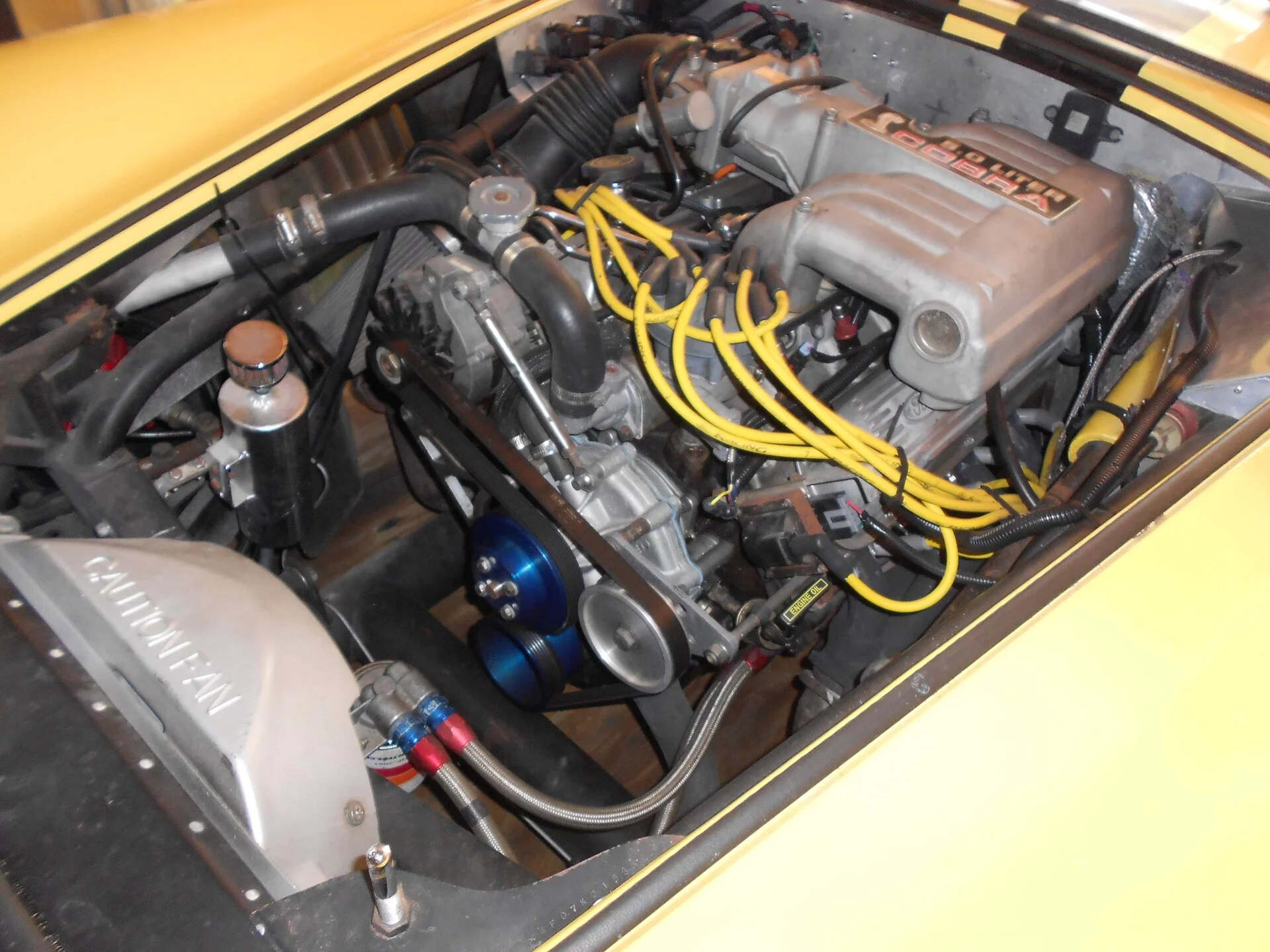

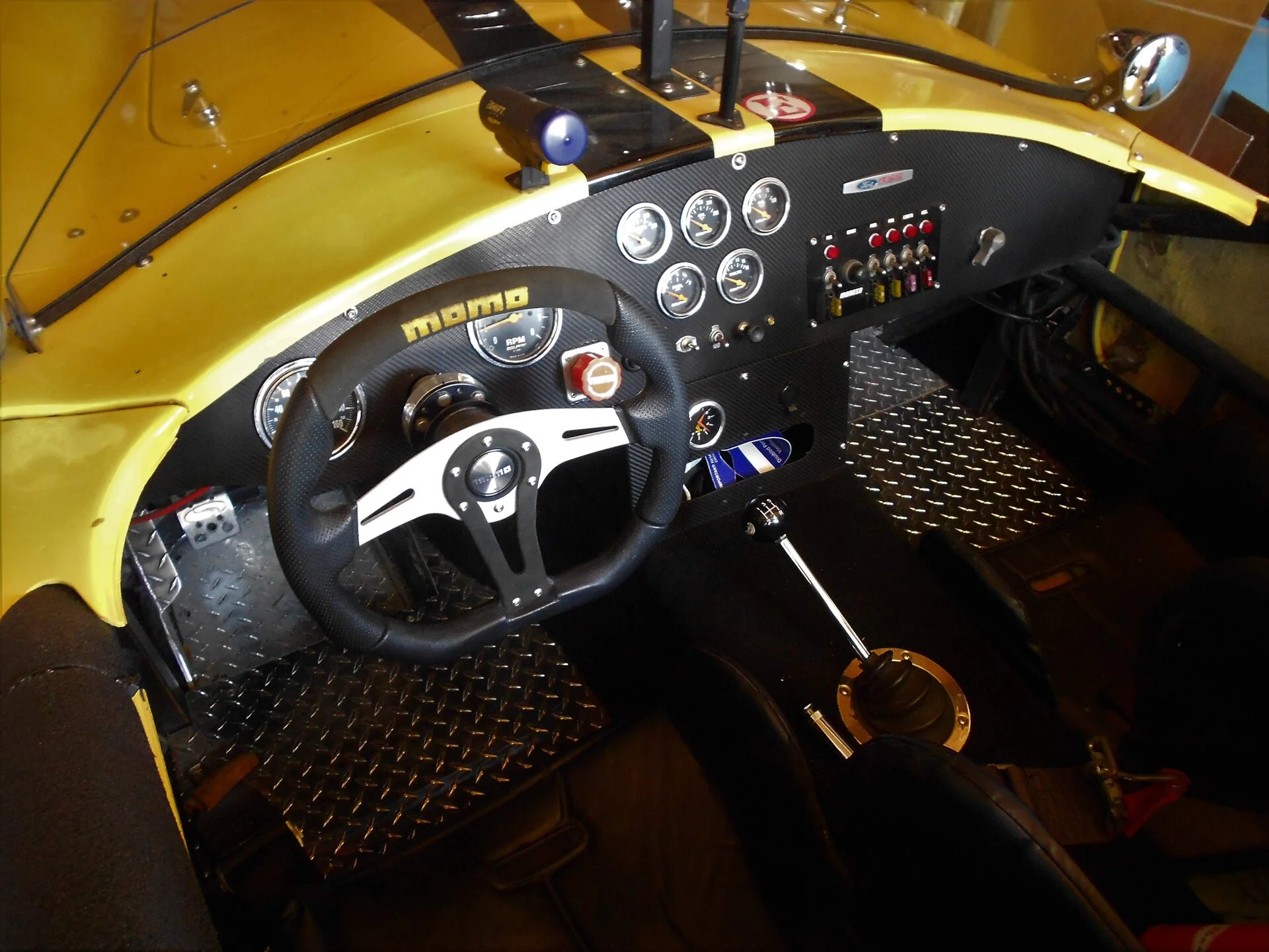

Sorry guys . not realiy good at using the forum , a little background, spent 10 years building a ffr scca car, ford racing motor, cobra injection absolutly picked up on eec, the fox body is converted Din't think its wired correct, seems like I don't have time like I did when I was working ,I thanks for the help,
