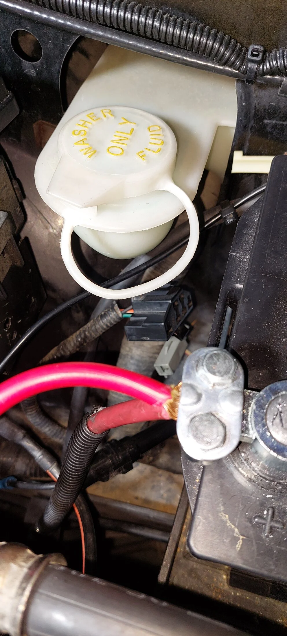

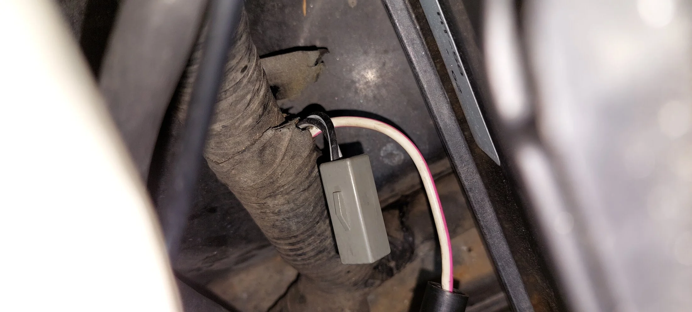

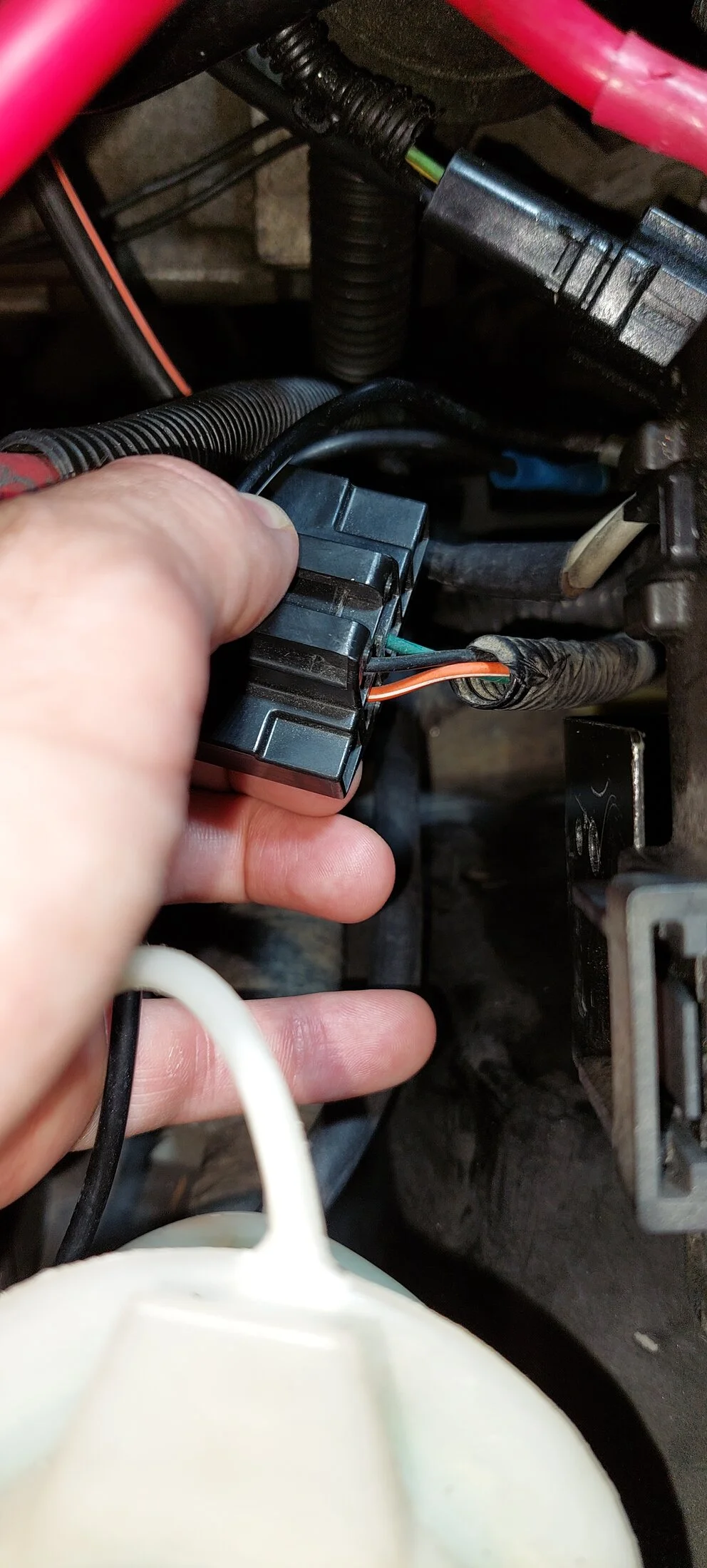

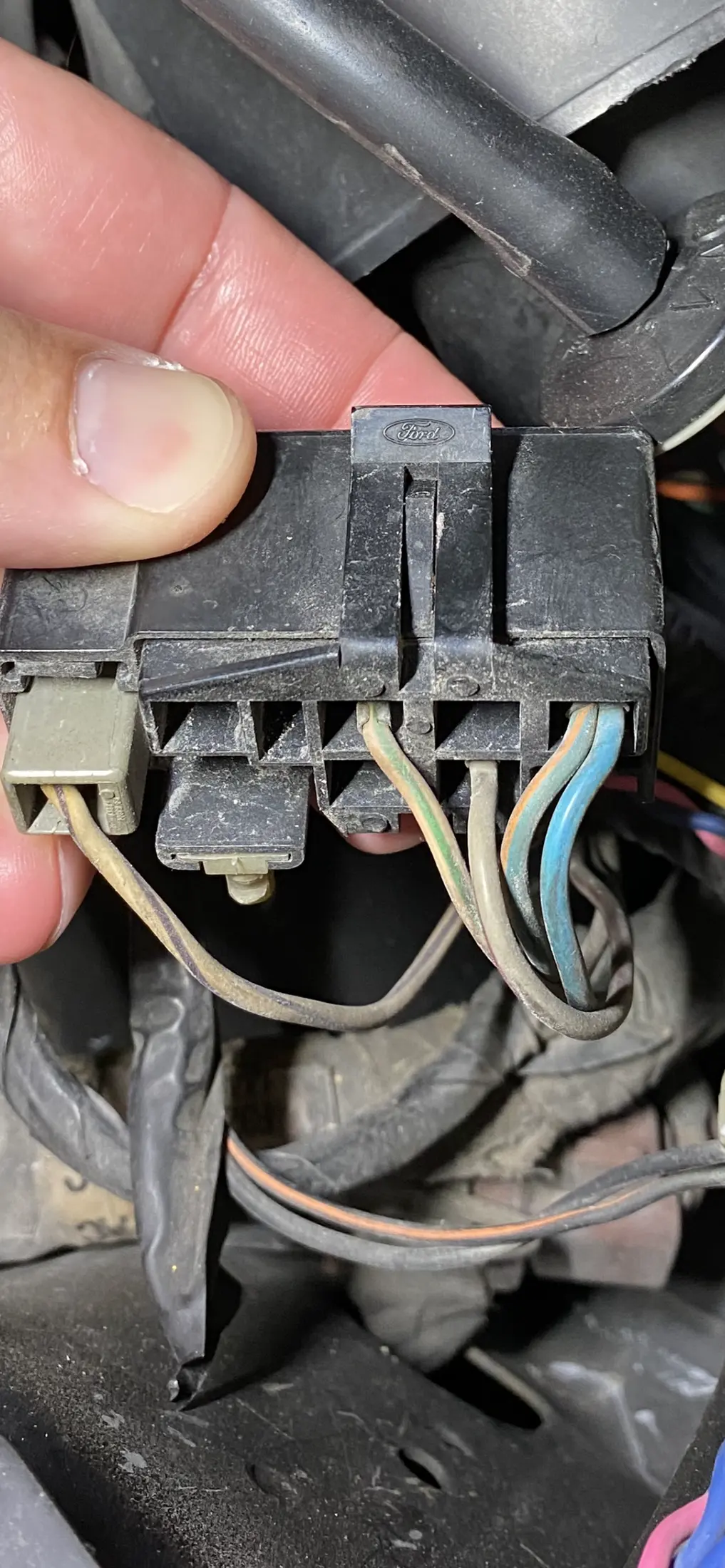

So it turns out the OBD1 Connection port has not been capped off. I found it on the driver's side between the battery and the fuse box, under the windshield washer fill. But it doesn't match the wiring diagram that was linked above.
-There are only 3 wires going into the OBD1 connector: green, black, and orange with white stripe. Both green and o/w have 12 volts.
-The self test connector has 2 wires, both black with white stripe.
I was not able to make anything work pulling codes. If anyone can offer some advice or suggestions on next steps, I would really appreciate it.

Other thing is I thought your test port was behind the passenger side strut tower. Makes me wonder if someone extended the wires.
Correct. According to everything I read, it should be behind the passenger side strut. So the wiring is definitely not the same as stock. So I'm really not sure where to go from here.
That’s the same number of wires my 93 has albeit different colors.
Huh?.... to me, his doesn't look anything like yours. Agree with the different colors, but I'm seeing a different number of wires. Yours has 4 wires, plus the 5th in the grey connector.... his only has 3 wires total. And the connector is a different shape. Going from memory, but I think his looks like the diagnostic connector that is on my 85, which is under my brake booster. His appears to be on the driver's side also, albeit more towards the front of the car. :shrug:

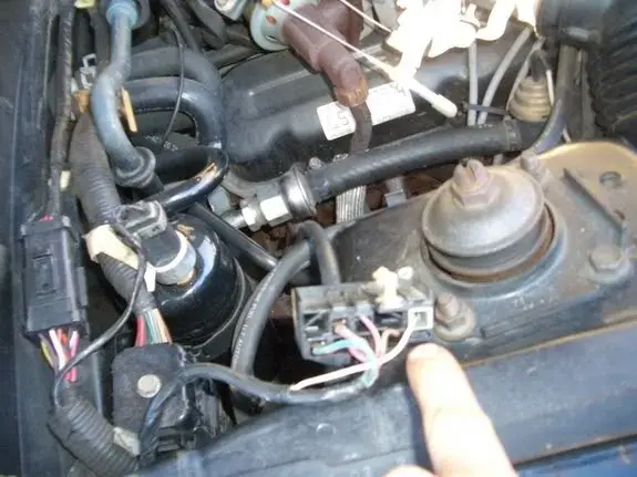

I should have been more clear in stating that only three ports are being used which is like mine. I still think someone moved it and just extended the wires but I don't think they did it correctly. This is a picture of one in a 94/95 car and it has more wires:
I would start digging around over on that side of the car and see if you can find the wires over there. Can you find your self-test input port (single gray connector) over at the battery with the self-test connector (triangular black connector)?
