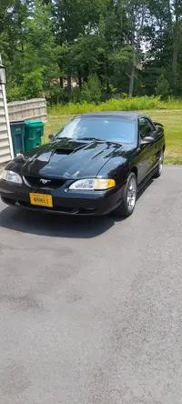

I just bought my first Mustang, a 1995 GT (convertible). I live in Central VA. I'm 42 years old and decided to buy the car that came out when I was in high school and really wanted one at the time. So I figured it was finally time to get a toy. I also have a Honda VTX 1300, but with 2 young kids, the motorcycle just doesn't get ridden very often. I'm used to working on the motorcycle, but it is carbureted and has very simple electronics. So working on a "modern" fuel injected vehicle is a little intimidating. I'm having some electrical issues, which I will start a thread on.
A few notes on the car:
  • The interior, paint, body, and frame are in great shape.
  • It has some mechanical issues from sitting for a long time.
  • I put on a new fuel tank, fuel pump, and fuel filter.
  • I'm upgrading the front brakes to the Cobra brakes.
  • The car needs a new top. The current top is the original and is now 28 years old. If you know of a good place in Central VA that can replace the top, let me know. (don't want to do that job myself)
  • The steering also has a lot of play in it, so I'm looking for someone who can diagnose and fix that as well. (I don't want to do this job myself either)
I've learned a lot reading on this site, so I figured I might as well join! Thanks for having me.

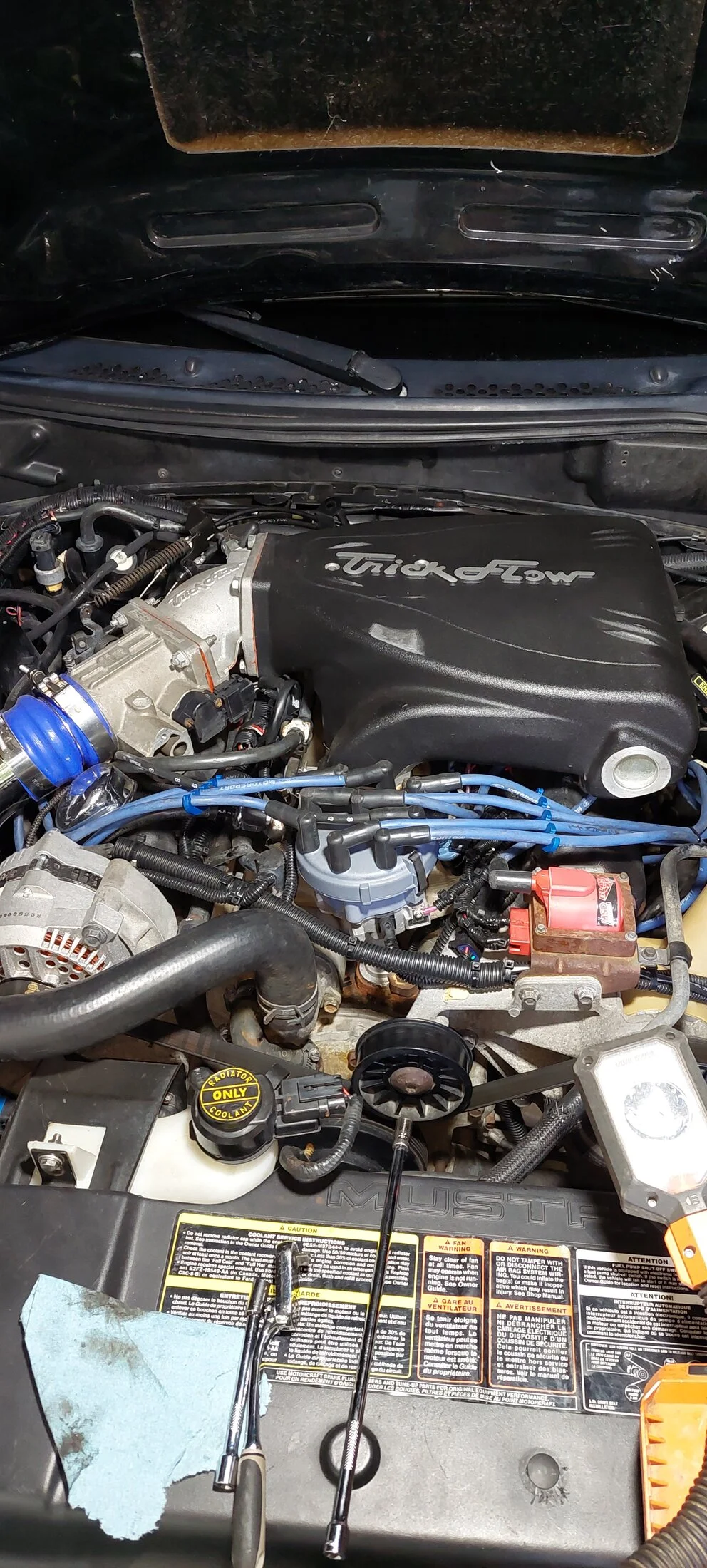

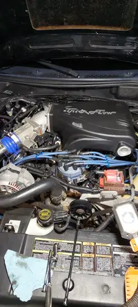

Here is a pic of the engine bay. I would guess aluminum, because of the intake and rockers. Also has BBK 65mm throttle body.

This in now way is contributing to your fuel pump issue but thought I would mention it. Just saw the engine bay picture and the one thing that I saw immediately was the breather style oil fill cap on the valve cover. This is not a good thing at all as it will allow air to enter the motor that is unmetered by the MAF. The tube that used to connect the stock filler neck to the throttle body appears to have been removed from the throttle body and filled with epoxy or most likely JB Weld.
I learned this the hard way on my car and fixed it which brought my idle back to controllable. I had the breather style oil fill cap on mine due to the Motorsport tall aluminum valve covers which do not have the connection for the line from the filler neck to the throttle body. To fix it I ordered a Trick Flow filler neck and cap:

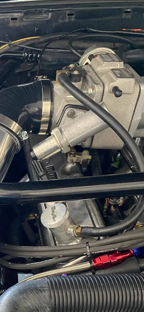

Then ordered an aluminum 1/4" NPT bung and got a brass 1/4" NPT host barb. Had the filler neck welded to the valve cover and the bung welded to the filler neck (drilled the hole first). Here is a picture of it:
Thanks for the tip! What you don't see is that there is a second breather on the same cylinder bank, but closer to the cabin, so its not visible in the pic. They had one for the oil fill and another just as a dedicated breather.
