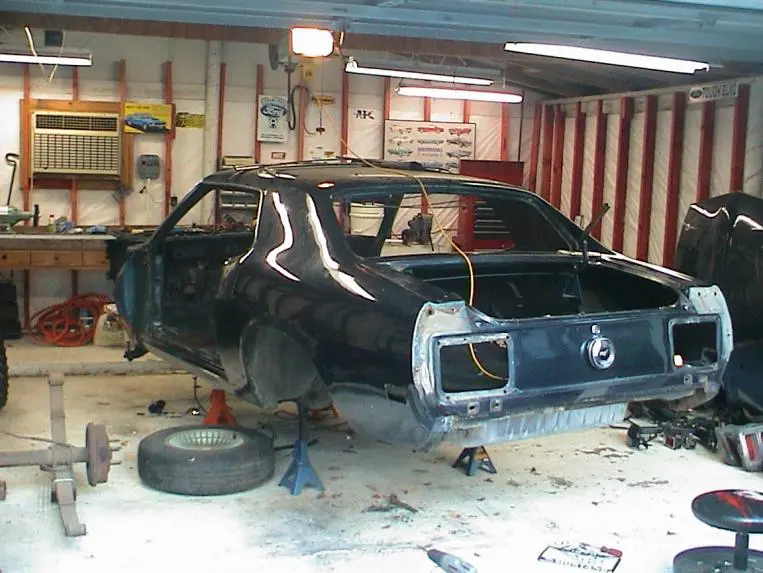

I have a 1970 mustang coupe that i have had for 17 yrs. (my first car) I am doing a restomod (pro touring) restoration, I have it dissasembled now and have bought the heidits superride ll kit for the front which i am going to put air ride technologies bags on, I was wanting ideas for the rear suspension , I am thinking a four link kit like the heidts kit and putting air ride on it as well with maybe a mini tub and deep offset wheel??
It was a automatic i will be changing to a 5 or 6 speed with a fuel injected motor maybe a 408 stroker or 427
If anyone has any suggestions or comments id like to hear them all now before i start buying parts,, thanks guys
