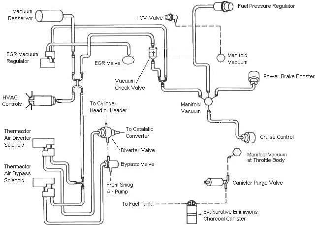

The actual smog pump only has one connection to it, a hose which runs along the side of the passenger side(close to the A/C lines) and connects to a valve, then down to the connection to the H-pipe.

Oh yeah, do you have any of the A.I.R. (smog) plumbing in place still?

Wow, thanks for all the replys! As far as the plumbing goes, no plumbing left, smog pump eliminator bracket that was installed. There are some things done to the car that i am not so sure about. I used to have a Lightning that made 635rwhp/760rwtq on the bottle, and this car has me more confused than that thing! There are no lines for the smog pump anywhere. I think i can get through emissions from a "friend." I made a typo, not a 140 t-stat, its a 160*, but the car still wont warm up past 140*, it has an aftermarket radiator in it. As far as details, there are 24# injectors and the guy supposedly has a mass air calibrated for them, but i find that doubtful. The motor is a 306 w/ TFS twisted wedge heads Ported/polished 3 angle valve job, E303 cam, Edelbrock performer intake. It had FMS 1.6 roller rockers, but i have a stud mount conversion with guideplates and TFS 1.6 roller rockers, TFS Hardened Chromemoly Pushrods, 180* t-stat, intrax 2" lowering springs (previous owner has it dropped so low you cant even get a jack under the car). The previous owner said the car was tuned by Laroccas performance, and he said that the car made good power on the richer side, but i checked the plugs and they were sooted up pretty good, i think some of them were even fouled, and i dont think that he ever gapped them correctly. I understand Laroccas is a reputable shop and that they wouldnt have tuned the car to be THAT rich, knowing that would cause problems down the road, so that is what makes me think that the MAF isnt right, and that the thermostat is way too cold. I had a pro-M meter on the lightning and if i remember right, the actual meter had Pro-M written on it, right? This one looks just like a stock ford MAF. All else aside the car with the mods listed above went 12.44@112 at cecil county, and i feel that there is still more power to be made. Sorry for the drawn out explanation, but i really do appreciate everyone's reply's! Thanks!

See the following website for some help from Tmoss (diagram designer) & Stang&2Birds (website host) for help on 88-95 wiring http://www.veryuseful.com/mustang/tech/engine
