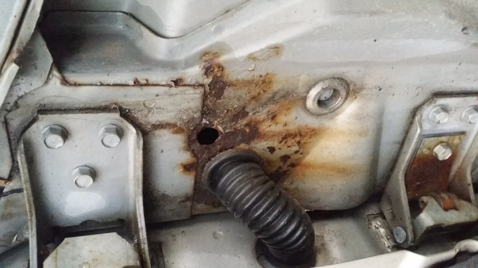

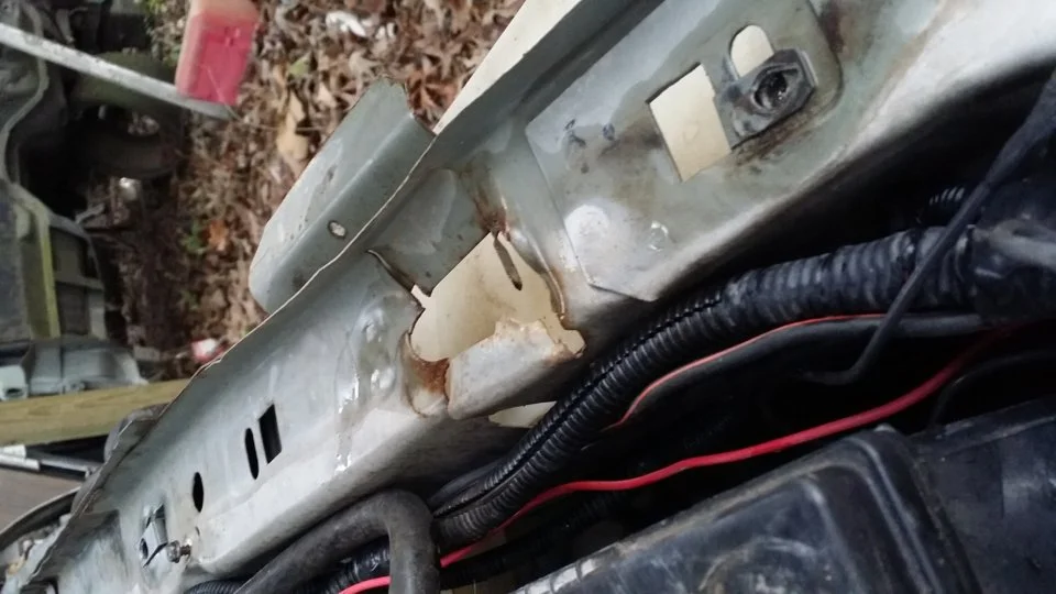

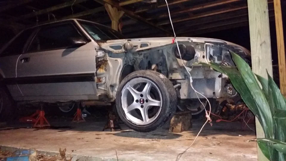

Well I stand corrected. I guess I opened my mouth too soon. I pulled the fenders and bumper and found more damage than expected and yes, some rust. It's not bad but it's around the hinge and centered where the antenna wire goes in the pillar. Its just surface rust so I'm going to clean it up and ospho it. I'll probably cut a piece out and weld in a replacement to eliminate the antenna hole. I will be cleaning the cowl out and giving everything a good coat of ospho and paint. The core support was apparently ran up onto a curb or something bc it's beat to hell and raised up. The radiator hold downs are at about a 45* angle. I'm gonna hammer that down with a square drift and get it pretty close and coat it with ospho as well. The bumper bumper was damaged on the drivers side passed the mount so I'm gonna beat it back out decent and now that the fenders are off I'm seriously contemplating cleaning up the fender wells and filling some holes. Has anyone else made a new inner fender or a shroud for the air cleaner. I was thinking of leaving the inner fender out and making a shroud to keep water out of the air cleaner. I won't be able to drive this car very hard in the rain with lockers and 3.73 gears so I figured it would be fine. Any advice or opinions on this?
The air cleaner in the fender well is the stock location so you shouldn't need to fab up a cover for it so long as you have the fender splash guard/liner installed. I smoothed and tucked my engine bay you can check out my build thread for tips if you want. Also some people cut out the lower mangled radiator support and and weld in square stock in place of the old.
Well I was curious about deleting the splash shield because I want to roll the fenders and I would like the room for several reasons. Idk how other people go about it. I knew that ad the factory location but I thought the factory box held the cleaner on the inside but got its air from the outside. I couldn't remember. Either way it's still pretty nasty as it is and I would hate to make it worse. I like the square tubing idea. I'll have to kick that around tomorrow. I have lots of different sizes and thicknesses laying around. I read your build thread to about page 25 and said f&$% that! Lmao it's a good look but I like to keep mine drivable and the more I thought about it I don't like the idea of the components being more exposed to the elements. As it is I'm looking at trying to stuff what I can and just cleaning it up a lil bit. I just hate that bis mass of wires and I don't like the idea of all of it being around the solenoid. I'll shoot some pics and give yall a better report tomorrow night. May just go ahead with the lower core support. Seems like a lot better fix than just beating it out. It won't be seen but I like to make things better than before and fix problems where I can

Idk why it's sideways but that's the hole in the a pillar on the passenger side where the antenna goes thru. Should I cut it out and replace it with some 18ga or just clean it up and fill the hole and stop the rust?

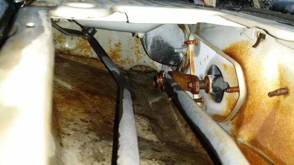

I'm wanting to pull the cowl and do some rust prevention. Has anyone made theirs removable? I was just thinking about making it easier to clean out and thinking of hiding a few things in it.
What's the deal with this? It's the same on both sides. I plan on just welding it up but is there a cause and upgrade anyone knows about or is it just a result of the front end damage bc I don't see how it could be related?
