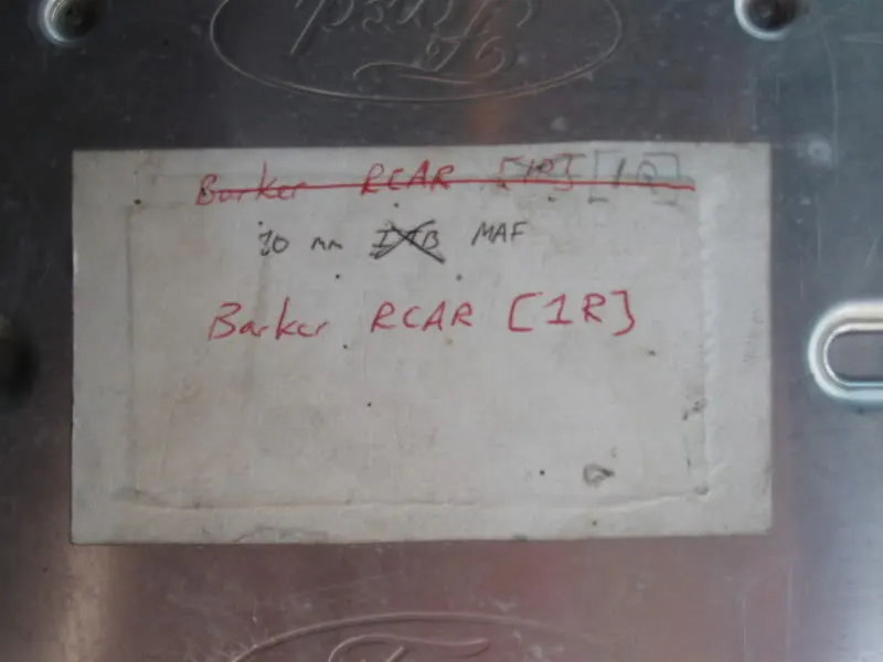

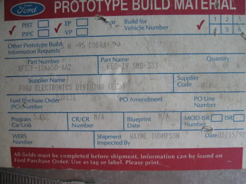

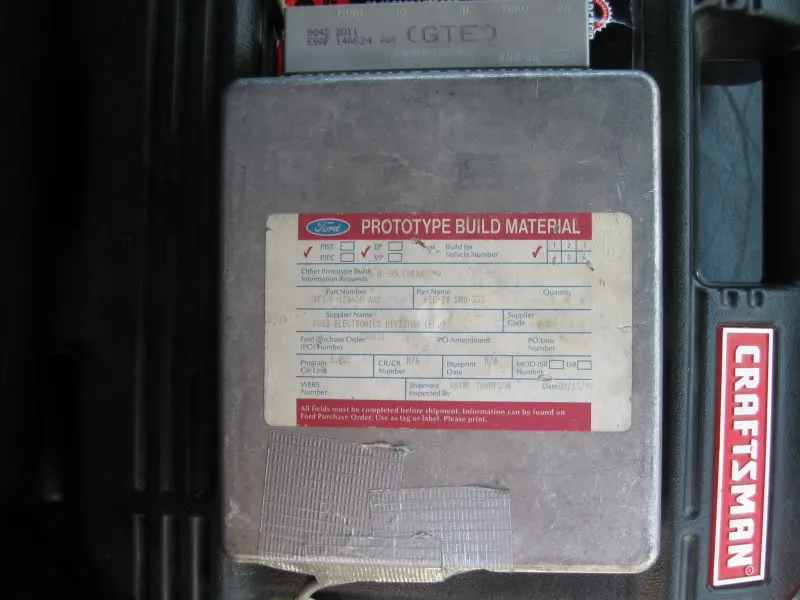

The ECU is custom programed. The tuner did not have a specific code to use when tuning the ECU.
I dont know if code 113 was there on the dyno b/c I did not have the code scanner at that time. The CEL was first being thrown due to the IAT sensor which was broken and not staying connected but I since replaced it w/ a new ford unit but now its throwing the 113 code and 998 while running.
I also have a spare ECU out of a 95 Cobra

I think you have good parts. I think your car should be putting down more then it is, although I don't know what you wanted from Ed regarding the camshaft. And that is certainly between you and Ed. I would suspect though that you'd indeed be making Paul type numbers.
Just for piece of mind, I'd install a normal ECU and have a chip done for it... somewhere else.

THe issue is not w/ the tuner, pete does really good work. The thing is I have no idea what the programing is for that ECU and how well it accepts mods or chips. When I have time this week Im going to put the other ECU in w/ the chip that I have and scan for codes again and see what happens.

There are 3 basic computers for our cars, but only one for the 5 speed. If your car came with a 5 speed, then he didn't need to ask which computer you had.
Kurt
When tuning for the chip the software needs to know what the code is for the computer, cant just write in 94/95 cobra w/ a 5 spd. The ECU in it now had no code assigned to it.
What are the 3 computers, 94/95 GT Auto and 5 spd and the 5 spd cobra?

There are 3 different 5 speed computers. One for the GT and one for the cobra. I do believe that cobra R's also had there own computers that were completely different than anything else.
Venom didn't your car have alot of prototype parts on it. I'm betting since roush done the tune on the cobra's. Your car may have had a prototype cobra r computer in it judging by the pics.
Wrong.
Its all the same computer for 5 speeds and autos. It depends on the what "catch code" or tune you start with.
What matters is the tune in the computer's memory. The GT used a T4M0 tune, which was the A/F curve for a GT running 19 pound injectors. The Cobra used a J4J1 tune, which was the A/F curve for the cobra's better-breathing HCI and 24 pound injectors. The U4PO tune is a GT tune, but for an automatic with all of the slush box parameters in there.
I could have loaded the U4PO tune into my computer from 5 speed GT, slipped it into an automatic GT, and it would have run and shifted like stock.
When you run a TwEECer for the SN95, you have the ability to load the "base" of the above three tunes into your laptop and further modify them from there. 99% of people load the Cobra tune and modify, as the Cobra has much more in common with a modified car then the GT.
All three tunes work with the same physical computer.
I don't know Pete or his work, so I have no idea what he used or how he tuned it. It looks like you had a base tune for some prototype Cobra 5.0L. If Pete is as competent as you say then the "tune" that came with that computer has been wiped out, or bypassed, and Pete's tune imposed on the hardware.

Thats what "custom Programed" means that I posted above. Craig Barker programed the computer, its a custom program. hes the Powertrain manager at Roush.

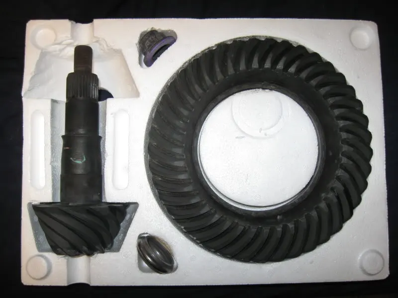

These came today
FRPP 4.10's but not sure when I can get them put in. My ranger has a problem and not sure what it is or how much it will be to fix it.
