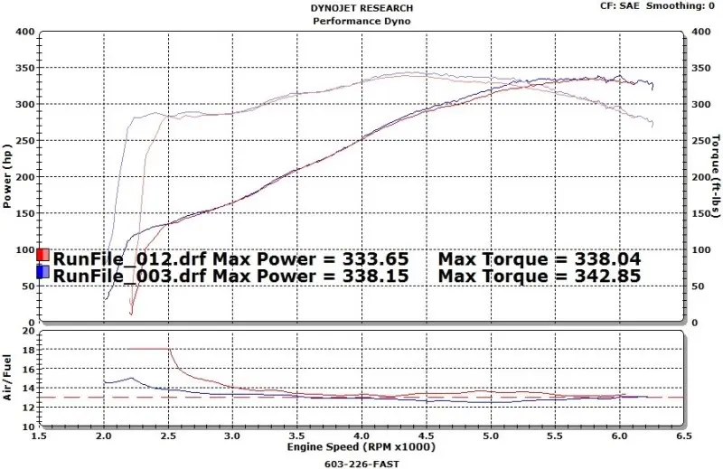

Based on your graph:
You need to shift it higher. I'd start at 6400 and go from there. Try 6200 and then 6600 and see where the incremental go. Based on your tach comment here are some things I would do:
-Forget the tach and shift it where it feels right on one pass. As soon as you start to feel the car fall off shift it. You will be over shifting it at this point but it may show some gains. Again, look at the incremental, 60', 330', 1/8th ET and MPH, 1000', and 1/4 ET and MPH.
-What is your rev limiter set at? If you can change its settings, set it at 6500 and run each gear to the limiter, as soon as you touch it shift it as fast as you can.
Assuming you have a 26" tall tire, you are only at around 5200 with a 106mph trap speed. That will leave a LOT of time and ET on the table. Here's a good table to look at to judge your RPM based on trap speed.
http://www.mustangworks.com/cgi-bin/analyzer.cgi
If you want times that are indicative of what that combo is capable of, you need more gear plain and simple. Shifting it higher might help mask some of the lack of gear problems as they should help increase the trap speed in and of themselves.
