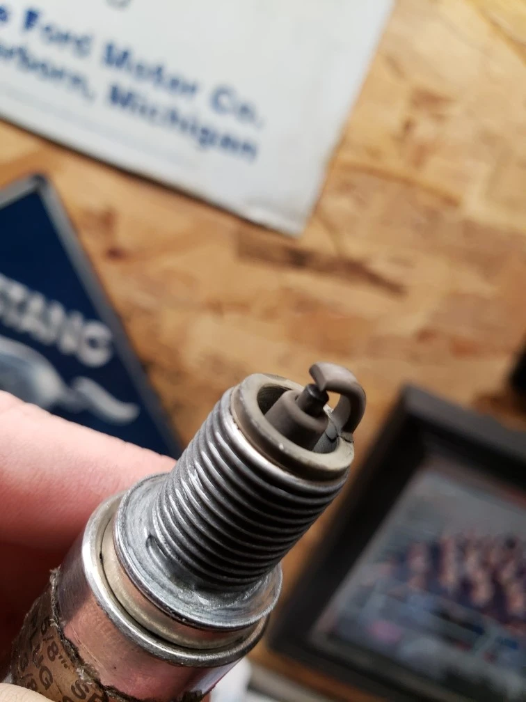

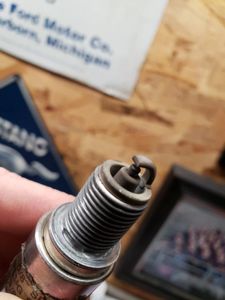

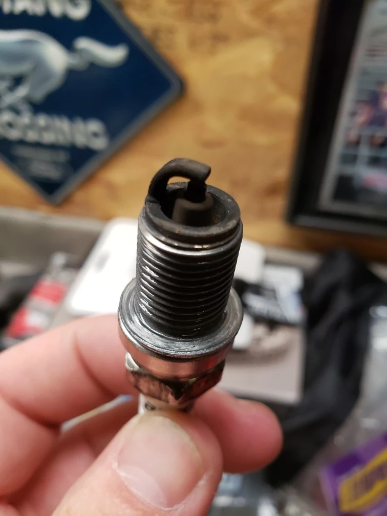

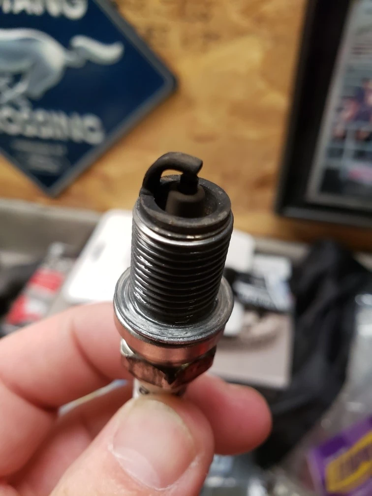

+1 here, I need pictures of the plugs to say more about the tune, what fuel is used? And wot timing.
The x303 cam has way too much overlap for a turbo.
Here's a couple of plugs, 5 and 6. Timing is 14 initial, 34 total, pulling 1 degree per lb of boost. Running 114 race fuel.

likely the plug on the right was still firing and burned off the carbon, the plug on the left is either over fueled to the point of fouling [likely with you AFR] or that cylinder is consuming oil. is the black soot powdery or glassy

Why such a big difference in the two. Both pulled after the same run? Granted we idled back to the pits.
Because either you had plugs with mutiple runs on them or your cyl distribution is horrible .
I’ll say it one more time . YOU NEED TO PUT FRESH PLUGS IN . Make a pass and pull them right out. Don’t idle don’t anything . Burn out , run , off and pull them .
You can’t idle back to the pits either idle fueling will mess up the plug surface you need to make a run shut the car completely off coast to return road and swap a plug out.
