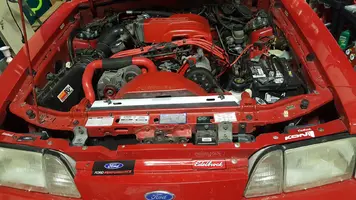

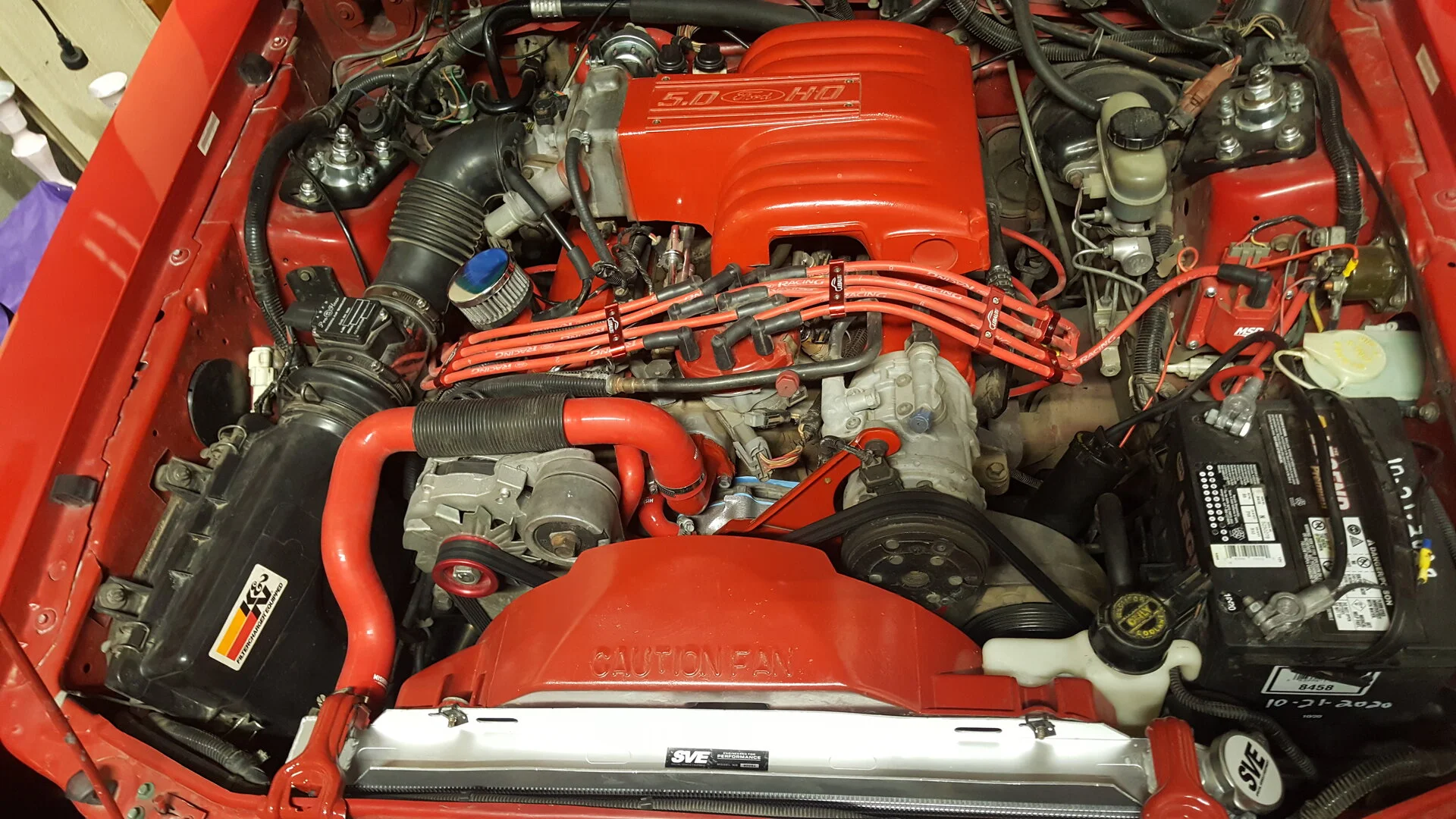

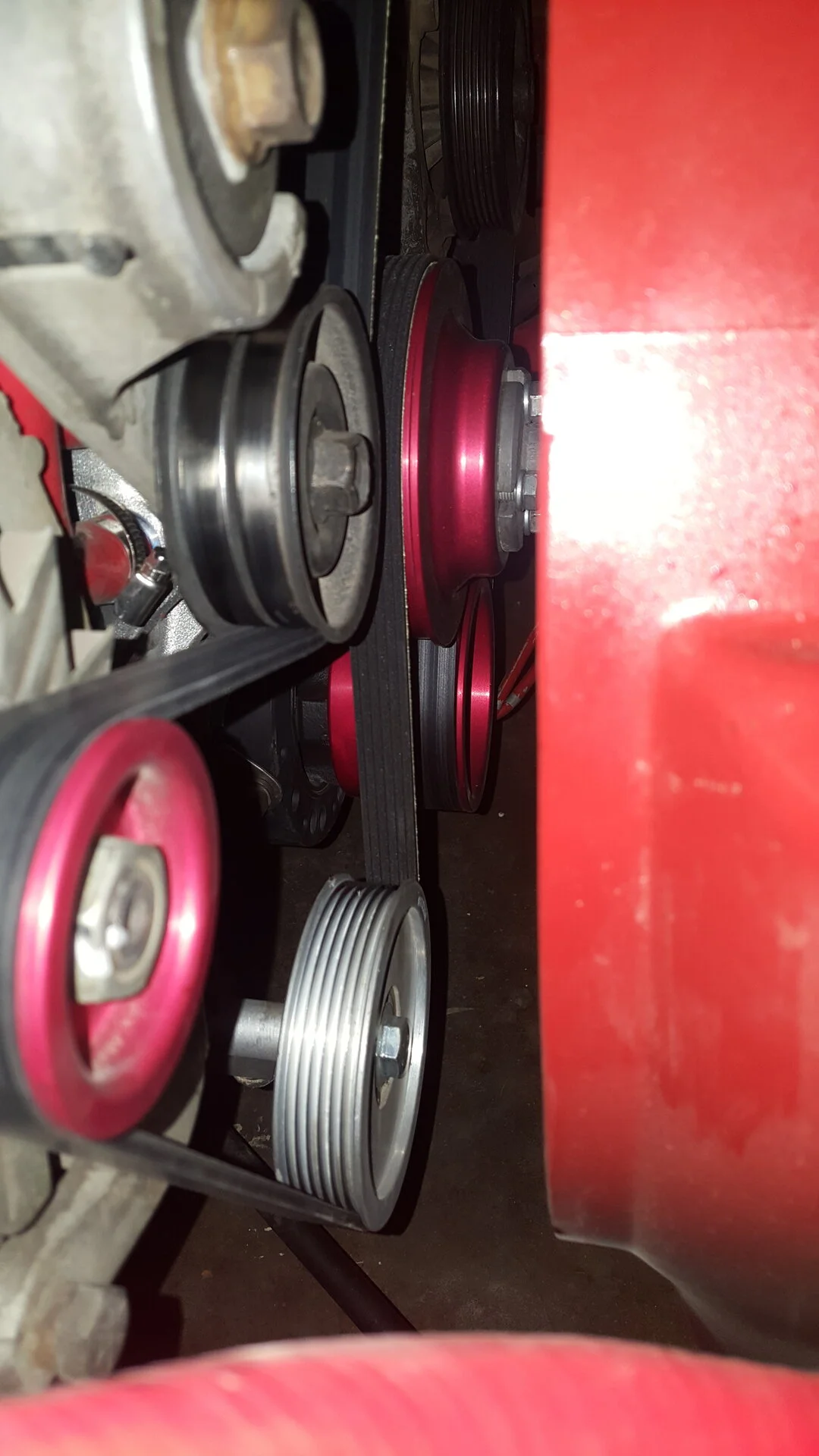

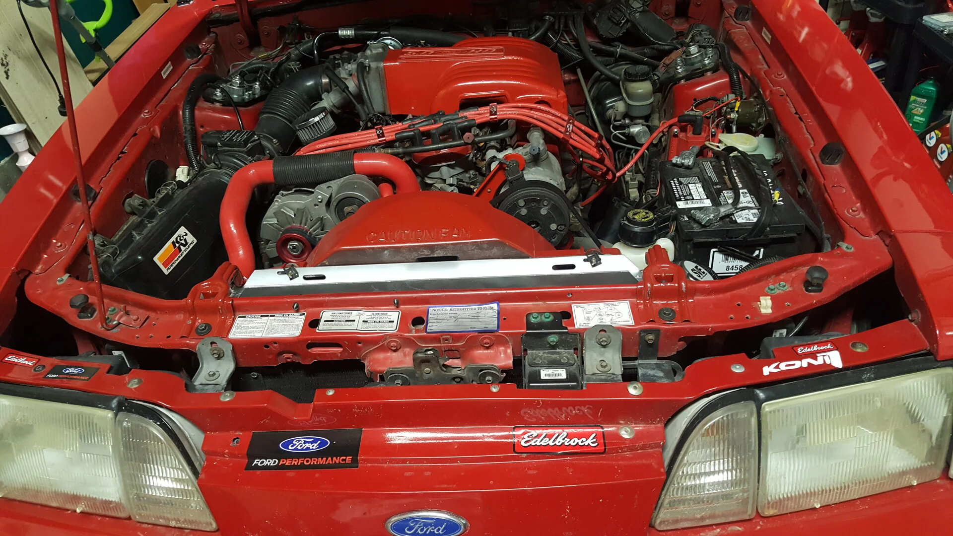

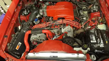

So I just did a major job on the car...I did the Edelbrock high flow water pump, timing chain, harmonic balancer, underdrive pulleys, radiator, hoses, painted the fan shroud and water pump/power steering bracket, thermostat housing. I changed the engine temp sensor and the engine coolant sensor too. No coolant is leaking anywhere that I can see. Now the car is running too hot and I'm wondering if it's the pulleys, engine is basically stock, timing bumped up to 12 degrees. I tried to Burp it once, I'm going to try and burp it again to see if this helps. I was hoping not to have this issue after such major work.

Jack up the front end as high as you can and squeeze the lower hose several times, start it up and continue to squeeze the hose.
Always worked for me.

Use the Lisle funnel kit to try and burp your radiator.
Underdrives can work fine on stock cars if the cooling system is robust. I ran them for 20 years with an E-fan and the car never went about 190*. However, if your radiator is full of crud, it will suffer performance and the pullies will show that.

Is your lower rad hose collapsing because of the high flow water pump?
Are you really overheating or just a bad gauge?
I don't think the lower hose is collapsing...I swapped out the coolant temperature sensor so I thought that would fix the problem of it getting hot before I did this job. I'm also going to add some Royal Purple additive to see if that will help drop the temperature at all.

The radiator is brand new SVE, that's why I'm so puzzled on why it's getting hot. I've changed just about all the cooling components, so I figured I'd be getting lower temps or at least stay mid point but it goes above that...Is there any danger to running it too hot? It doesn't fully overheat but the temp on the gauge climbs up there, above mid point.

Ok, let's get some clarification: you did the hi flo water pump and some other stuff because the stock gauge reads on the high side?

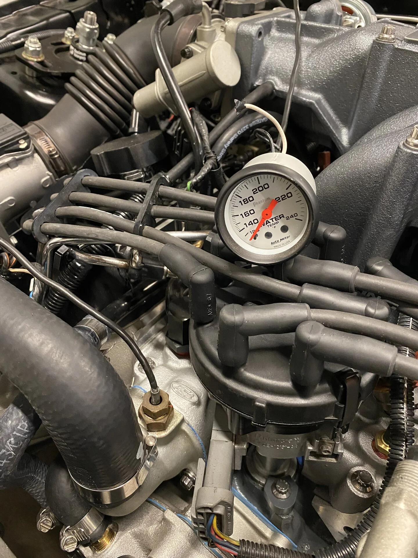

Install an aftermarket gauge then use a hand held infrared temp sensor to tell you temp readings at hoses and top or bottom of the radiator.

I mean if it's too hot I know the dangers, blown gaskets, fried pistons etc...but i mean it's not over heating but it is above normal...that's what I meant and I think I will do a temp sensor to read the temps manually and not rely on the old gauge.
You've got air in it, get the Lisle funnel as mentioned. I've never had one issue with UD pullies. You would've been fine with a parts store water pump.
Yea, I just figured I should do a high flow water pump since I was doing the Underdrive pulleys....plus I got it for a lot cheaper since it was open box with just light scratches. I'm also going to try and properly burp it again.

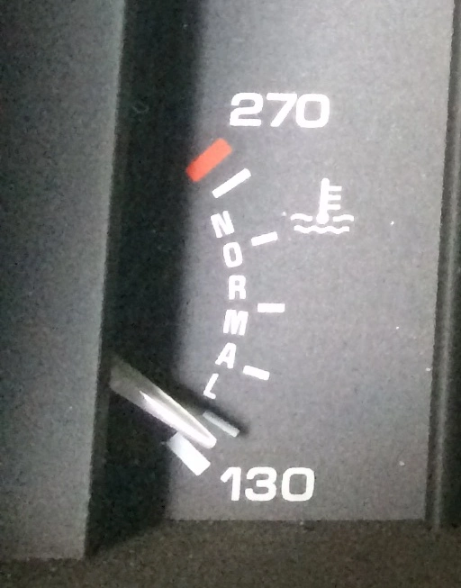

FYI, I just ran my engine.
Edelbrock high flow pump, stock pullies, 20 year old 3-core brass radiator , motorcraft 192 tstat, fresh coolant.
Runs about 195-198 degrees. Stock guage shows about the R on normal.
Before I ran a 180 tstat and the stock gauge would show down around the A. It ran about 185-188 degrees on my autometer gauge.
I’m using this to verify my actual temp. So degree difference in engine temp resulting in a decent amount of needle sweep on the dash guage. I bet if I let it creep up to 205-210 it would be right near the top. I’m happy with it around 200ish. Also, like I said the stock guage just isn’t accurate at all.

I’ve had underdrive pullies on my ‘86 since it was new, never a problem. With a recent HCI upgrade, I replaced the stock radiator with a SVE aluminum radiator and replaced the fan clutch. Absolutely no cooling issues.
A couple years ago I swapped my coolant temp sensor and my normal operating point on the gauge went from pointing level with old sensor to one line up with the new. Nothing else in the system changed. My fans come on at 205*F and I run a 180 T-stat
See the range of normal. If you are within that, you are okay. If you can check temps on rad tank and all is good, don't sweat it.
