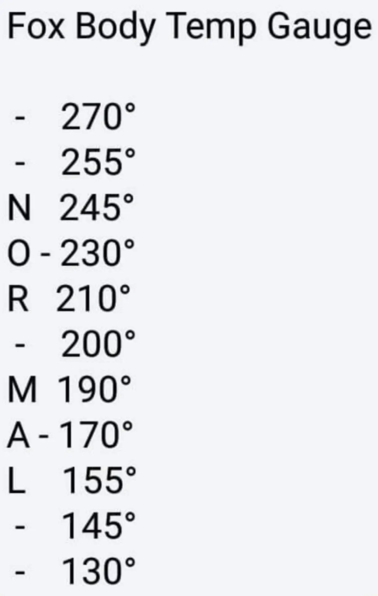

here you go

FYI, I just ran my engine.
Edelbrock high flow pump, stock pullies, 20 year old 3-core brass radiator , motorcraft 192 tstat, fresh coolant.
Runs about 195-198 degrees. Stock guage shows about the R on normal.
Before I ran a 180 tstat and the stock gauge would show down around the A. It ran about 185-188 degrees on my autometer gauge.
I’m using this to verify my actual temp. So degree difference in engine temp resulting in a decent amount of needle sweep on the dash guage. I bet if I let it creep up to 205-210 it would be right near the top. I’m happy with it around 200ish. Also, like I said the stock guage just isn’t accurate at all.
