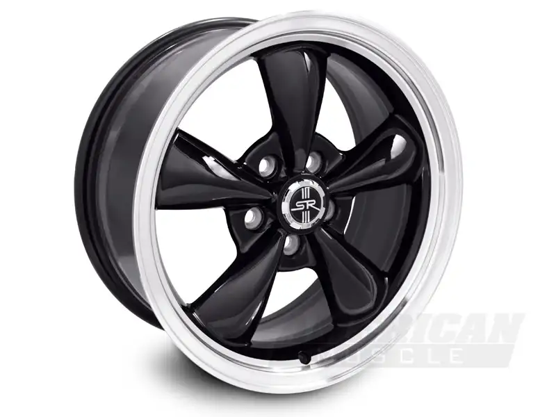

I think it looks 10 times better with the Cragars and TA's it has now. However, if you want that type of wheel, I think the 17 inch OEM Bullitt type wheels would look better. Maybe its just the center cap that looks better. They are available in chrome, dark gray, and black.
I think you should go with this if you want to change to the Bullitt wheels.

Thanks for the info Tx65coupe. Those wheels that I am getting are exact replicas of the OEM Bullits with a different center cap that are a lot cheaper. I defintely plan to get the OEM center caps like in the picture you posted. You can get those on ebay and replace them in seconds. I did the same thing on my 2002 GT. Bought aftermarket OEM style wheels for less and replaced the centers and there was no way you could tell a difference.

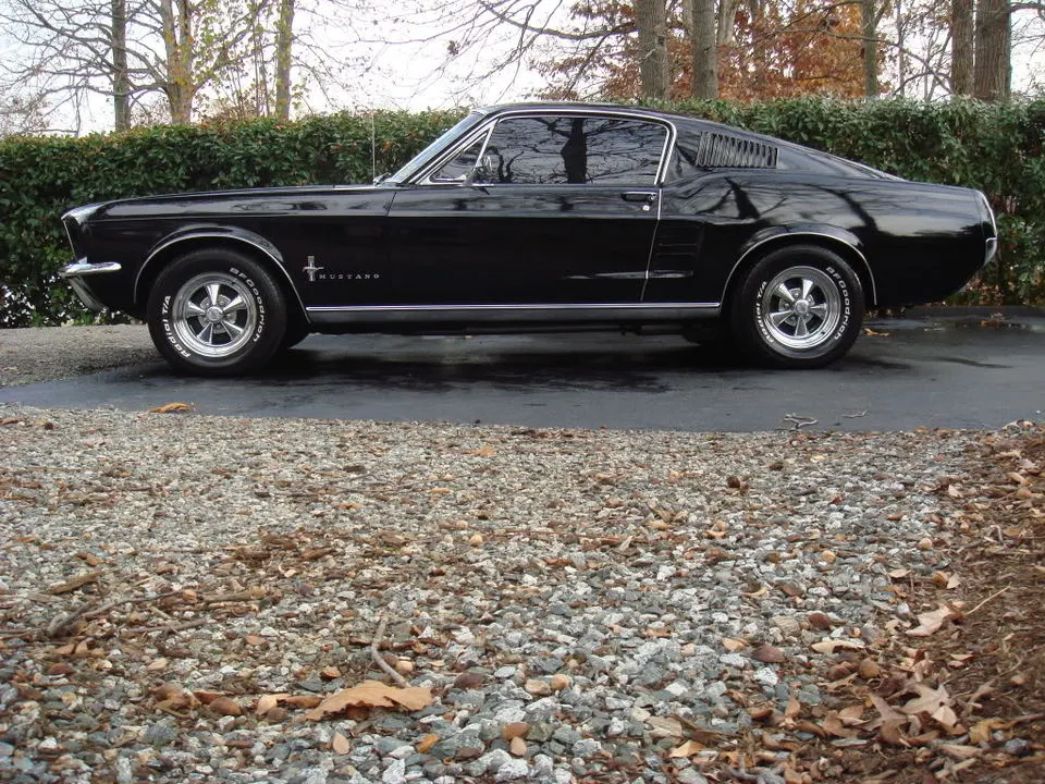

As for the Cragers in the picture they are no longer on the car these days. I currently have the TA's mounted to the factory styled steel wheels. It looks a lot better, than the old played out cragers that I put on there 10 years ago when I didn't know any better.
Im just not a big fan of chrome wheels anymore. I will still have my original wheels that look good that I can swap back and forth between.

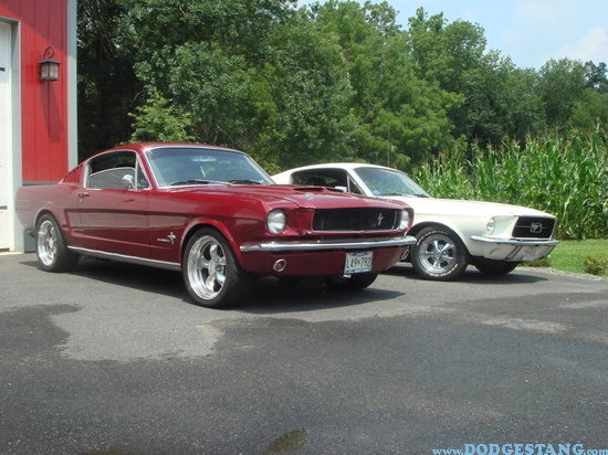

That may have come off a little to harsh. I like the look of the cragers on certain cars but it just isn't my taste anymore. I'll try to post up some pics of my car with the original styled steel wheels. I think it looks so much better, mainly because it looks stock. From that pic the white 67 doesn't look pretty good with the cragers. Is it your car? And as always I'm loving your fastback, it has a perfect stance!
