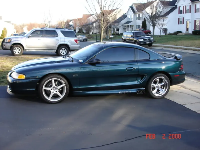

Diameter is not the problem, the backside of spokes hit the front face of the caliper. you see it on a lot of new cars with aluminum wheels, looks like a fraction of an inch clearence between the backside of the wheel and the calipers. Hopefully the 1/4" spacers won't be to noticible. Methodical, do you have a pic of the front wheels and spacer installed?
What kind of a picture do you want or what is it that you want to see. I can take one for you. Let me know.
I just want to see how far the front tires stick out, is it that noticable? I'm realy picky if doesn't look right. Maybe a shot looking down the side of the car? I would appreciate it.
I see you have 275's up front, wow. I only have 245's maybe I'll be ok, I hope.
Hell, you are in Waldorf and I am in Clinton. Just come and see the car for yourself or we can meet, maybe at Waldorf Ford, Lowes or HD. I will PM you my cell. Let me know.
