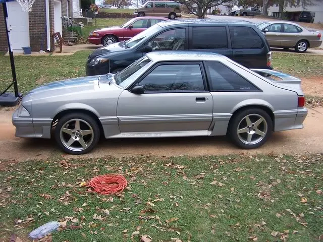

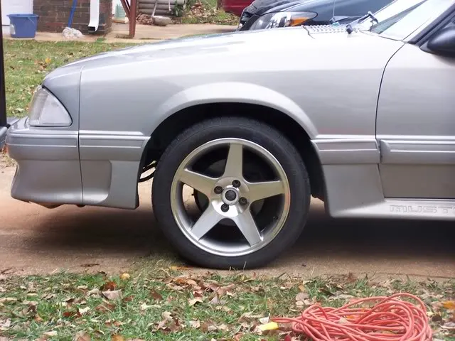

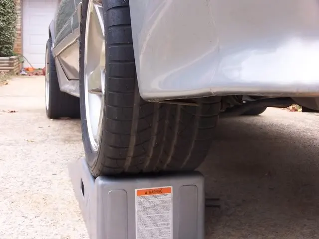

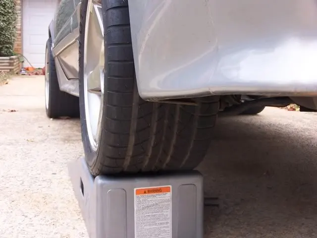

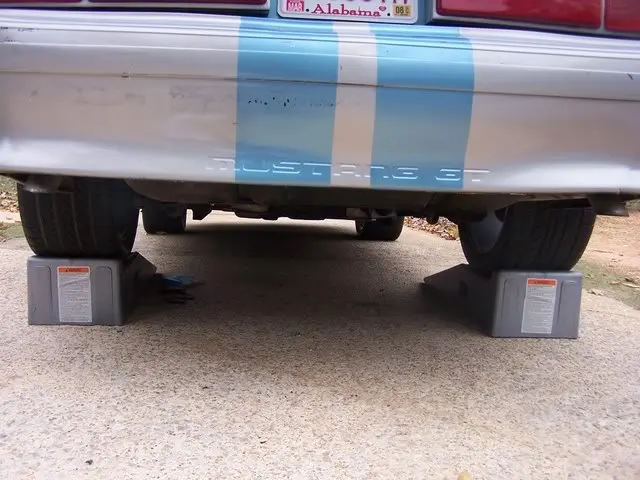

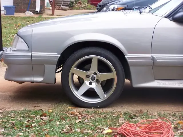

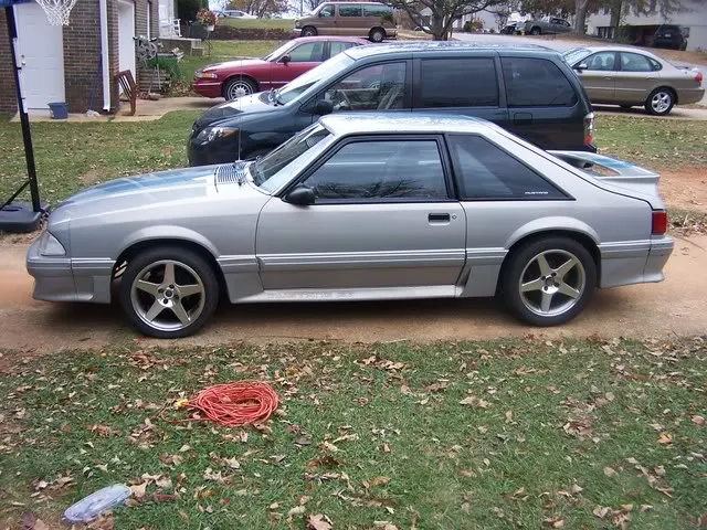

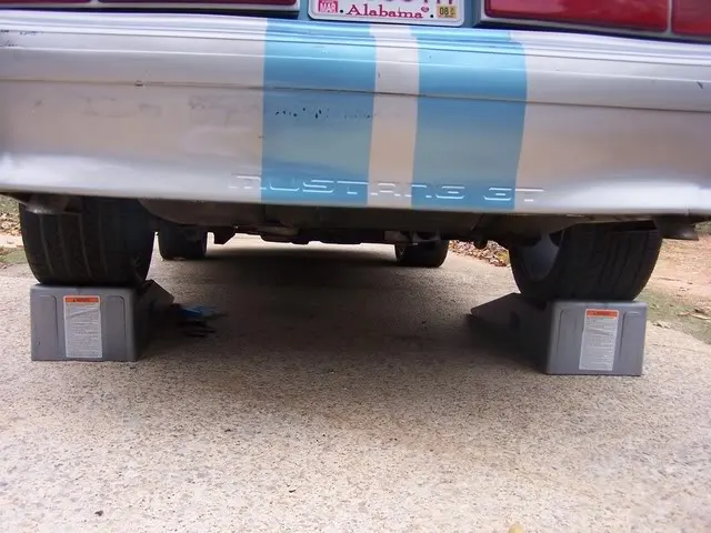

I guess I'm not sure if they have the same offset. Here are a few pics:
This picture shows you how much the front wheels stick out:
The back tires are 285/40R17 and the fronts are 255/40R17

Those tires are pretty wide, without the perfect offset, probably too wide.
I bet if the rears were 265's, there probably wouldn't be an issue.
But for your own sake, i'd measure all the offsets.
