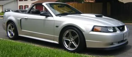

I have 3.73's and 18x10 saleen replicas in the rear with a 285 tire, lowered on tokico springs. Looks great and doesn't rub on a damn thing. Gears feel great too, especially now that I got an Xcal2. If you get the 10 inch wheels in the back, I'd go with at least a 295 because my tires aren't quite as wide as the wheels. I got em used so I didn't really care. Oh yeah, and I have 18x9 with 275's in the front without a problem as well. Riding really low in the front though. Here is a pic to see my ride height and the wheels.
