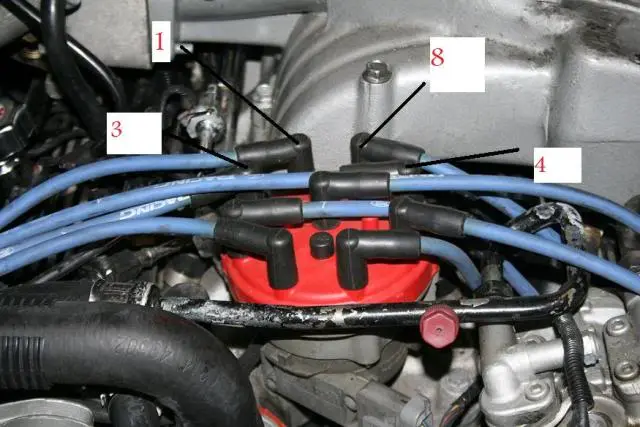

All of the diagrams I've seen shows the #1 cylinder on the drivers side/firewall side of the distributor but mine is on the pass side firewall. Is my distributor just turned alot? looks like what I would assume to be straight.
Is this wrong? would it even be able to run if each cylinder was off by one?

Looks like your distributer is in a tooth off, usually you can't get to the lower TFI screw if it is in right. Someone may have moved the wires around to get the timing right, but it plays havoc with the idle and low speed performance when the injector timing doesn't match the ignition timing.
The distributor rotor and the PIP shutter are locked in mechanical alignment by the manufacturing process. That means you cannot get the injector timing offset from the ignition timing. The PIP shutter wheel has one slot smaller than the rest and this identifies #1 cylinder and the start of the timing reference for injector to ignition timing.
The only thing that being "one tooth off" does to you on a 5.0 engine is it can prevent you from being able to turn the distributor enough to get the base timing advanced to the point of max performance.
AIBANDIT: Your distributor and wires are in the right place. You will need a timing light to set the timing correctly.

The HO firing order is 1-3-7-2-6-5-4-8.
Non HO firing order is 1-5-4-2-6-3-7-8
