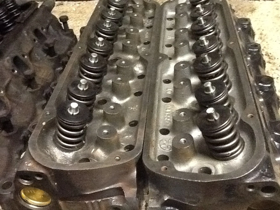

I bought some rebuilt gt40heads for my 289 (non p), cheaper than rebuilding my 289 heads. I know about the combustion chamber size will affect compression and am correcting this with new pistons. Castings are f3ze aa & f1ze aa I was told these are off an actual 5.0 cobra.
I bought these bare w new springs and valves only. My question is do I need guide plates to run roller rockers and if so do I need to mill the heads? What size thickness of push rods and studs? I will buy pushrod tool to check lenght. I want to run 1.6 full roller rockers unless machining is required and i will run stock stuff. From what i read these heads ran 1.7 full roller rockers from ford?

You need guide plates when you have a stud mount rocker arm. If you have a pedestal mount style head, then no, no guide plate required. Also, you'll need a hardened push rod for use with a stud mount rocker arm.
And I do believe the '93 Cobra's ran a 1.7 roller rocker from the factory.
Well i guess i dont know if i need pedestal mount or stud mount? Please educate me. Thanks

The Cobras came with 1.7 Roller Rockers from Ford, they were made by Crane. They are a pedestal mount rocker, meaning they are held on with a bolt and not a stud. You can add studs to your 40's, along with guide plates, but it does require machining. That adds alot of cost to your budget heads. I run an original set of 93 Cobra rockers and have had no problems with them. You can also buy them aftermarket. They require no maching and bolt right on.
Joe
Thats the info I was looking for!!! I'm not going to machine the heads. Any good suggestions on where to buy a pedestal mount full roller for $200 or less. I have found used original Cranes on eBay but I rather buy new. Thanks for all the help so far and more questions to come.....
