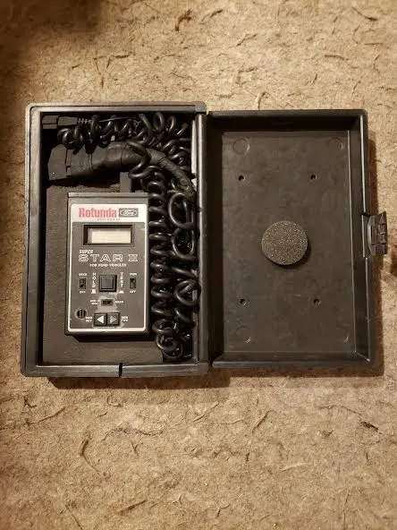

I have a OBD1 on the way to check out codes. Just waiting for it to get here.
