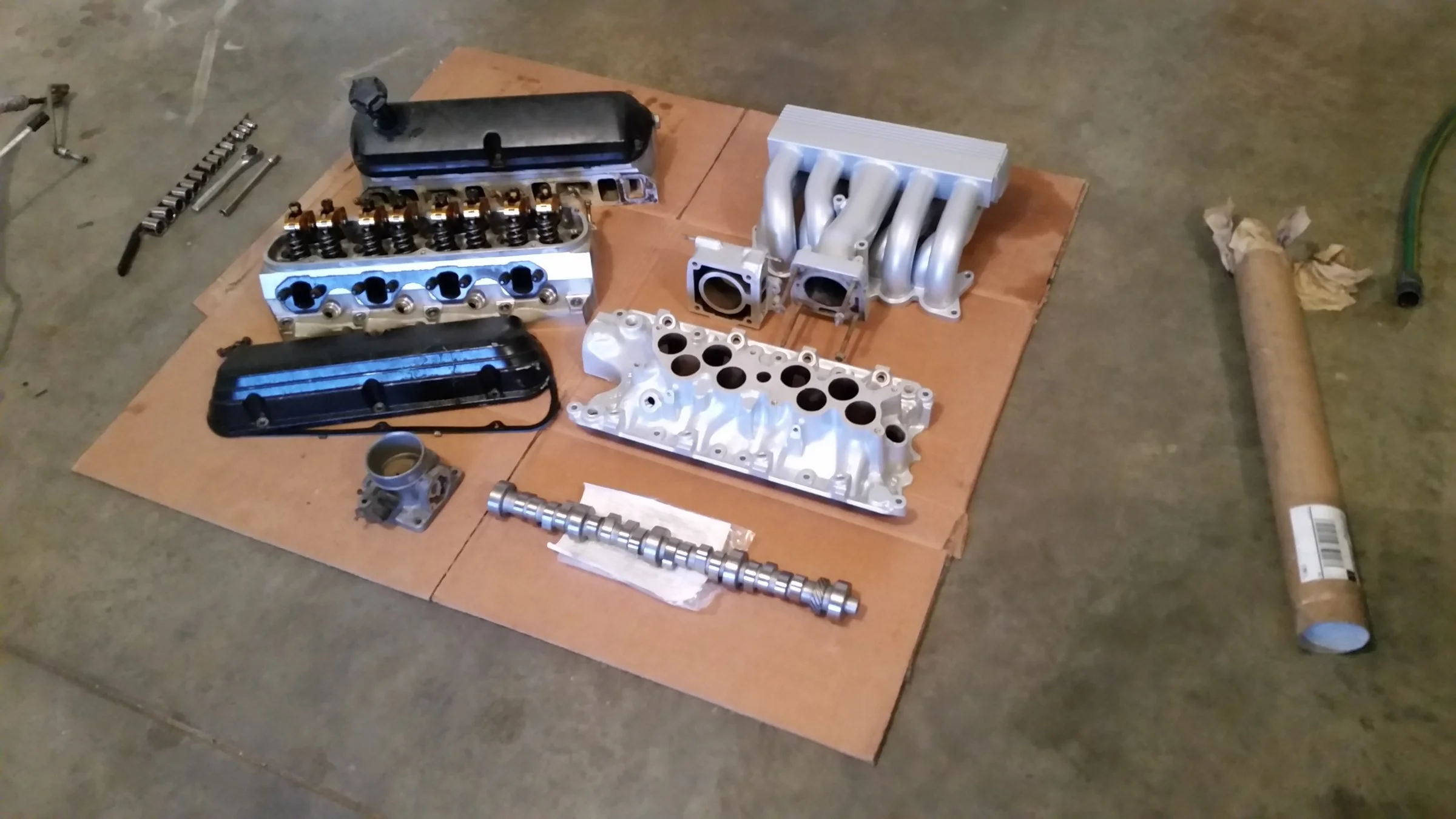

Nice parts pile.

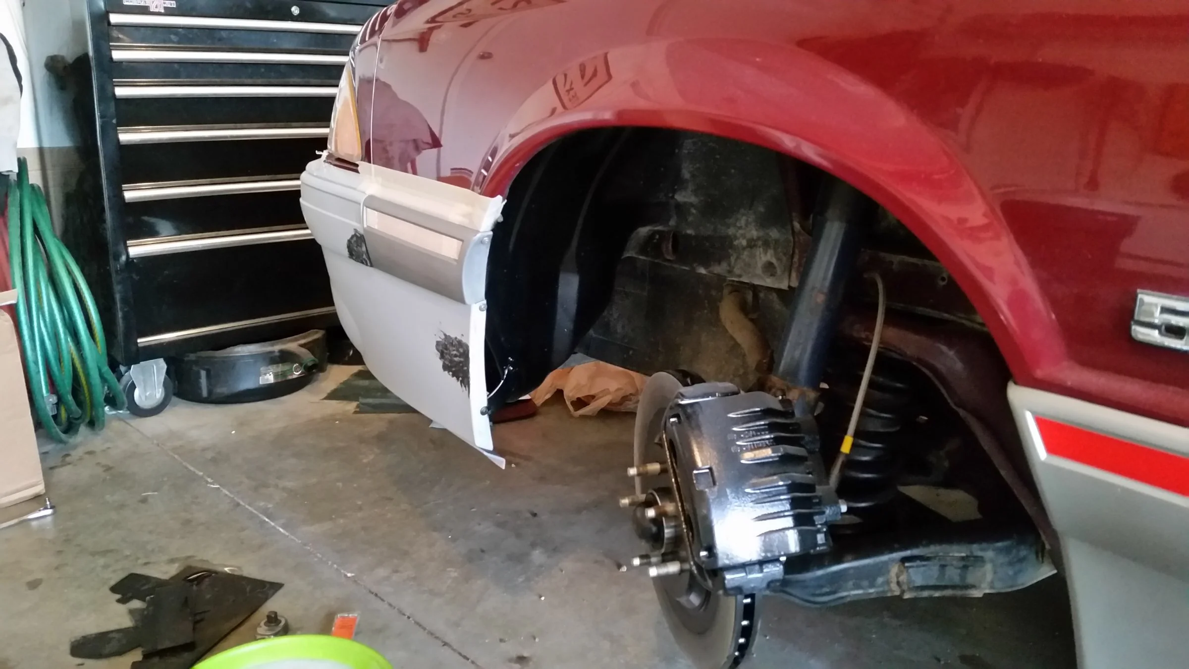

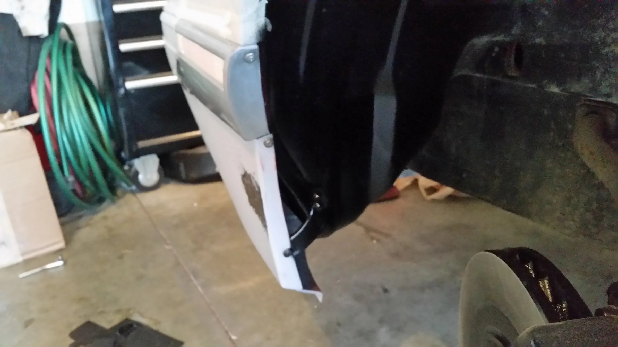

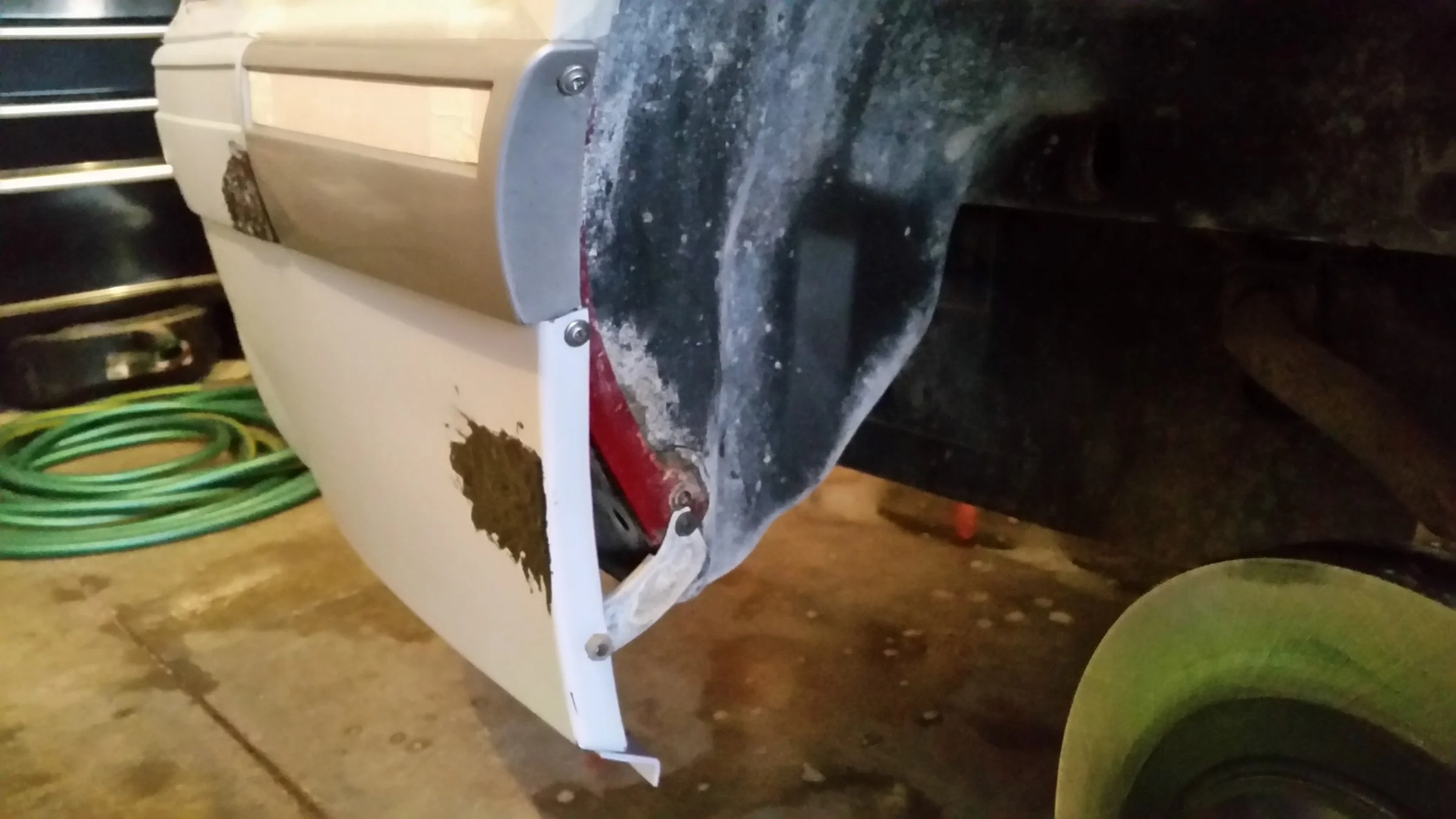

Alright, tonight I made my brackets out of existing side skirt bracketry to pull the sides of the bumper in where I wanted. They arent pretty yet, but they work. I will be using different hardware on the bumper end, to eliminate the nut being such an eyesore. I also couldnt bring myself to leave the driver's side of the bumper so thin you could vaguely see the SN body line. So I roughed it up and smeared some PBA on it and another wonky area on the trim. I dont think either area would have stood out much, but this just makes me feel a little better about it.
Only snapped pics of the driver's side, as the passenger side has no room to step back.

Are you going to cover that triangle shaped gap? Maybe a piece of black plastic or something?
Now you did it.......and he was soo close to being done...
I know, I know, I'm start'n trouble again.
It just looked kinda, well, empty. Like not done yet, incomplete.
A big f-ing gaping triangle that shouts LOOK AT ME! THERE IS NOTHING HERE!
Sorry
Man, that bumper look GOOD!
Thats a good question, and here is the issue. I want to, because obviously it would look better. However, I have tire clearance issues and already had to break out the BFH to get those brackets out of the tire's way. So to cover it even with thin plastic, would only last a short time without me doing some more extensive work. Have I mentioned how I feel about body work?
So the brackets will be painted black, and the little gap is gonna stay. The way I make myself feel better about it is that there was already a "vent" in that area from the factory fender extensions, so why not just mimic that with my own version.
Reactions: General karthief, Davedacarpainter and A5literMan

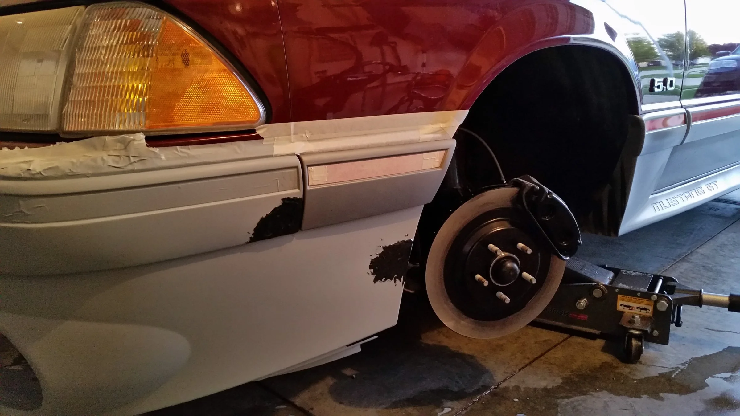

karthief said:
Thats ok too, vent, ya, gotta keep them tires from overheating, good excuse to leave them there.
Anyway, I guess you probably hate body work .
Tell me again, now that the area is washed, prepped, and painted, just how noticably unfinished is it? This body work hating individual thinks it looks pretty good enough.
