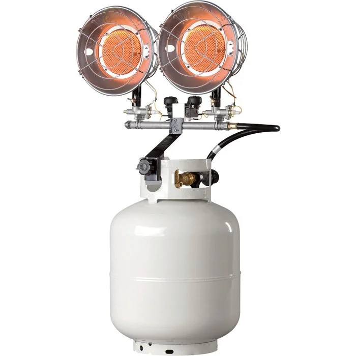

How can anybody live in the great white north as long as you have, and not been able to justify a simple propane fueled space heater?
69 bucks, plus the cost of the propane bottle...No more mr. freezy.

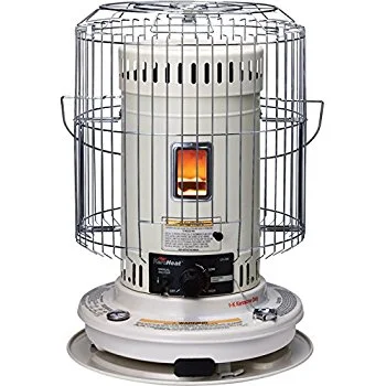

I have a nice kerosene heater, just thought 40 would feel ok without it. This was the one sitting in the corner watching me work.
By the time the cold had set in, I had busted a few nuckles and the fun was too far over to fire it up and wait for the garage to warm up. What I should have done was let the car warm up, and then all the parts would have been warm to the touch. But I knew my rockers were loose and didnt want to hurt anything.
