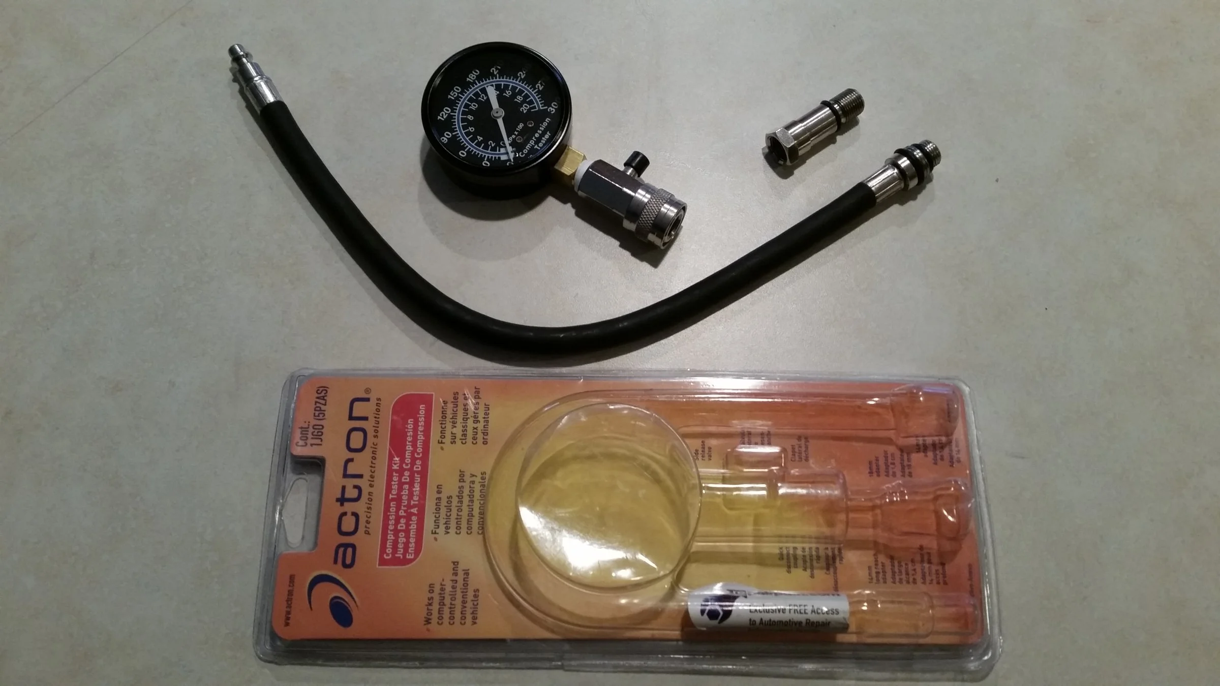

My vote is compression test time
Sure as , ZERO compression on all four passenger side cylinders. And yes @CarMichael Angelo , I had the compression test tool seated so it wasnt just blowing past it.
How I was able to spin pushrods and only turn the rocker nuts a half turn past zero lash and be so tight that I have the valves stuck open, well that is beyond me. But I will be backing them all the way off and reading up on how to set them up again from full on loose.
I have never heard of that...why is the whole passenger side head dead, and not the driver side? How did you hulk out, and crank the sht out of the rockers on the driver side, then turn back into DR. Banner, and not SMASH! the driver side head into adjustment?

Possible it's not the valves and something else? All 4 cylinders on one side?
Is the head properly seated or was the gasket compromised?

Sorry guys, what I meant was that I only tested one side. 4 cyl of no compression was enough to convince myself I F'ed it all up.
