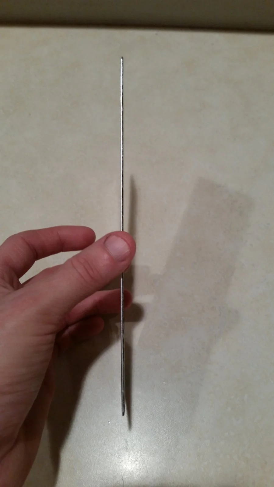

The car is back together and running. I ended up breaking the stock quadrant adjuster to get it out. I saw no other way, lol. The new quadrant is in and the clutch feels good. I have it adjusted so that the slack is just taken out. I started the car while up on stands and ran it though the first three gears and reverse. All feels good, I am happy with the clutch engagement, the engine idles and revs nicely. I am going to change the oil and see how it looks with all my assembly, reassembly, and reeeeassembly. With the little run time it has had since I put it all together, I am hoping to see pretty fresh oil with no signs of metal or coolant.

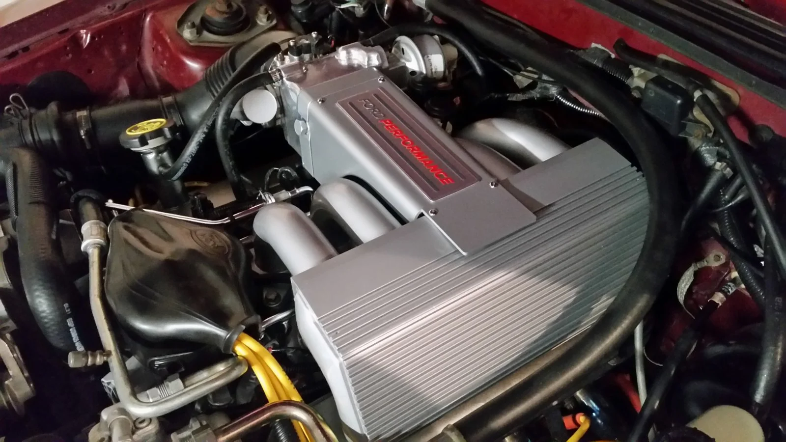

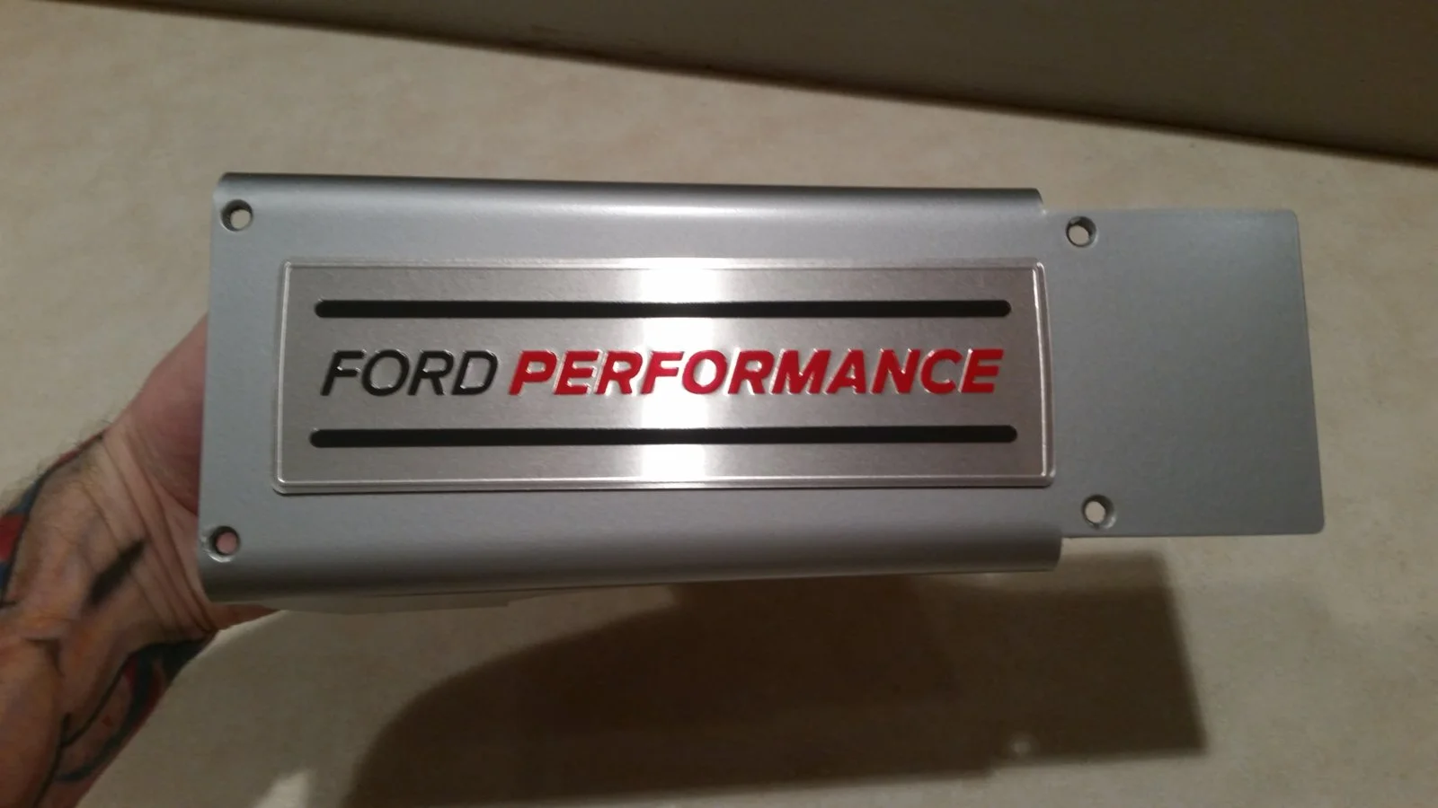

I ordered a plaque for the intake cover, but it may look a little too nice. I think I'll have to "age" it a touch.

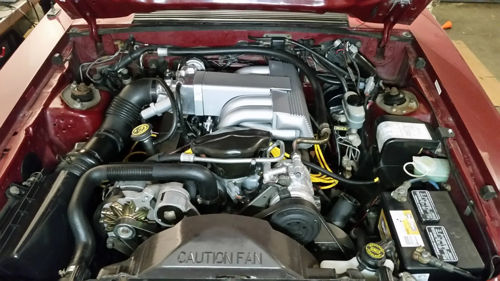

My engine bay needs a good detail. Look how dirty the firewall is. I also need some black or gray plug wires.

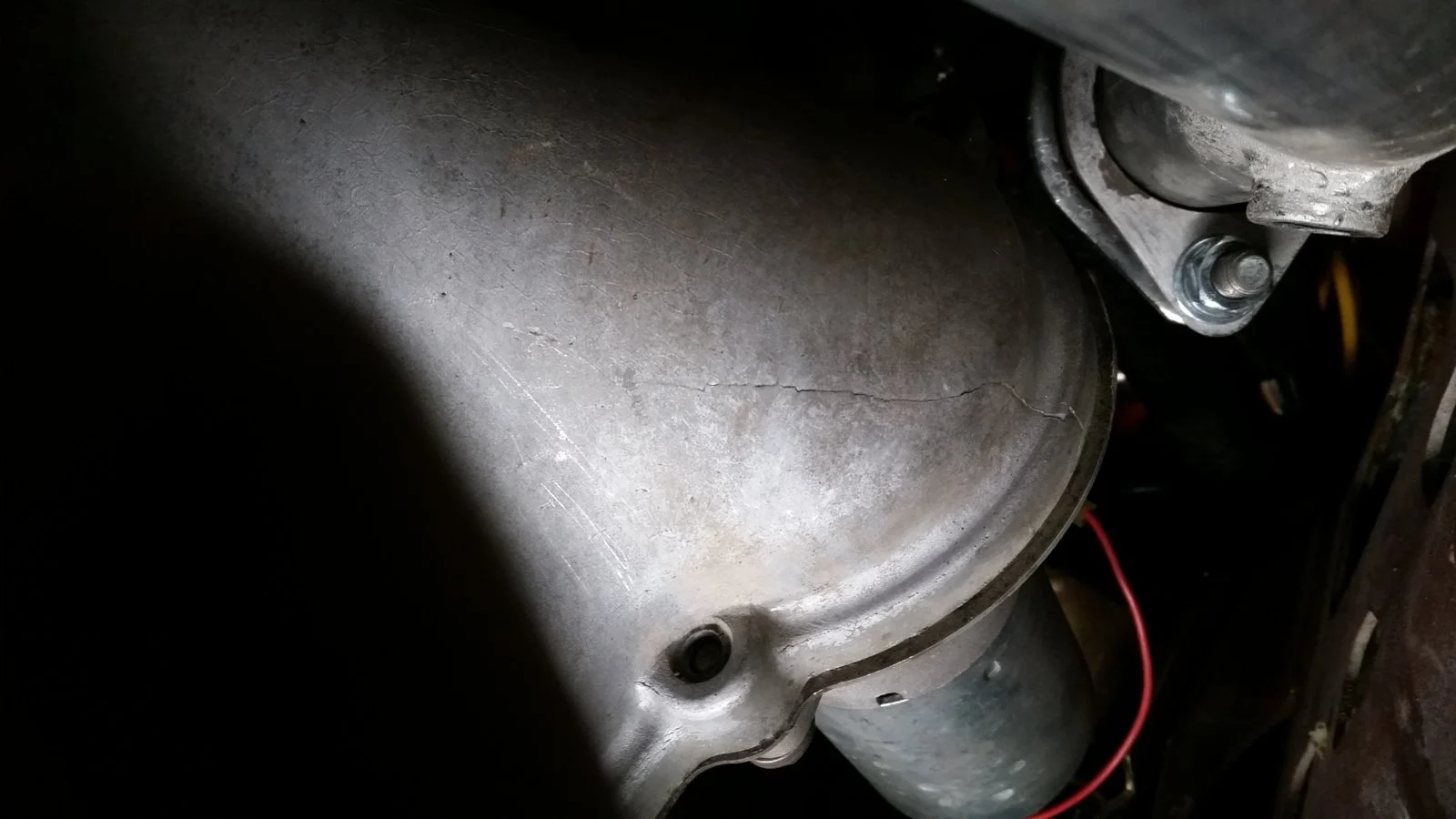

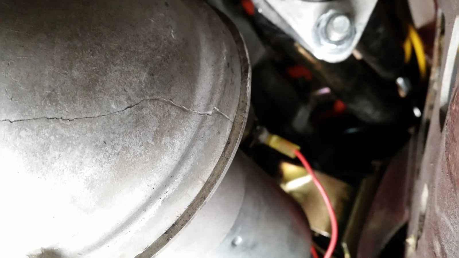

Lastly, look what I noticed today while reinstalling my starter. Looks like it was previously filled with something, too. Hopefully it stays together long enough for me to get my chassis and suspension done before I have to shell out for a transmission.

Drill a hole at the end of the crack then jb weld it, do both sides just for fun.
Meh, I am leaving it alone. Its just around the starter. If it were around a bellhousing bolt hole, then I'd be a little more concerned.

I tell ya what, that $25 Ford Performace plaque sure wasnt what I was expecting. From the pic, I made the assumption it has a we bit of thickness. Turns out $25 gets you a paper thin stamped aluminum sheet. I feel like its a flattened quarter from an amusement park.
But regardless, it fit the space nicely, and the dark gray print matches my color scheme, so on it went.
Now I just need to slowly detail my engine bay. New tape around the looms, a good scrubbing, some nice CC plates and a body colored radiator cover plate.

How do ya spose that crack got there Jeeves? Crack's just don't show up for no reason. Granted, the crack is on the opposite side of the bell housing where i would expect a stress crack to appear, as it is on the other side of where the engine torques against. But If I looked up there, and saw a crack like that one, I'd have to scratch my head and ask what caused that crack then?.......What else besides engine torque?....What else would create enough of a "twist" to start, and cause the crack to walk like that?.......Hmmmmm...... What would cause a crack on the "starter" side of the engine?.....
Ya figure it out yet Iowa Nick?
You have a starter that torques there. I'd bet if you watch that crack when somebody hits the key,...

That crack would give me the worries.

Well fellas, I have driven the car all of 20 miles in the last year and half, so maybe I'll be able to afford a new transmision by the time I drive it enough time that it totally breaks. I figure the engine plate helps keep the starter from from moving too much, so maybe the PO had the trans out and dropped it on the floor? Who knows.

I'd probably draw a few marks with a perm marker on the crack to mark it's extent right now and then monitor it.

BlakeusMaximus said:
I love the way that engine looks!
Thanks man. Too bad my engine bay is never going to be shaved and tucked to fully show it off. I just dont have the desire.

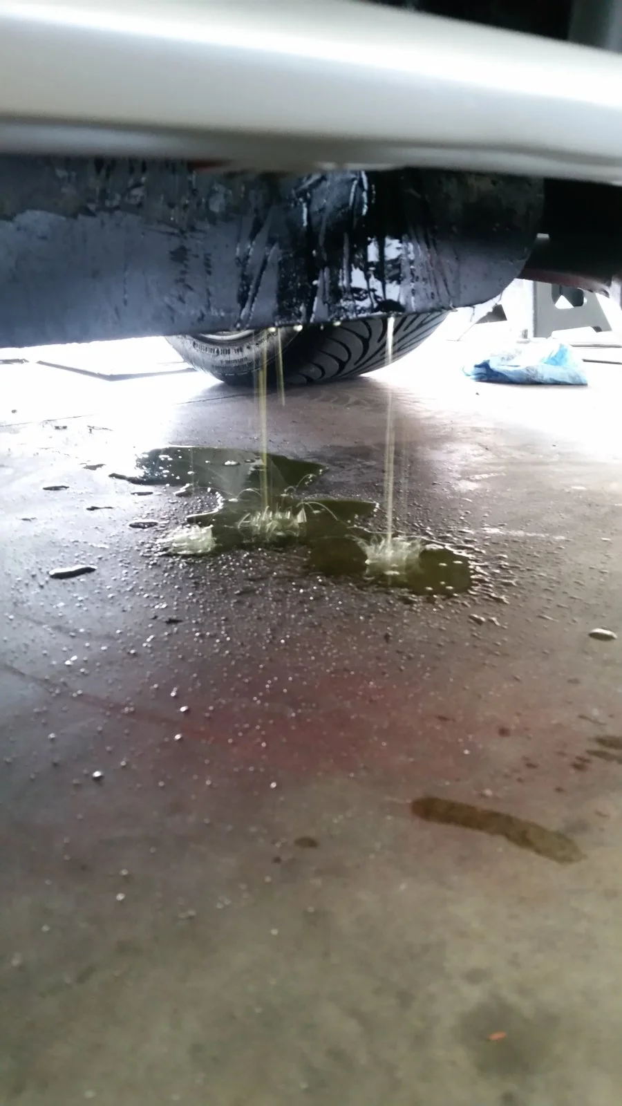

Lastly, when I pulled into my driveway which has a short curb, my small radiator leak grew into a running coolant faucet. Was barely a drip before, and that curb twisting the body did it in (I dont have SFCs yet). So radiator is next on the list, and then SFCs and suspension.
