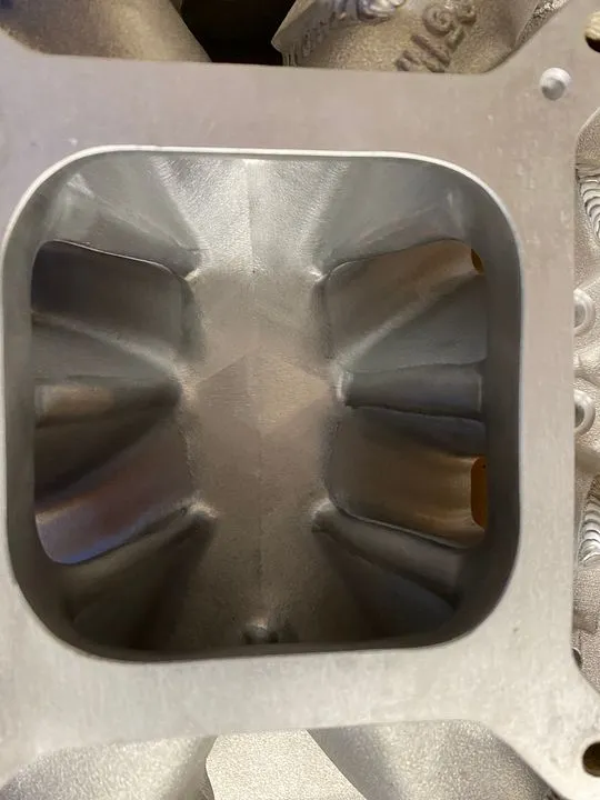

Are you porting the super victor intake?

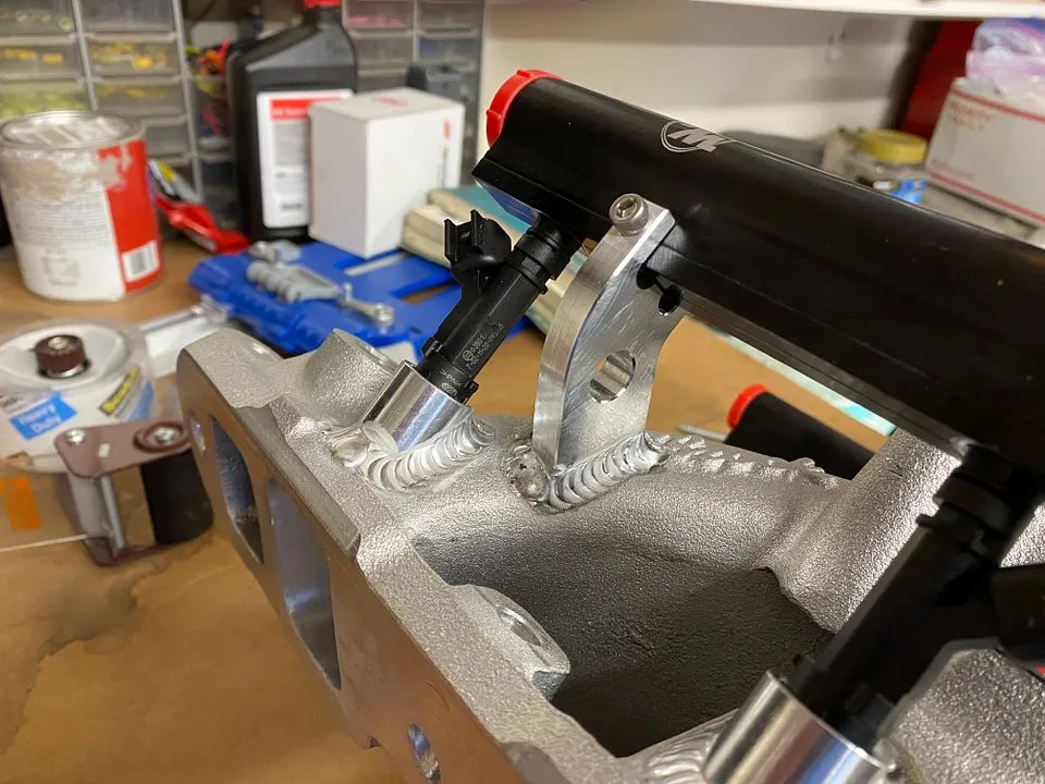

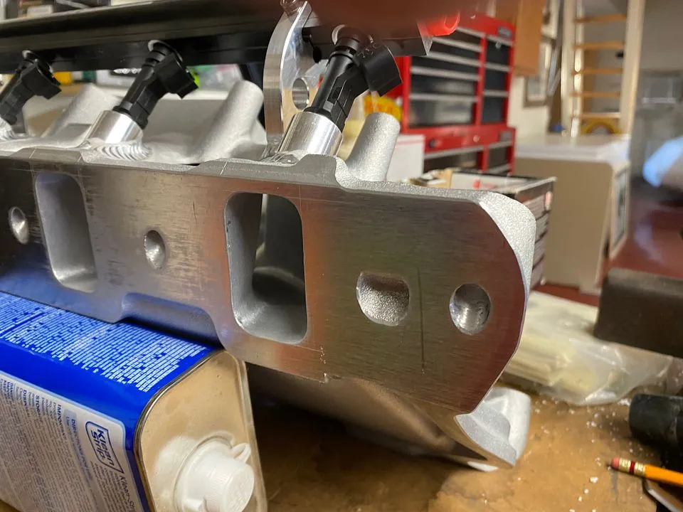

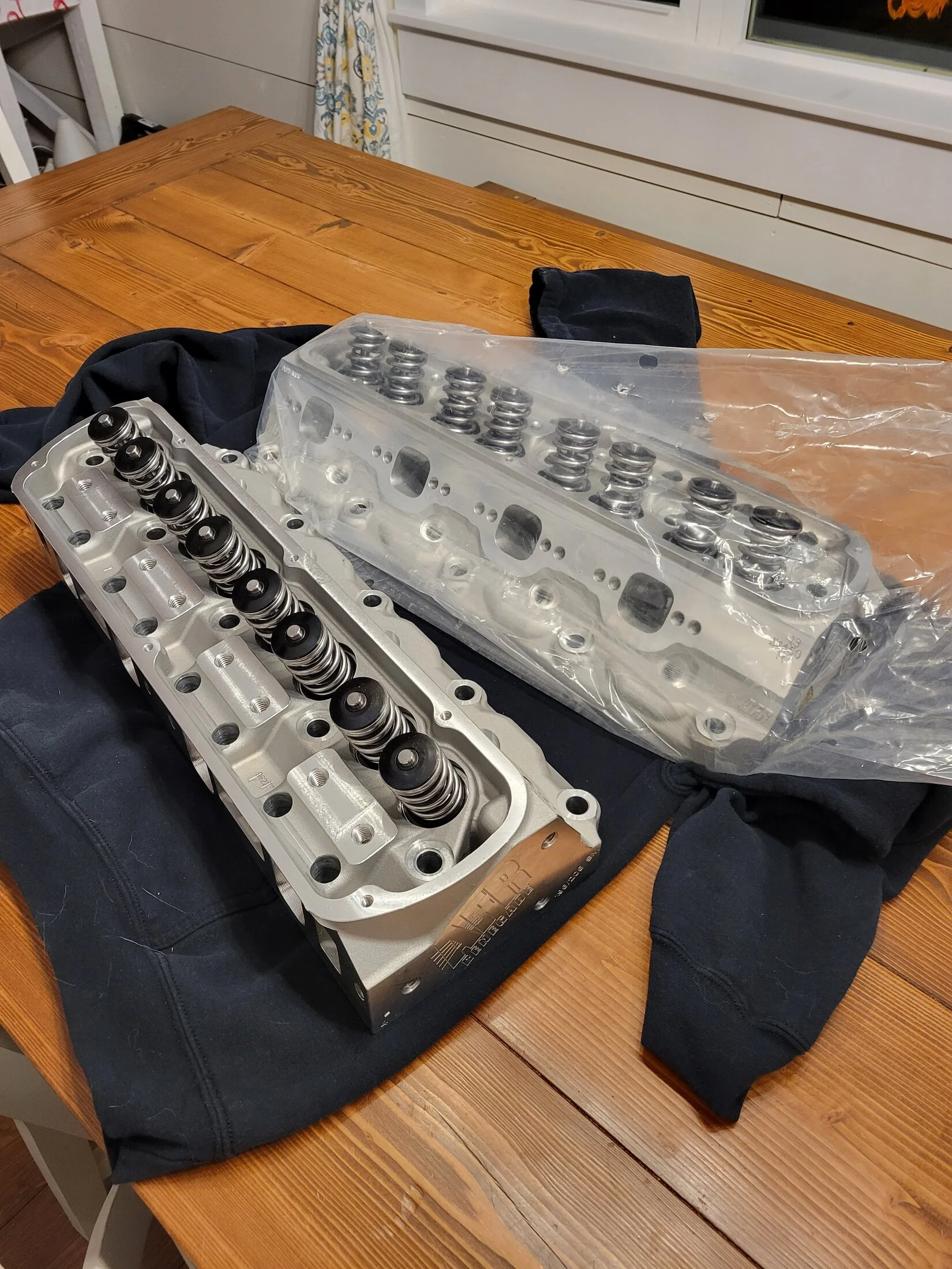

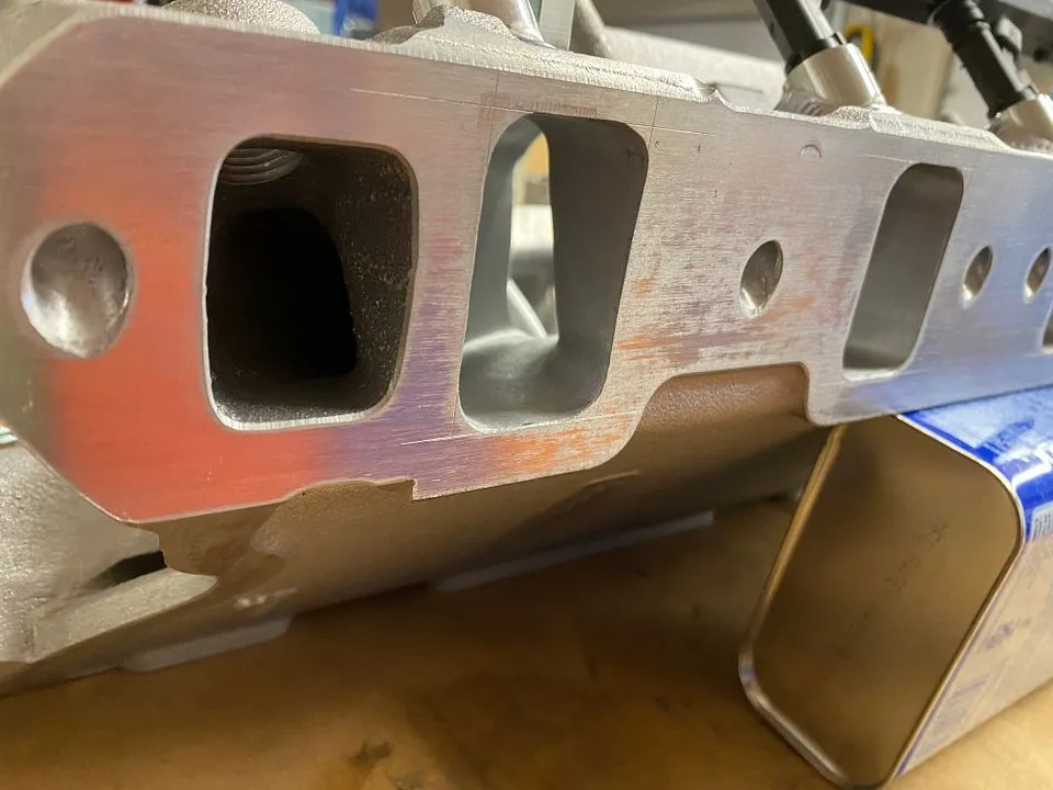

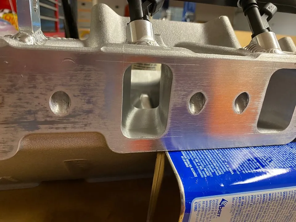

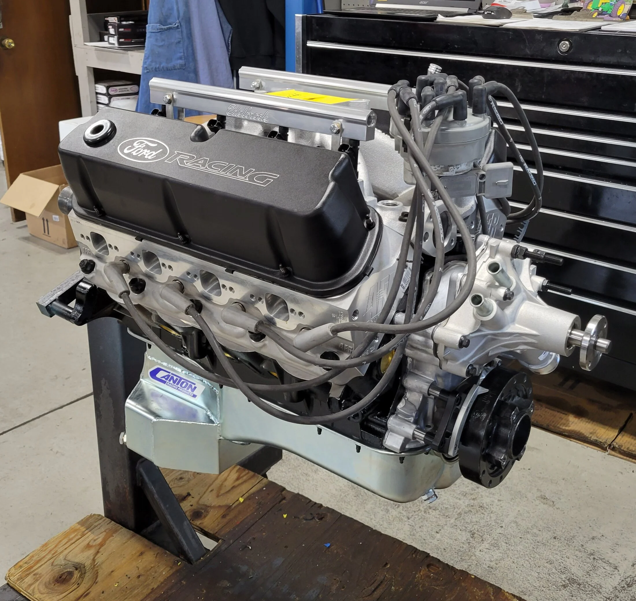

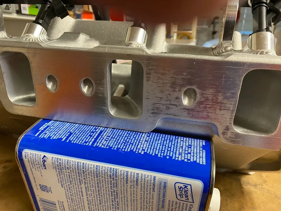

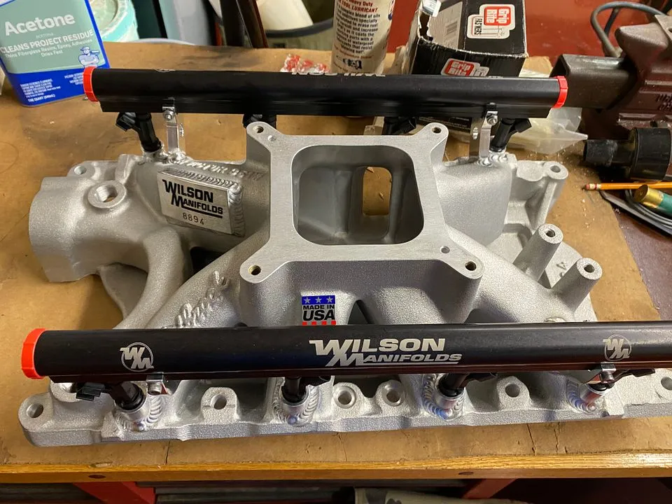

I appreciate all the info. I'm going N/A 363, with AFR 205s. Chose the 205s around my header combo. It will not be a balls to wall max horsepower car. Only plan to spin it to 6,500 rpm, and it will be solely street driven. If it makes 500 hp, then awesome, but my TF170 headed 347 had plenty of balls to be fun, so this should be great for me no matter where it ends up for power. My goal is longevity with fun factor.Was asking because we found that the Super Victor for the 377 we are building was the choke point on air flow. The Wilson throttle body and Dart heads out flowed the intake so we sent the intake to Wilson and had them port it. I think the more power you are making the more you get from the porting so just port matching may be the way to go. You would have to know the flow rate of the heads at max lift of your combination at XX inches of water column and then see what the flow rate of the intake is at the same inches of water column. That would tell you if the intake is going to be good as is or could benefit from porting.
This is the intake that Wilson ported for the 377 going in the 1969 Fastback with Wilson fuel rails and 72 lb/hr injectors (gives the option to tune and run E-85 or gasoline):

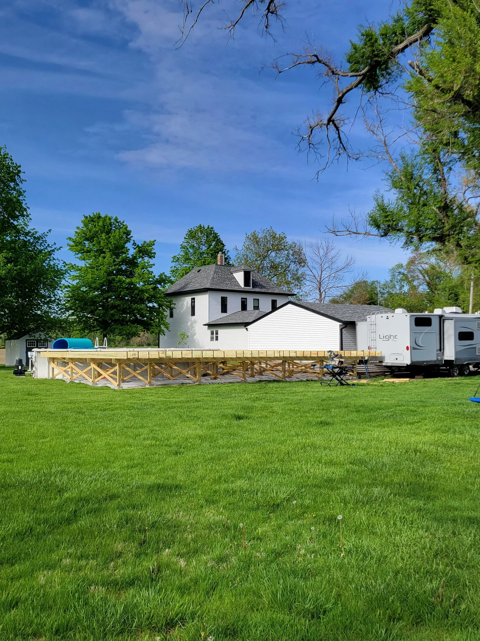

Not sure if I ever talked about after the house buying post, but there are 3 other couples with kids in our neighborhood that we've become close friends with. Combine them with the friends we had prior to moving here, and I wanted the deck to be big enough to hold everyone without getting splashed by kids. It's 1162 Sq ft.Now that’s a deck
Do it once, do it right!!!Not sure if I ever talked about after the house buying post, but there are 3 other couples with kids in our neighborhood that we've become close friends with. Combine them with the friends we had prior to moving here, and I wanted the deck to be big enough to hold everyone without getting splashed by kids. It's 1162 Sq ft.
