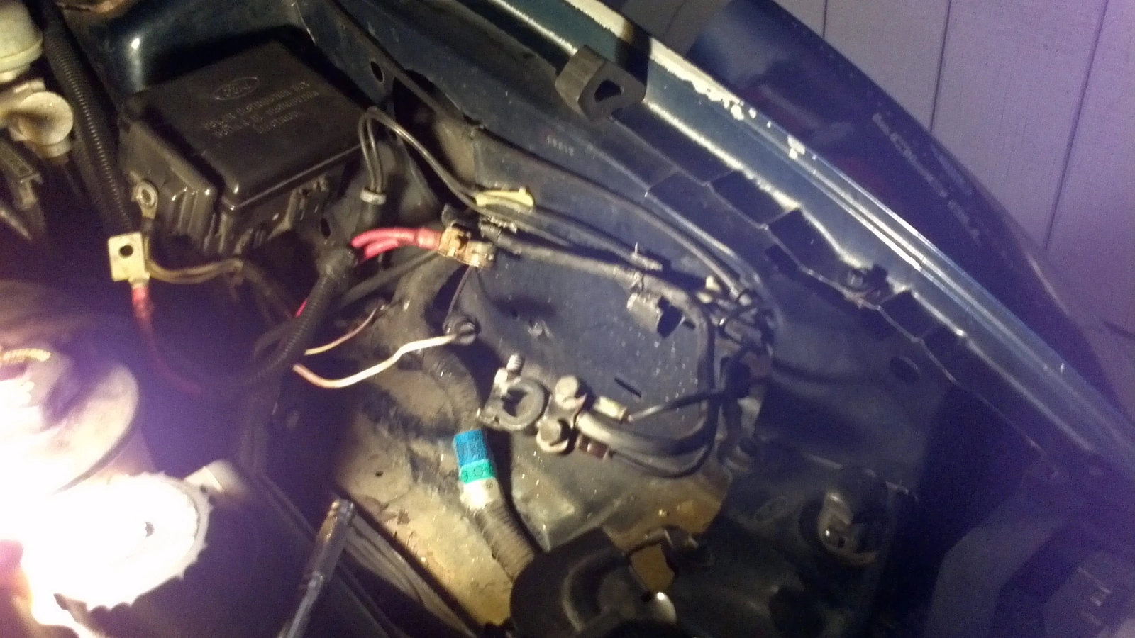

Can anyone give me some tips on battery relocation or have a writeup?
My main question is when i relocate the battery to the trunk does that eliminate the ground that comes from the engine block to the battery? When i ground the battery to the framerail in the rear thats all i need to do right?
Once the battery is in the trunk the engine bay will be painted and finished

Thanks kornnut..
So i think have figured out the ground wiring for the relocation...run the ground from the batter to my quad shock mount, then run the engine block ground to the frame of the car that the radiator sits on..
If i am incorrect about this please let me know

Kornnut, so far everything is extremely simple..the passenger side was easiest since it can be rerouted into the fender without and cuttin or lengthening of wires..
Pretty much the same thing for the drivers side depending on the placement of the fuse box..since im keeping mine in the engine bay, iwont have to lengthen anything, but if i were to be placing it in the fender then the alt wire, and a couple other wires would need lengthened..
However, without cutting wires you have to get creative with the harness as to how to get it in the fender which i will cover soon...for the average peroson, the way im doing it, itll prolly only take a couple days...but my job fuks me so i only get a day a month to even loom at the damn car

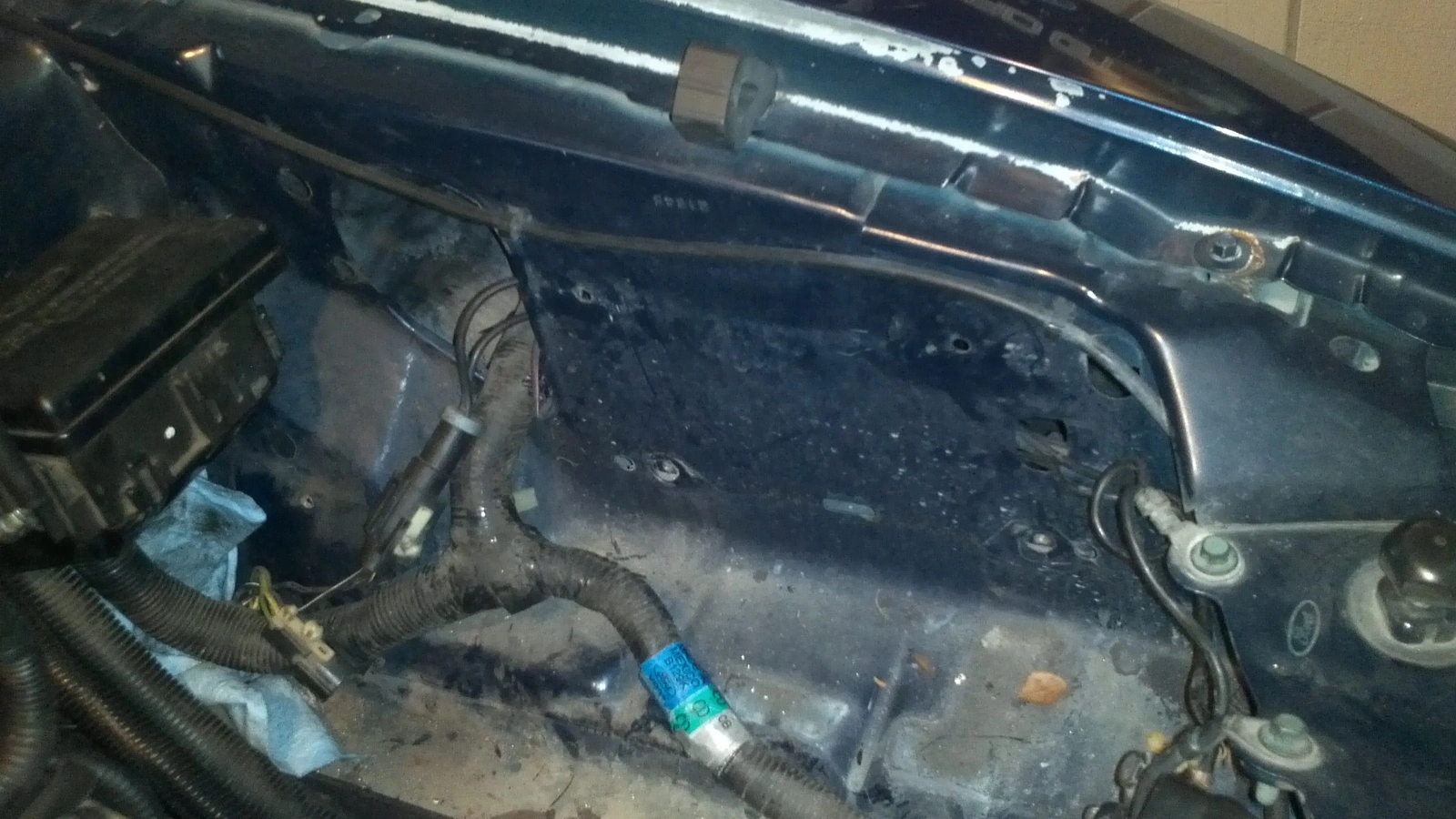

Just the liner...im trying to cut as many corners as possible lol.....but its working so far
Battery is now gone
Wiring to battery gone

Defintely going to get the hood latch cable hidden asap...bugs the hell out of ne that its there....
Never realized how dirty it was in there
