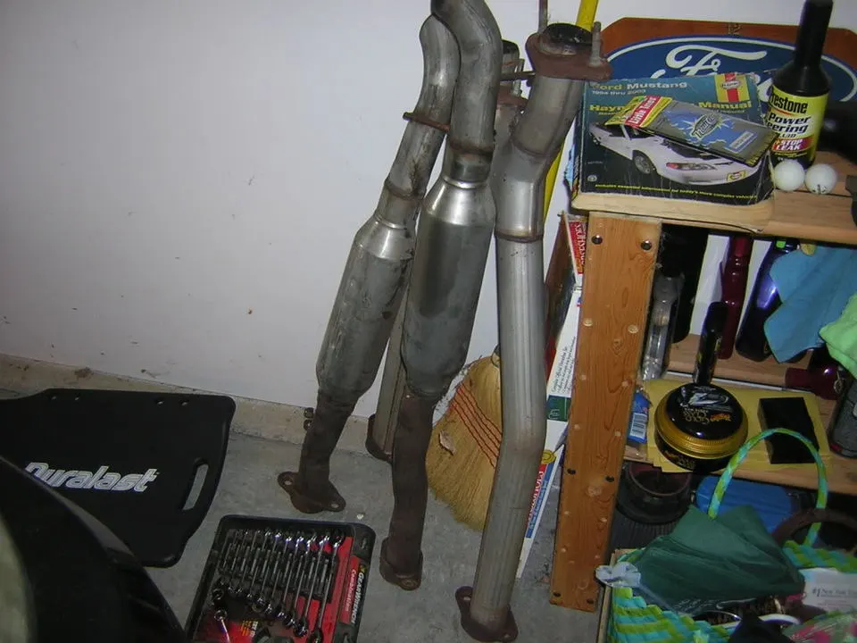

Old Exhaust
SLP dumps. I had that an o/r h pipe. It was WAY loud. :D

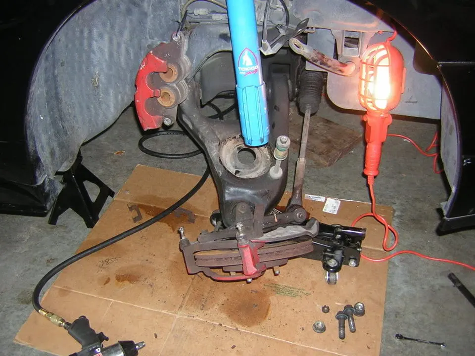

Ok well I got some more work done on here yesterday. I was able to get the passenger side almost all the way apart, just need to get a pickle fork to finish it the rest of the way and its on to the drivers side. As I am going along I am thinking of more and more parts I want to upgrade, like the breaks:nice:

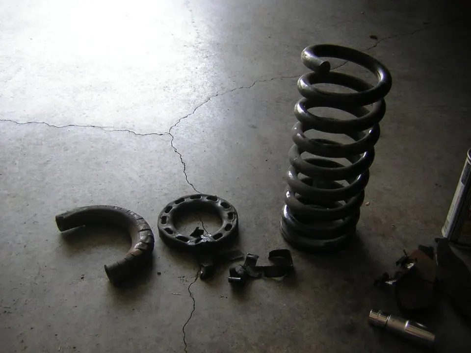

C-Springs, bye bye iso's:D
I am debating whether or not I want to go with a tubular K-member since I am dropping the stock one anyways, but my Tokico's are still basically brand new (less than 6,000 miles)
How do you like the C springs? I just picked up a set and I might leave the iso's in for now. Could you post up a pic of the drop when you get a chance?

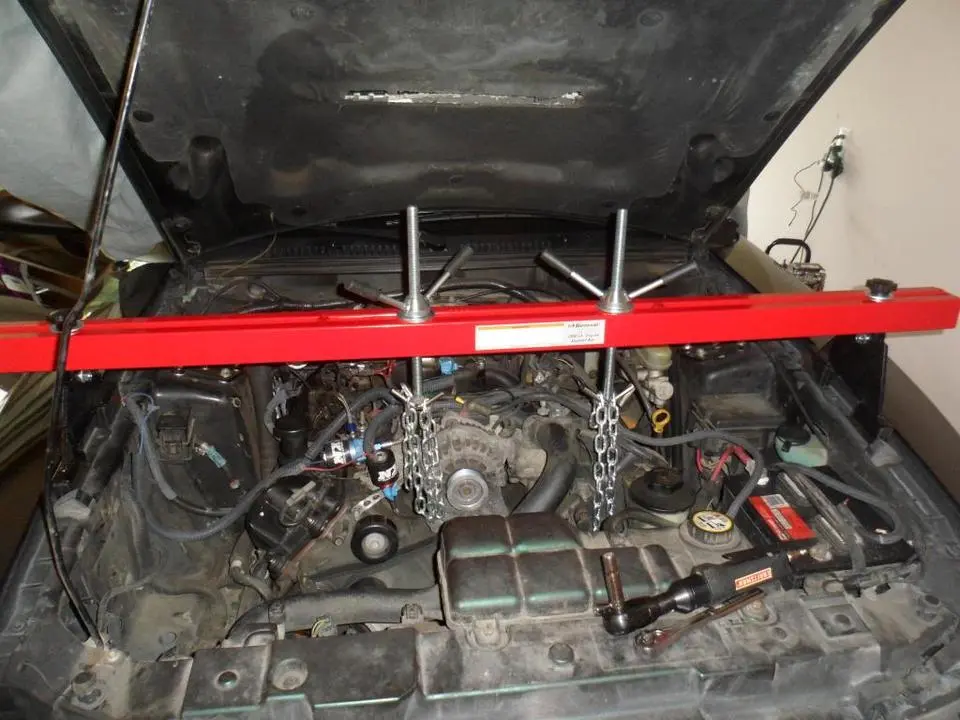

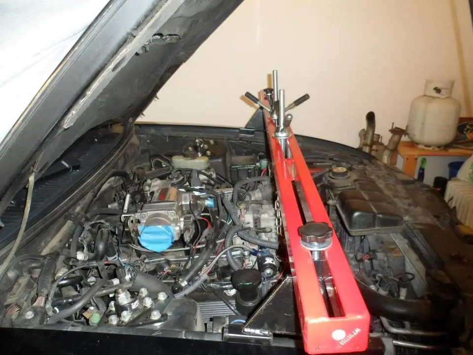

If you have LT's you may have to drop the K member to pull the trans. You have to remove one of the headers to pull it out(depending on the brand). You must support the engine with something. A support bar across the top is the best. The rest is unbolting, and the K member itself is 8 bolts. I would mark where the back "feet" are relative to the body when dropping it.
Thanks, yea I have BBK lt's but those will be getting replaced. I don't have an engine support bar so I'll be using a jack/jack stand to support the engine. Thanks for the tip on marking the k member position. Any tips for dropping the trans itself? Also since I've been out of the mustang world for a bit, what clutches would one recommend? This won't be a daily driver but I'm not looking for an all out race clutch either. Thanks.

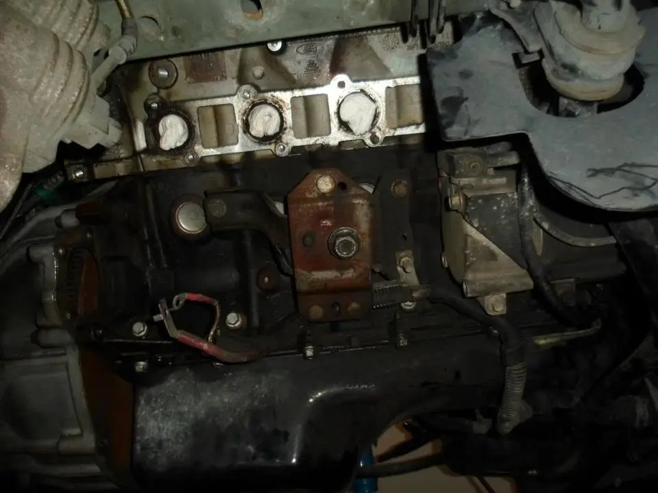

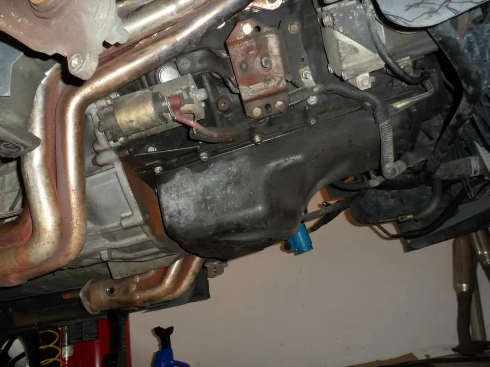

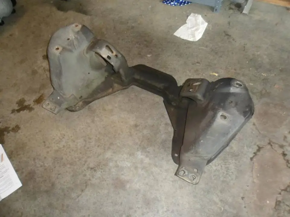

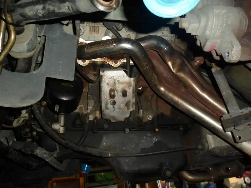

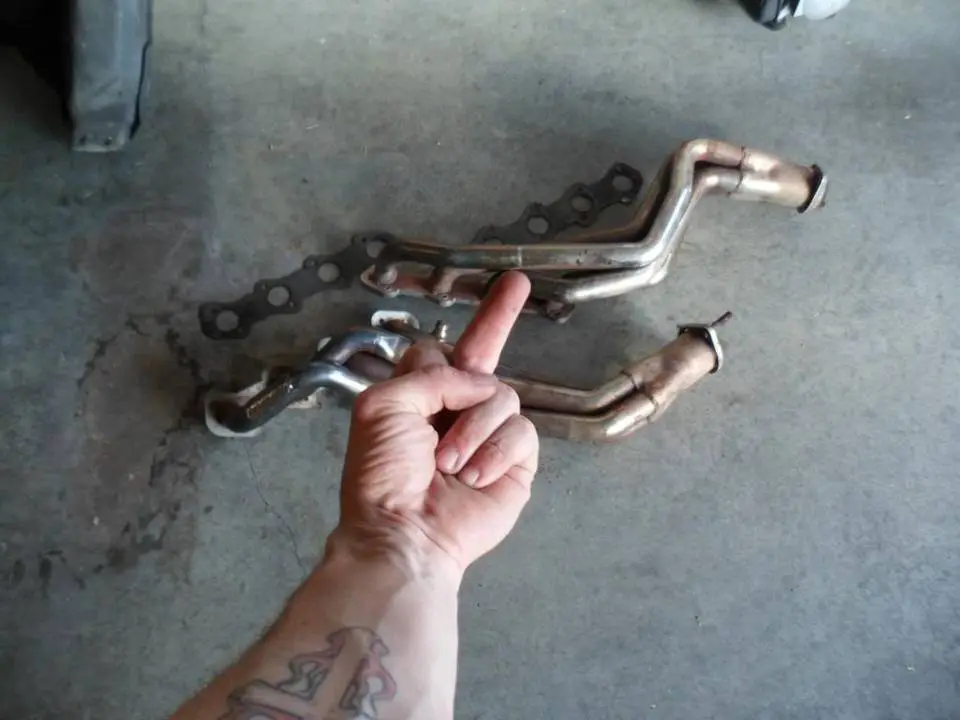

Here's some pics of ole' Nightmare torn down. I was able to pull the K, Headers, and all but I believe 2 bolts from the tranny. Once that hog is out I'll replace the clutch (advice is welcome), the TOB, PB, factory cable, add a firewall adjuster, and quadrant. May even replace the flywheel while I'm at it.
The K will be replace with either an AJE or QA1 so I can use the stock A-arms with upgraded bushings. I had to deep six the stock steering rack since it was leaking so I'll probably upgrade to an AGR power rack with MM solid shaft.
Then it's on to finishing the suspension and N2O system. I feel like :poo: for letting her sit for som long but I'd let her sit for 50 years before I sold her. Enjoy the pics...
