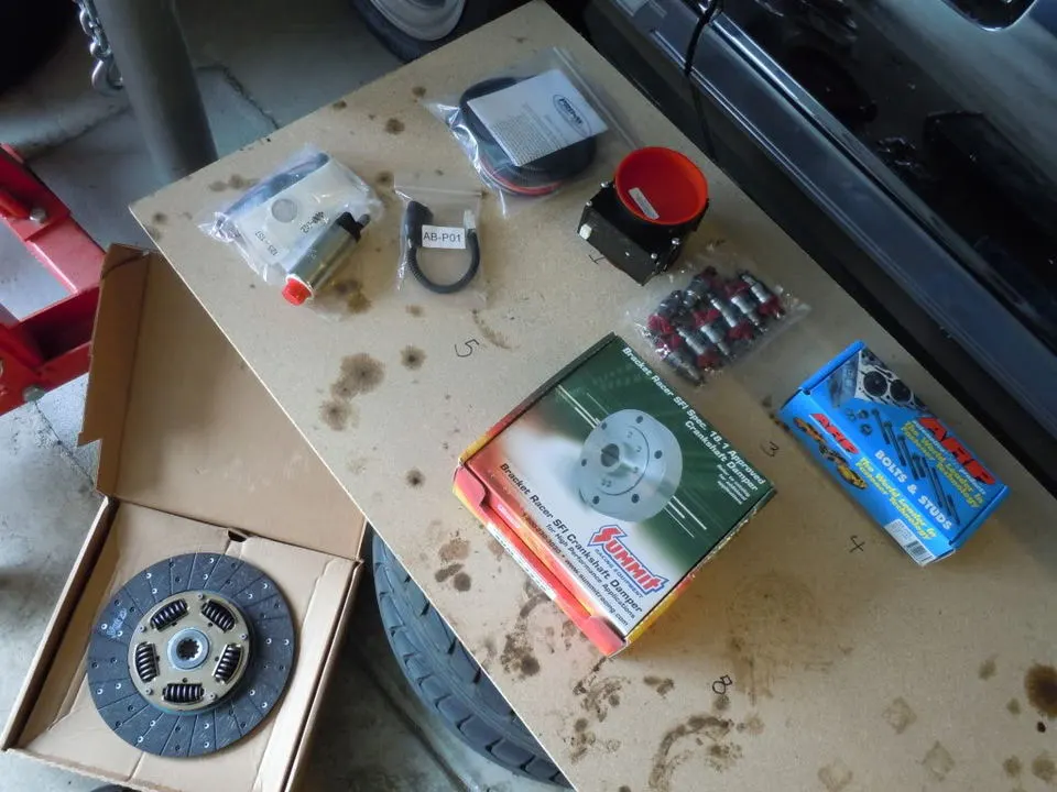

Not much for an update, since I'm still waiting on the top end parts. They *think* they'll ship out on Monday, so hopefully you guys will see the good toys next week.

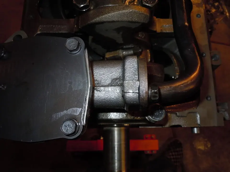

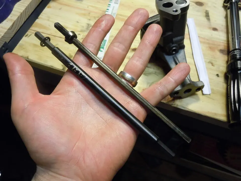

Anyway, here is a pic of the oil pump I broke (see the crack by the bolt):
The difference between the ARP oil pump shaft and the stocker, just for fun:
All the lonely toys waiting for a good home. You can see the 30lb injectors, the DBX97 MAF and the associated wiring, the 255lph Walbro fuel pump, ARP head bolts, SFI 18.1 balancer, and my new Ram clutch.
And lastly, a size comparison shot of the DBX 97 for your enjoyment:
BTW, Bell's Two Hearted Ale is #97 on BeerAdvocate's top 100 list right now. It's a very good beer for any IPA drinkers who have not tried it. Another Bell's product that is really good, but hard to come by (and is $18 for a sixer), is Hopslam. Oddly enough, it's #18.

I have that same balancer. Put timing tape on it or clear it. It will rust up quick.

looking good, the only thing better than having a pile of parts is putting them on the motor! and that arp pump shaft looks like a well made piece, i got the milodon one but yours looks better made.
Do you have the SFI unit or the OEM unit? This is the SFI one, and it's supposed to already have a baked enamel clearcoat. I looked at the OEM one and I saw that it had a bare finish.

which Ram clutch is that? I had the HDx in my old car and i liked it a lot. Picked up the ARP driveshaft too, much stronger than the full hex OEM one obviously. Looks like this things coming together pretty nicely... Hurry up
Yea, it's the HDX. I've heard good things, and it was time for a new clutch anyway. Anything has to be better than the old FRPP "Heavy Duty" clutch I had in there. Thing was stiff as hell!

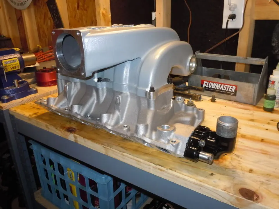

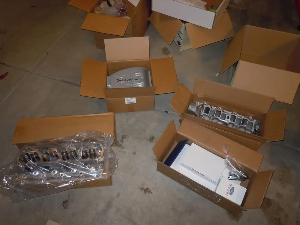

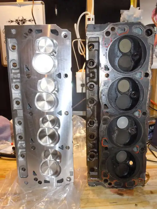

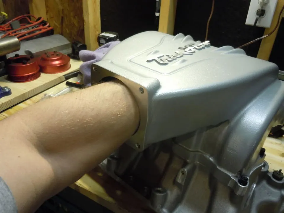

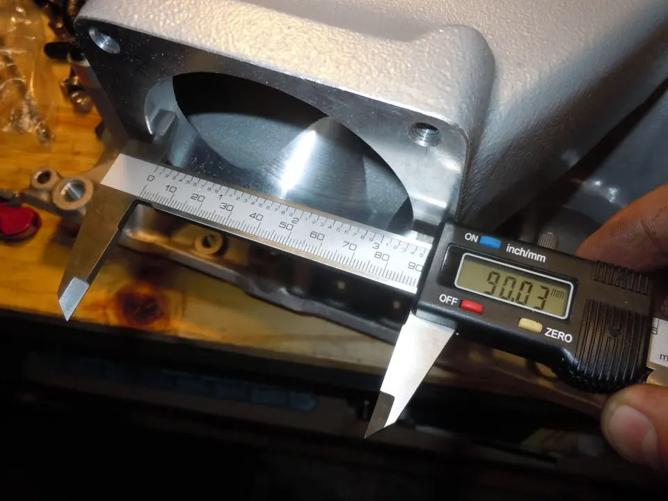

Time for a little update. The parts came in Thursday afternoon.
Well, most of the parts.
I'm not going to say a lot about it, because I'm trying not to dwell on it, but as you guys know, I ordered the parts 5 weeks ago. I was told 2 weeks. To clarify, the heads and intake came in 3 weeks late. The cam, the ONE thing I need to actually make some progress on assembling the engine, is not here yet. Supposed to come in Monday or Tuesday. I'm a little frustrated.
That's been my experience thus far with T.E.A. I can't say anything yet about the quality of their stuff, obviously, as I haven't put it together and ran it. It looks good.

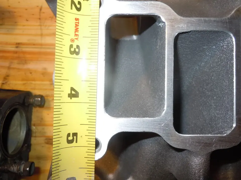

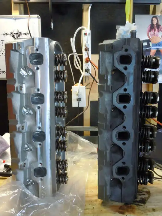

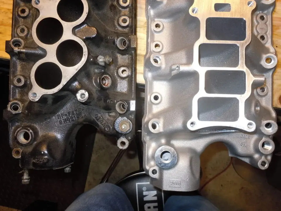

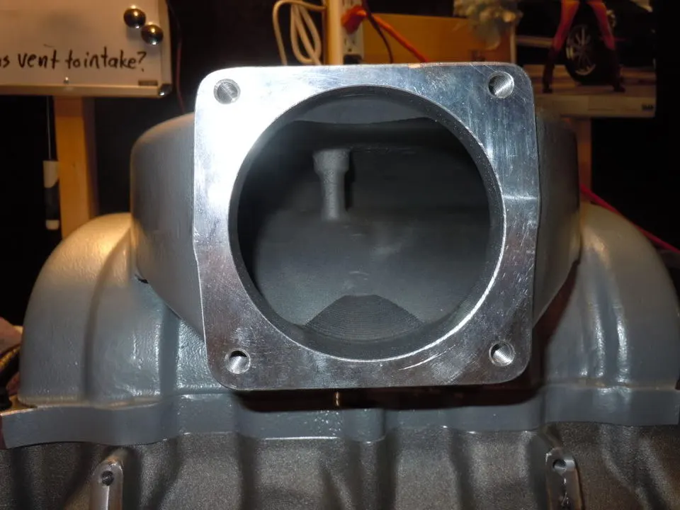

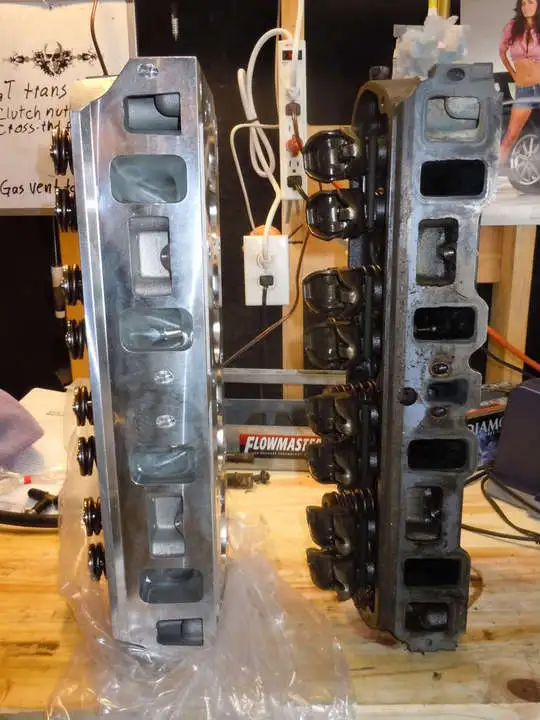

Anyway, below are some pics of the intake and heads. Just as a reminder, the intake is a TFS-R 90mm, CNC port matched to the heads, and the heads are TFS Twisted Wedge CNC 205s, milled to 61cc chambers. Oh, by the way, they flowed the heads (and charged me $50 for it, not sure I asked for that...). Here are the numbers:
Lift - Intake - Exhaust
.100 - 70.70 - 56.90
.200 - 148.9 - 106.8
.300 - 224.4 - 153.0
.400 - 274.0 - 195.8
.500 - 305.7 - 220.2
.550 - 314.7 - 230.8
.600 - 319.3 - 235.8
It doesn't say on the sheet, but I'm assuming that is on a 4" or a 4.030" bore. I have no idea what kind of pipe they ran on the exhaust.
Pics:

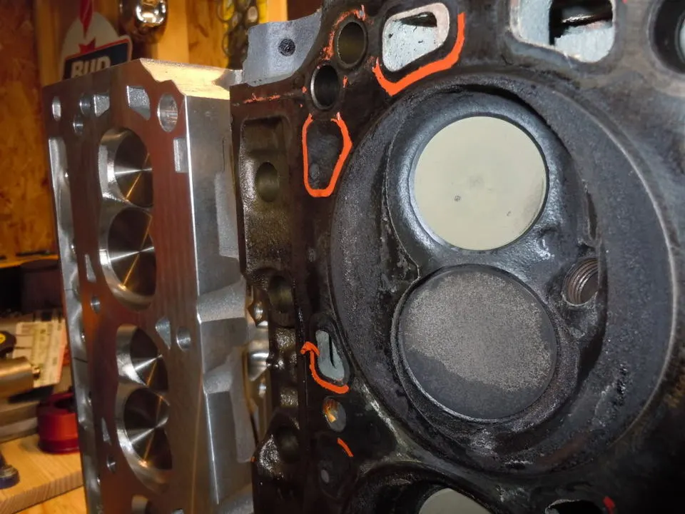

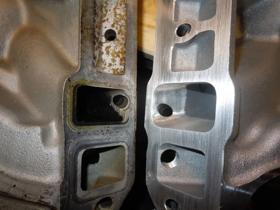

Tried to get a shot where you can clearly see the difference in chambers. Notice the shrouding on the stock valves, and also the rotation of the valves on the TWs versus the inline valves on the stock heads.

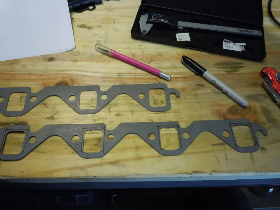

Stock header gaskets were way too small for the TW exhaust ports. Go figure! So, I'm going to try to trim them up a bit. You guys like my pink Exacto knife?
