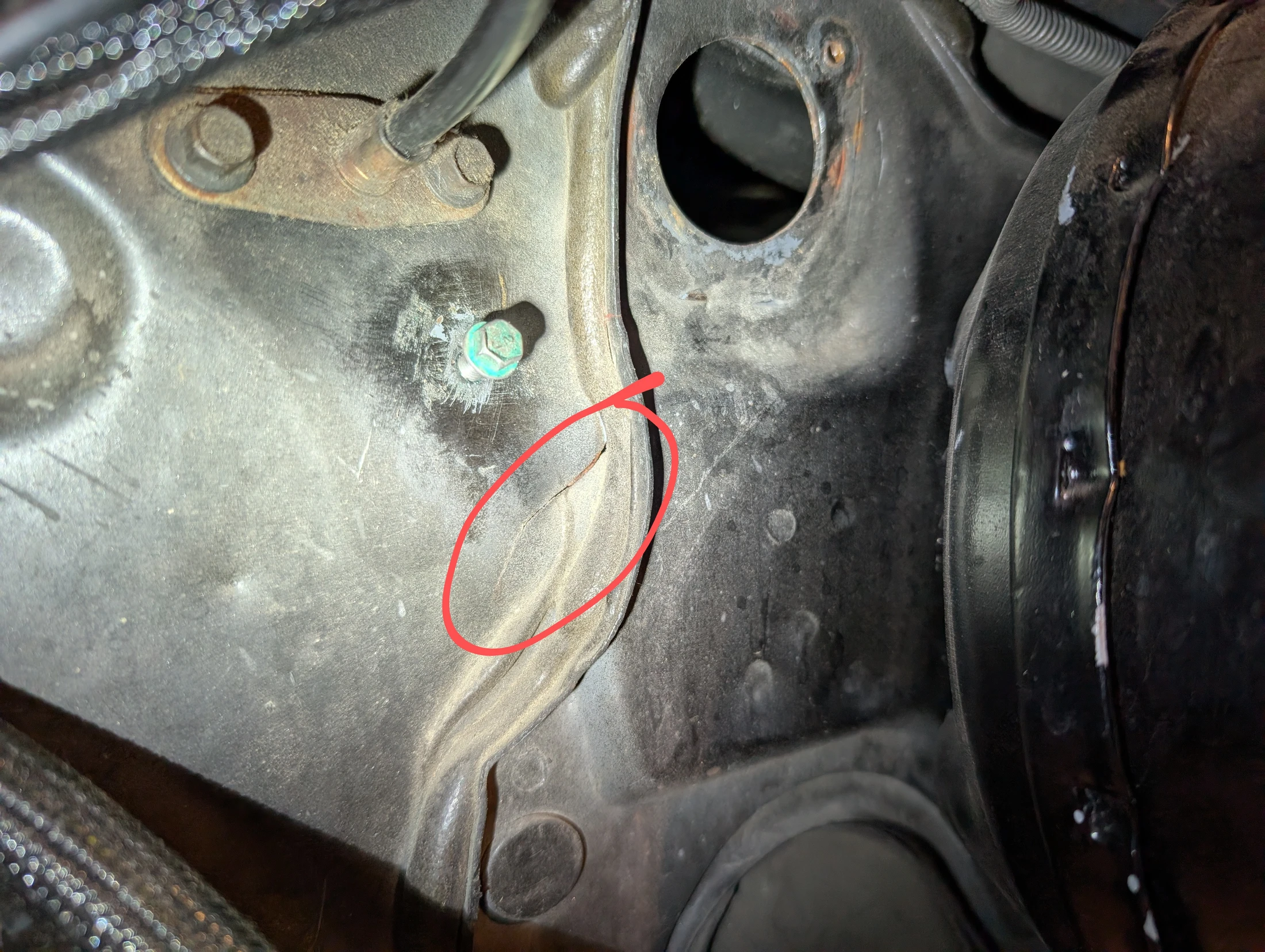

Here is why I follow LMR on YouTube. They do a great job producing what Fox guys need to keep these cars on the road. When they recently posted about their new firewall/clutch cable reinforcement bracket, I immediately checked my car, and sure enough, my firewall was cracked. I never knew this was even a thing on these cars. I have their reinforcement kit now and will be installing it before the engine goes back in.
