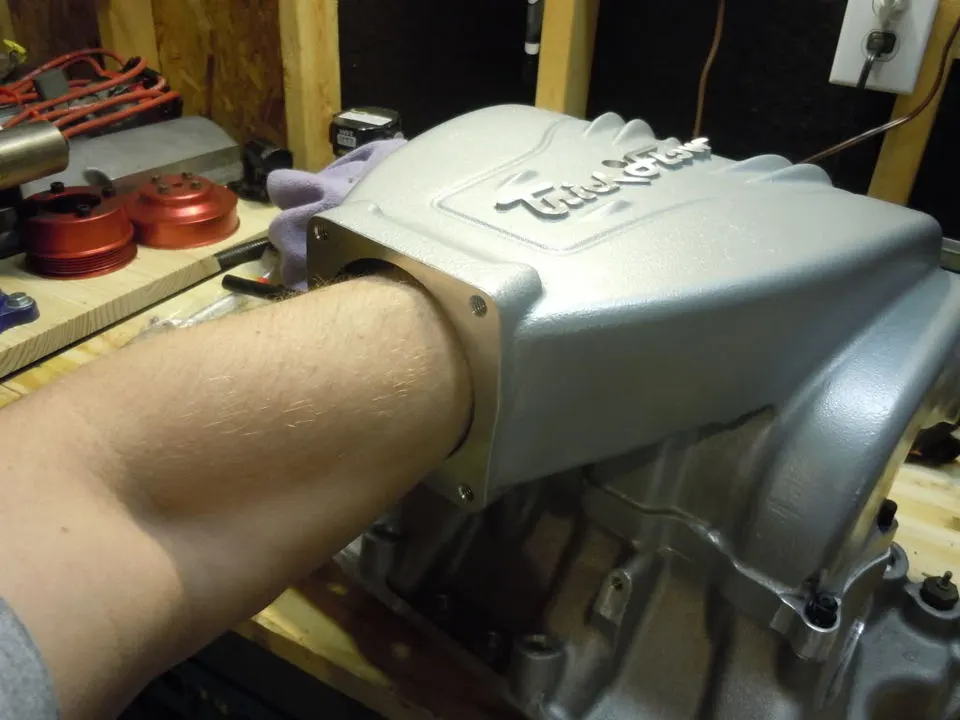

I think that the hole for your throttle body can swallow your arm is impressive. Doesn't matter what color your exacto knife is as long as it works.

Nice pics. Kind of sucks that TEA is dicking you around. If a company commits to a 2 week window they should honor their commitment IMHO. 5 weeks is not even close. Our power as a community is to not accept crap service like that.

NikwoaC said:
Time for a little update. The parts came in Thursday afternoon.
Well, most of the parts.
I'm not going to say a lot about it, because I'm trying not to dwell on it, but as you guys know, I ordered the parts 5 weeks ago. I was told 2 weeks. To clarify, the heads and intake came in 3 weeks late. The cam, the ONE thing I need to actually make some progress on assembling the engine, is not here yet. Supposed to come in Monday or Tuesday. I'm a little frustrated.
That's been my experience thus far with T.E.A. I can't say anything yet about the quality of their stuff, obviously, as I haven't put it together and ran it. It looks good.
Anyway, below are some pics of the intake and heads. Just as a reminder, the intake is a TFS-R 90mm, CNC port matched to the heads, and the heads are TFS Twisted Wedge CNC 205s, milled to 61cc chambers. Oh, by the way, they flowed the heads (and charged me $50 for it, not sure I asked for that...). Here are the numbers:
Lift - Intake - Exhaust
.100 - 70.70 - 56.90
.200 - 148.9 - 106.8
.300 - 224.4 - 153.0
.400 - 274.0 - 195.8
.500 - 305.7 - 220.2
.550 - 314.7 - 230.8
.600 - 319.3 - 235.8
It doesn't say on the sheet, but I'm assuming that is on a 4" or a 4.030" bore. I have no idea what kind of pipe they ran on the exhaust.
Pics:
Tried to get a shot where you can clearly see the difference in chambers. Notice the shrouding on the stock valves, and also the rotation of the valves on the TWs versus the inline valves on the stock heads.
Stock header gaskets were way too small for the TW exhaust ports. Go figure! So, I'm going to try to trim them up a bit. You guys like my pink Exacto knife?
You has a small arm

You has a small arm
That's not what your mom said.
Wait, what?
