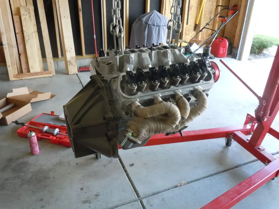

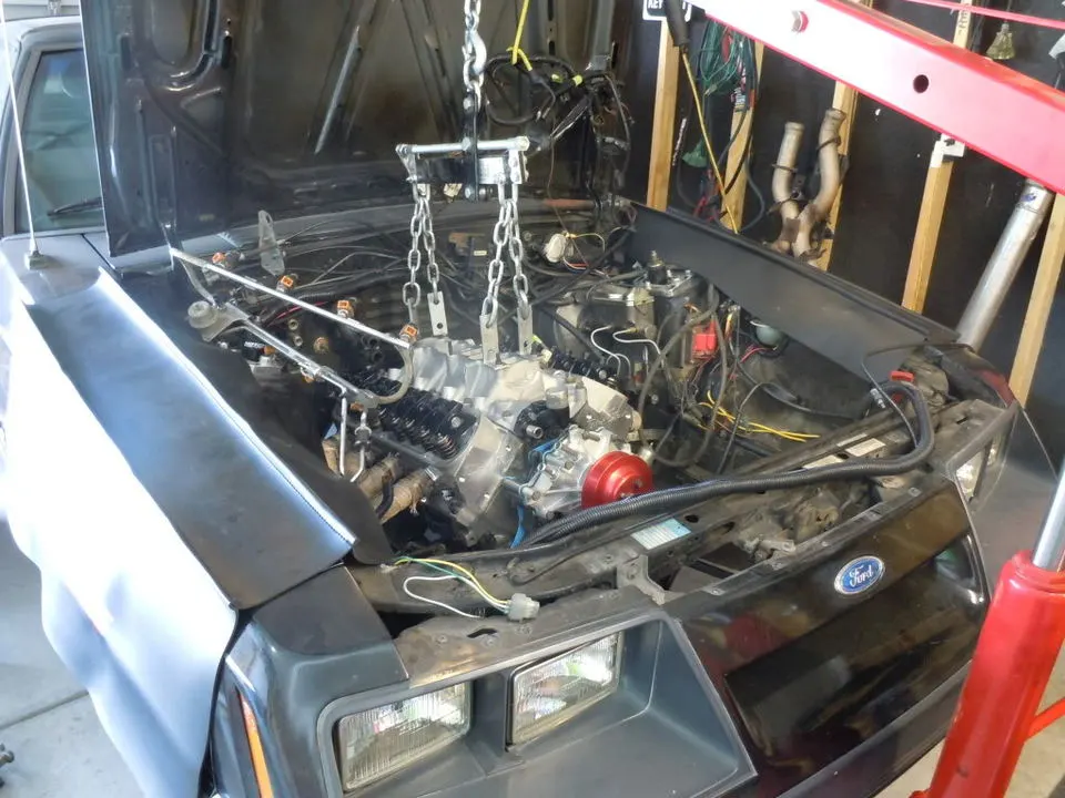

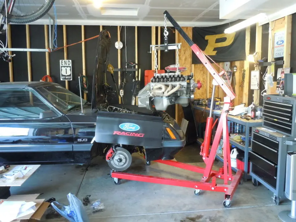

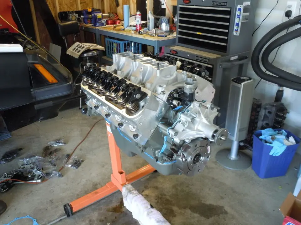

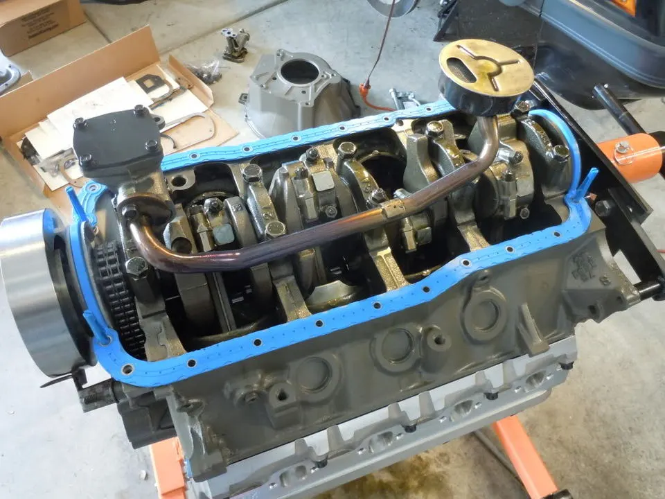

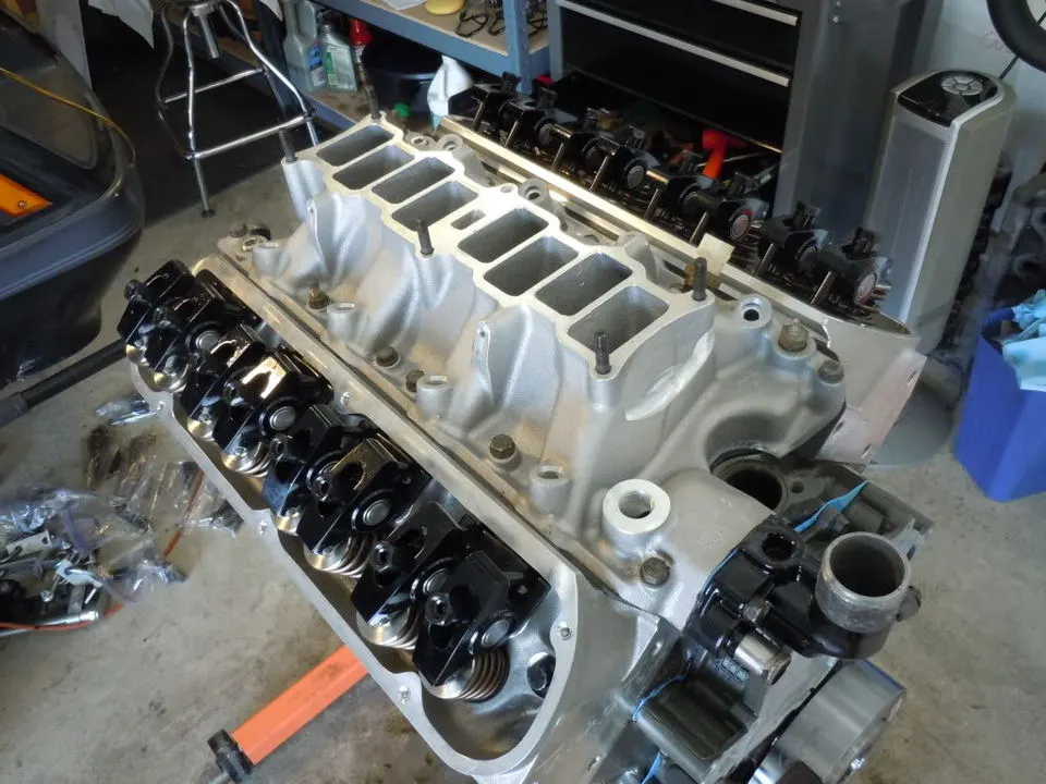

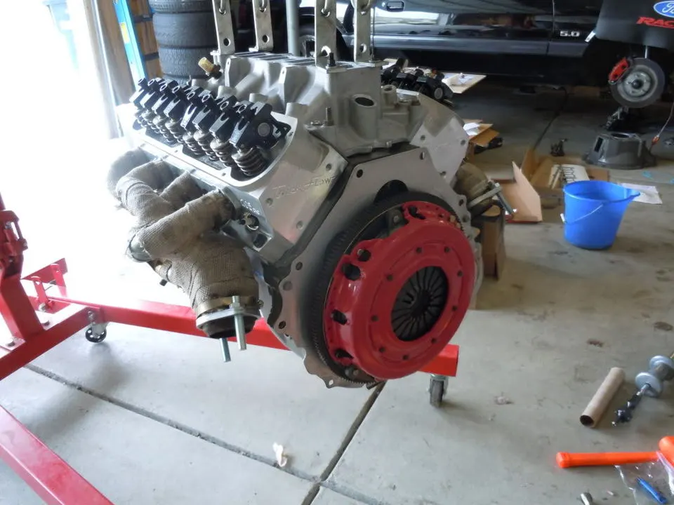

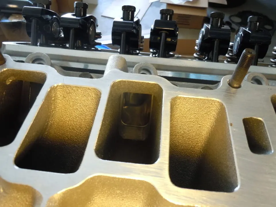

Dudes, I'm exhausted. I worked on the car from 9am to 6pm SOLID, without stopping, both Friday AND today. I wish I could say it was running, but you know how it is, little **** always turns into big **** and then before you know it, you've wasted 2 hours pounding axle grease into a hole. But, I did get the engine in the car, at least. Heer iz de pix.

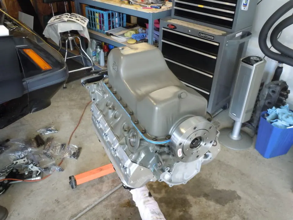

*Gay voice* Fancy fancy one piece pan gasket. Oooh.

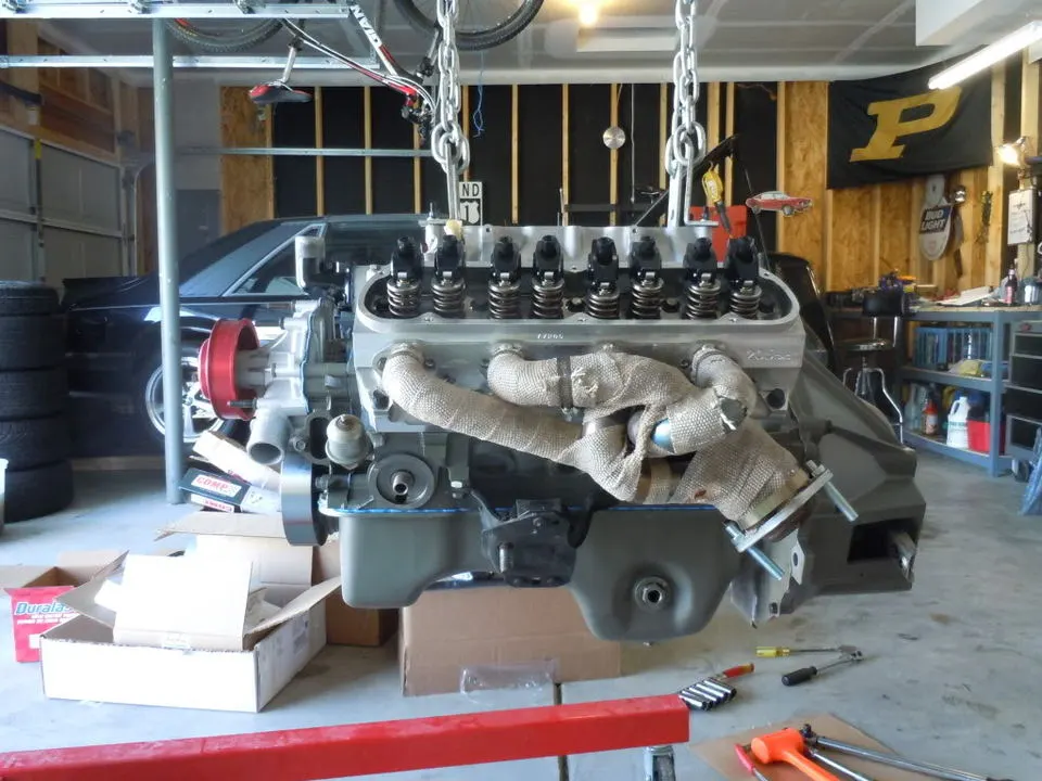

Tried to get a shot down the intake and into the head. It's pretty cool in person. That's a big ass port!

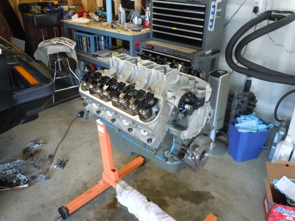

Water pump on.

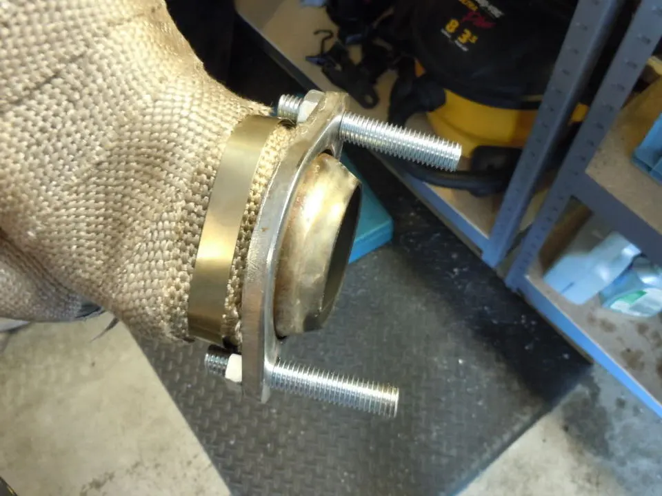

Somewhere over the years, I mistook the threads on the header studs for 1/2-13, and so I was using 1/2 nuts, when they were really M12 studs. So I was slowly raping the threads every time I R&Red the exhaust. SO, I finally spent some time replacing the studs, using some all thread and a jam nut. I just went with 1/2-13 all thread, which required redrilling and threading the M12 threads in the header flange. This was one of those activities that should have taken 30 minutes, but ended up being 2 hours when I couldn't get one of the old studs out.
Flywheel/clutch on.

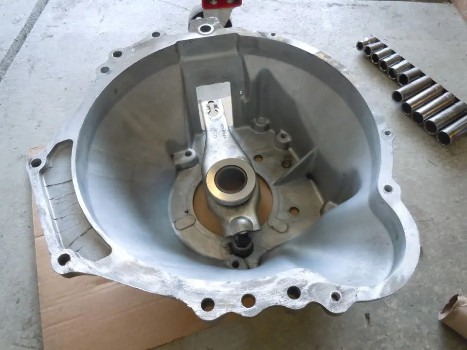

Assembled bell housing.
Bell housing on.
Going...
Going...
Gone!

Nice job? Doing this alone?

Mustang5L5 said:
Once job? Doing this alone?
Yea, I prefer to work alone, actually. I spend too much time talking and not enough working when I have "help". That, and, I have my own little obsessive way of doing things, and I think I would drive most people crazy if they tried to spend a day working with me.

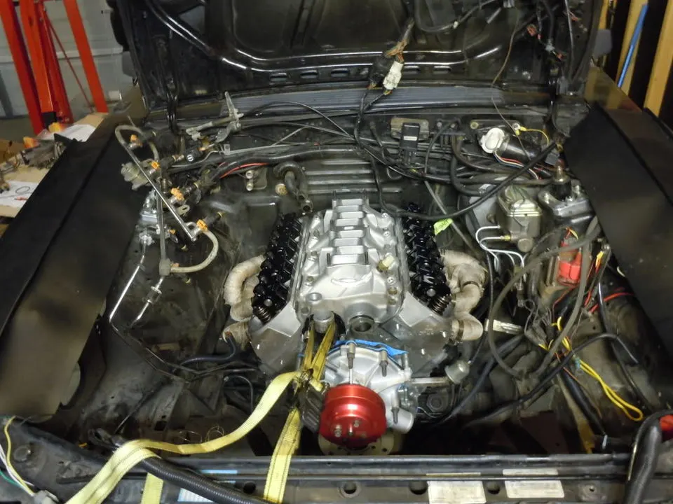

what were you using the tie down strap for? that's a helluva tool to change a thermostat
Well, that damn silicone was really stuck...
Haha, kidding. The engine is just sitting on the mounts, and since it doesn't have any of the front dress on it, it's unbalanced and wants to lean back and sit against the firewall. It doesn't have the trans and cross member in it to hold it in place, so I had to improvise.
