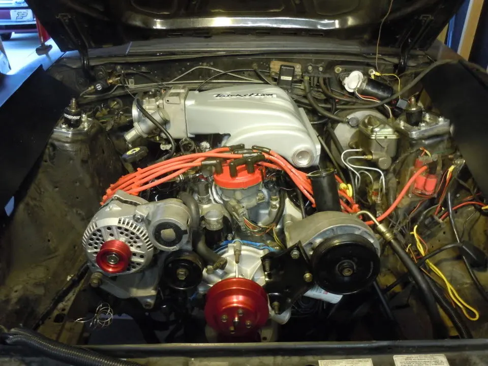

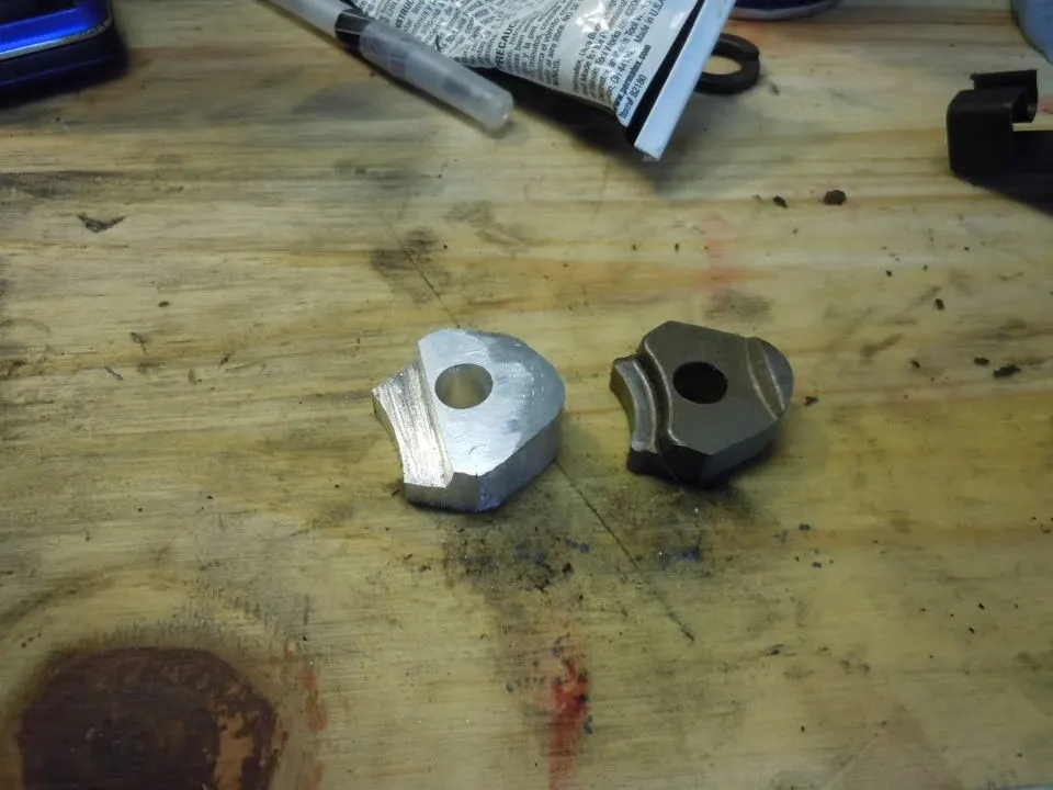

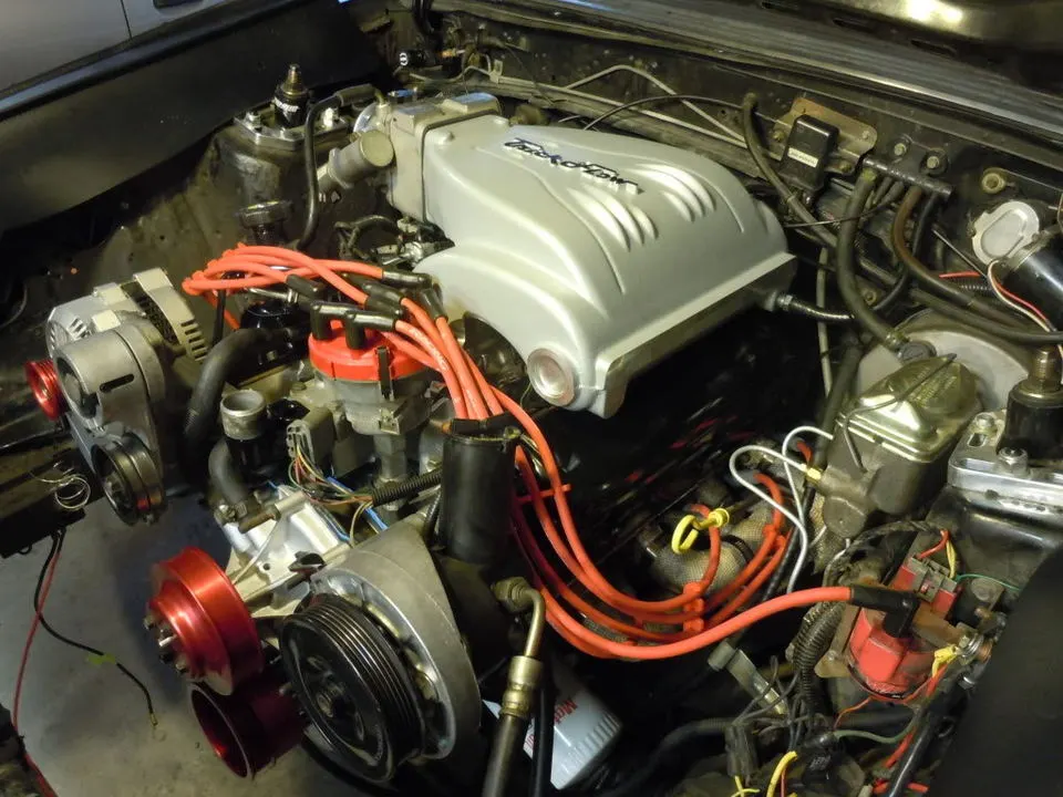

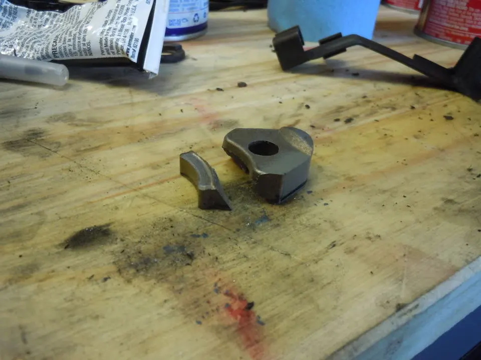

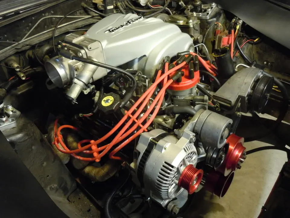

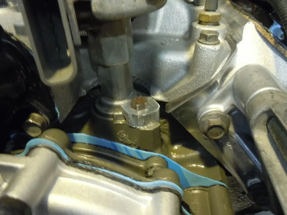

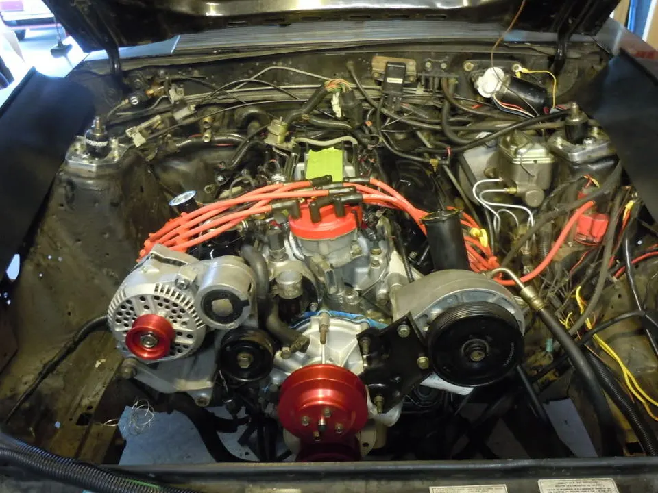

Updaaaaaaaaaaaaaaaaaaaaaaaaaaaaaaaaaaaaaaaaaaaaate!
It's been a while, but I actually have been working on the car. Just have been doing a lot of boring stuff not worth posting pics of, like degreasing and installing accessory brackets. Yawn!
Well yesterday, I finally had some stuff worth taking pics of. The first couple items on the list are a little hillbilly, so be forewarned.

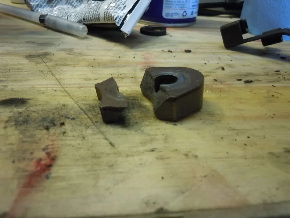

1. Went to stab the distributor and broke the hold down clamp. I'm incapable of doing anything gently, and my wife reminded me of that when I showed her the carnage. Rather than take an hour round trip to the pull-a-part, I spent 30 minutes hacking a new one out of a chunk of aluminum. Made sense at the time. It's temporary until I get another "real" one, but it does work. I can't turn the distributor with my hands while it's clamped down.

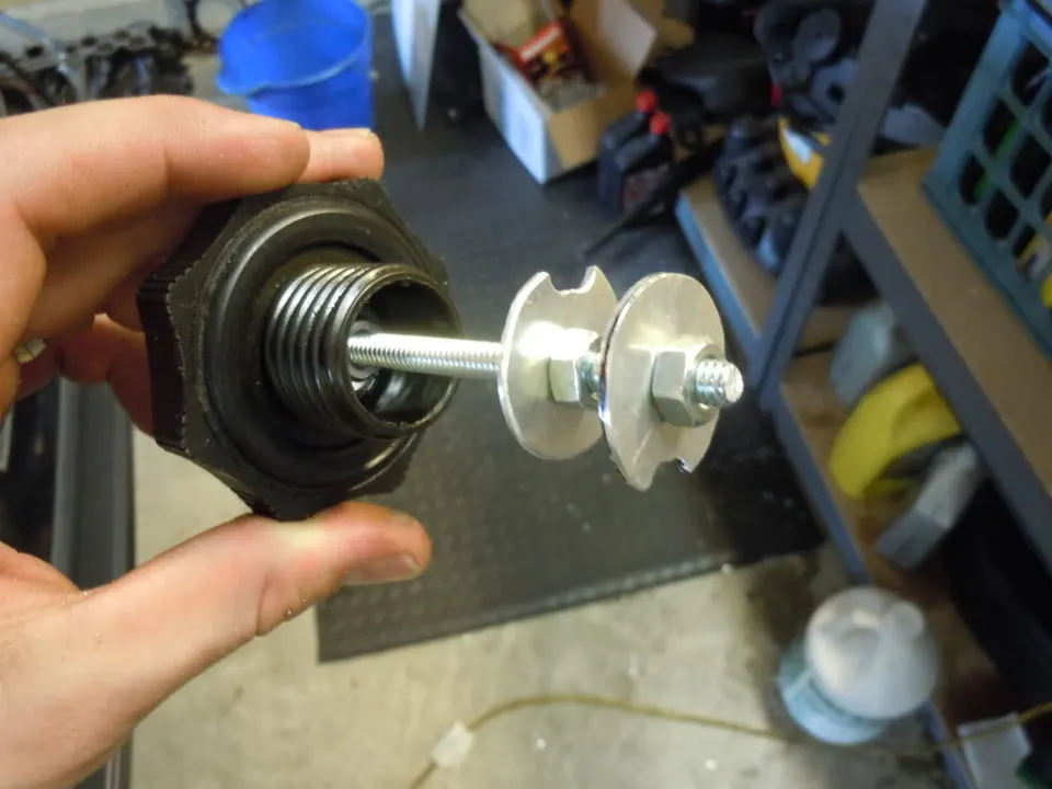

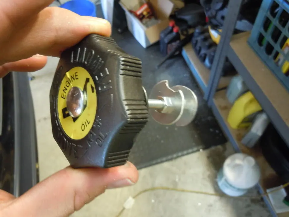

2. This is hillbilly item #2. If you remember from a few pages back, I had to "remove" the oil baffle in the valve cover to clear the roller rockers. Therefore, I needed a device to block oil spray from finding its way up into the vent line that runs to the throttle body. This is my solution, though I'm not 100% confident it will work. I guess I'll find out. It is just a couple of plates that will act as baffles once you screw in the oil fill cap. The notches cut in them are for clearance as it passes the vent tube in the oil filler neck. (Patent pending... )

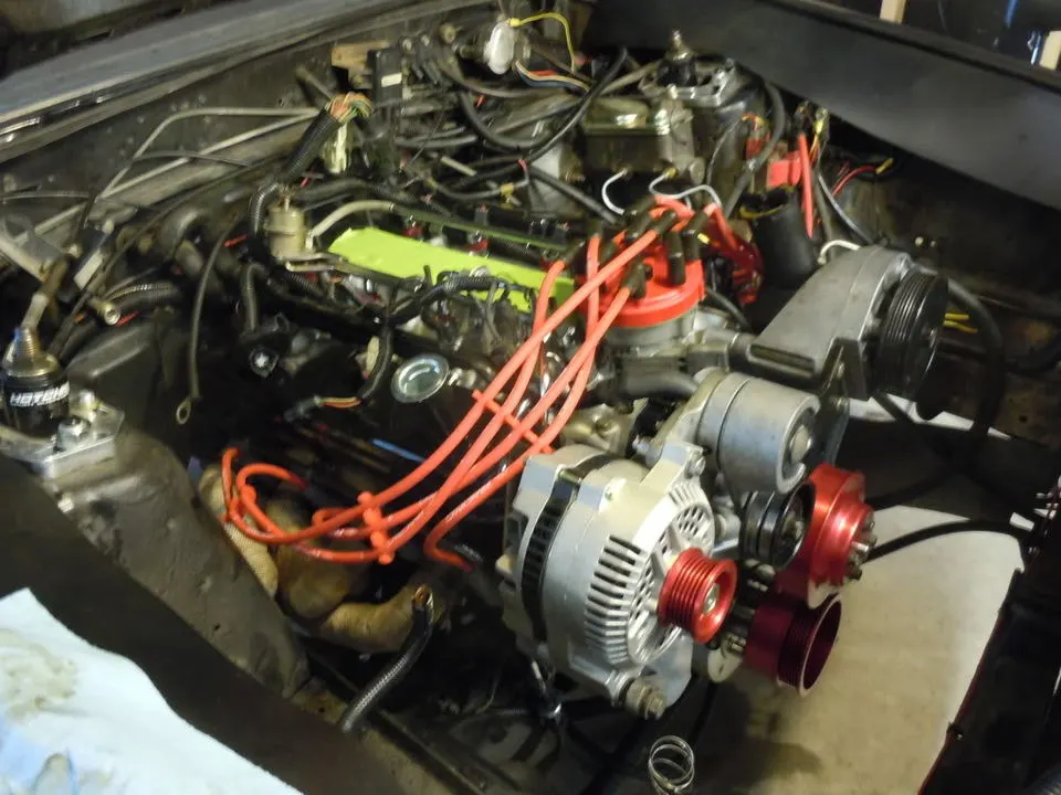

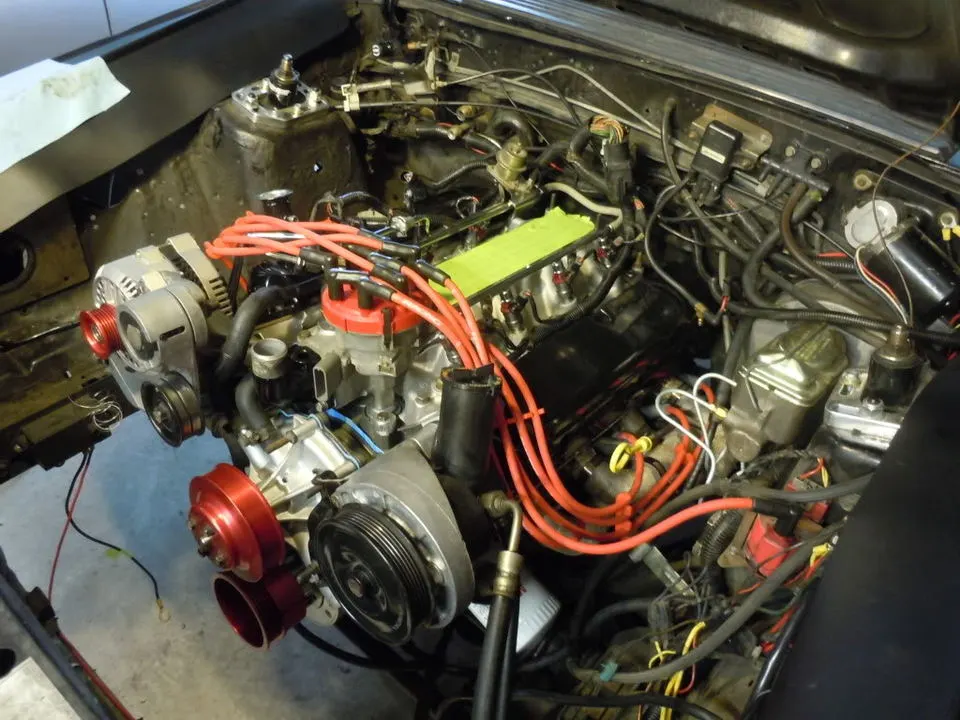

OK, the rest of the pics are just of the engine bay assembly. Enjoy!
