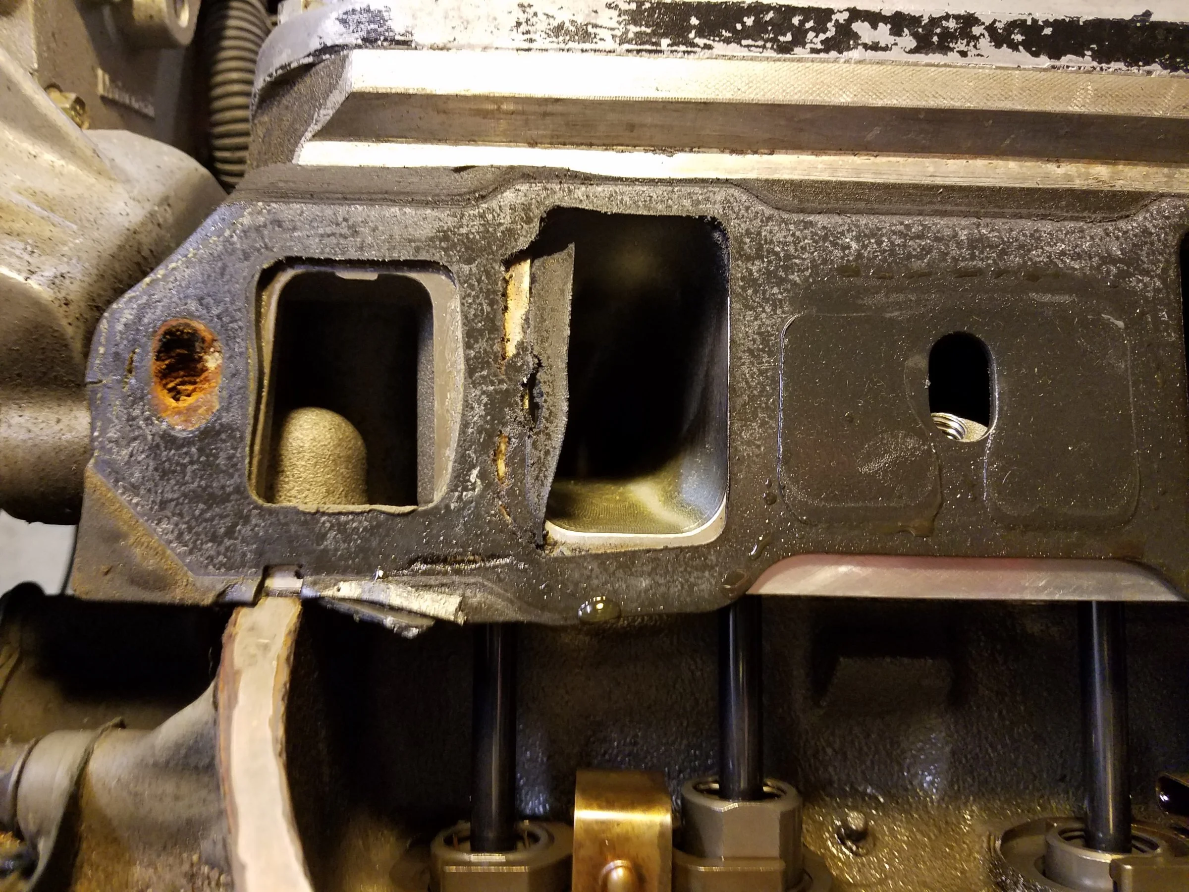

It really does seem like it was over tightened.

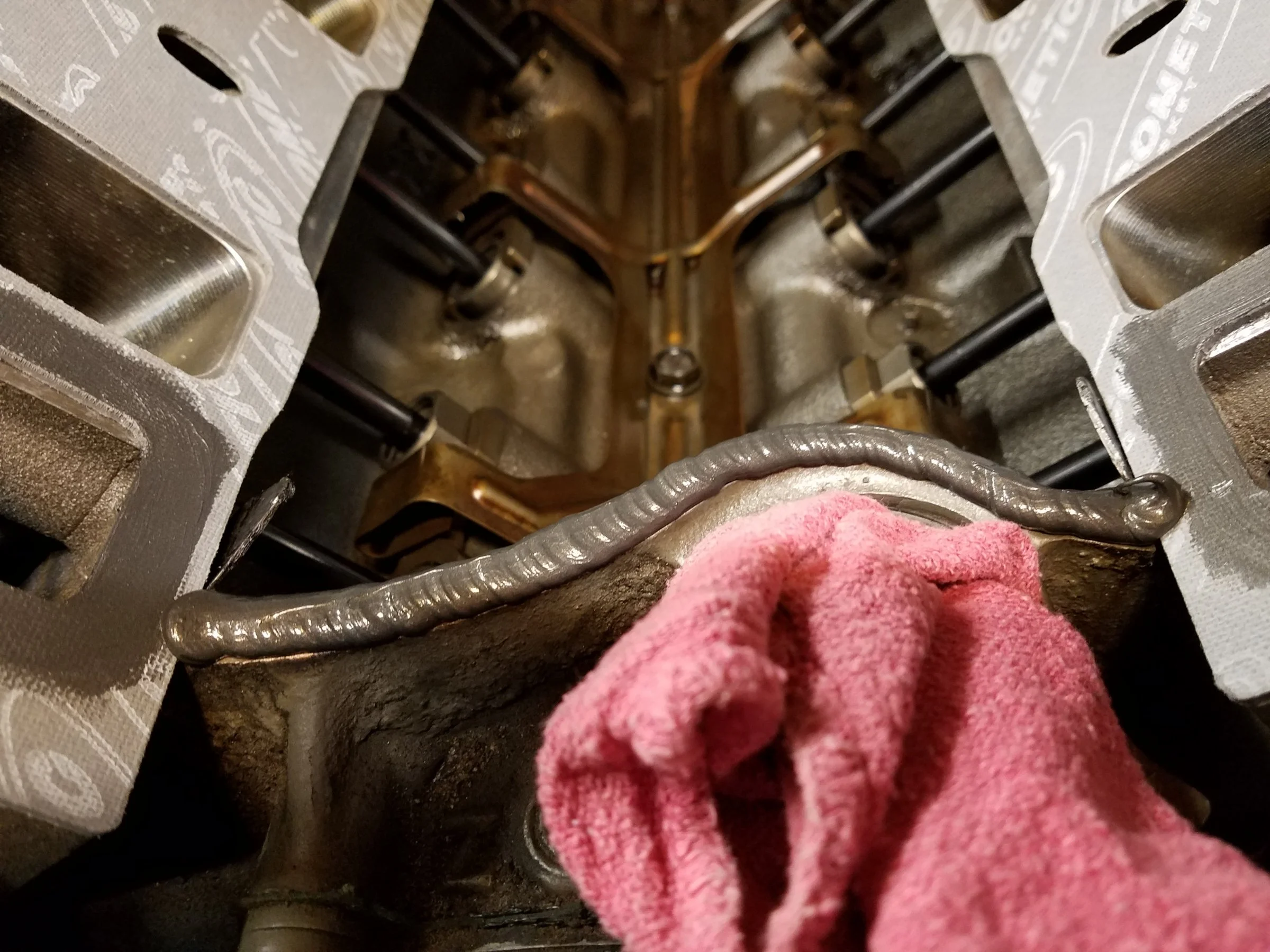

You can't see it in these pictures, but the only places where the gasket was compromised was around the water ports at each end of each cylinder head. The rest of the gasket around all the intake ports looks perfect.
It almost looks like the pressure in the cooling system was slowly pushing the gasket out, and maybe the vacuum in the intake port was helping it along. The gasket material looked like it was deteriorating.
Probably not coincidentally, those 4 outer bolts had rusted pretty badly. If anything I may have lost some clamp load and that allowed the gasket to squirm.

NIKwoaC said:
Ha, you guys are talking to the guy who uses his torque wrench to build IKEA furniture.
I think you need to have the intake manifold mating surface checked for its deck smoothness/warpage. While I'm not completely sure, I was thinking that the 4 outer ends of the manifold can pull tighter than the middle does. A 20ft lb pull on the outside corners equates to more squish than in the middle.
Just a thought.

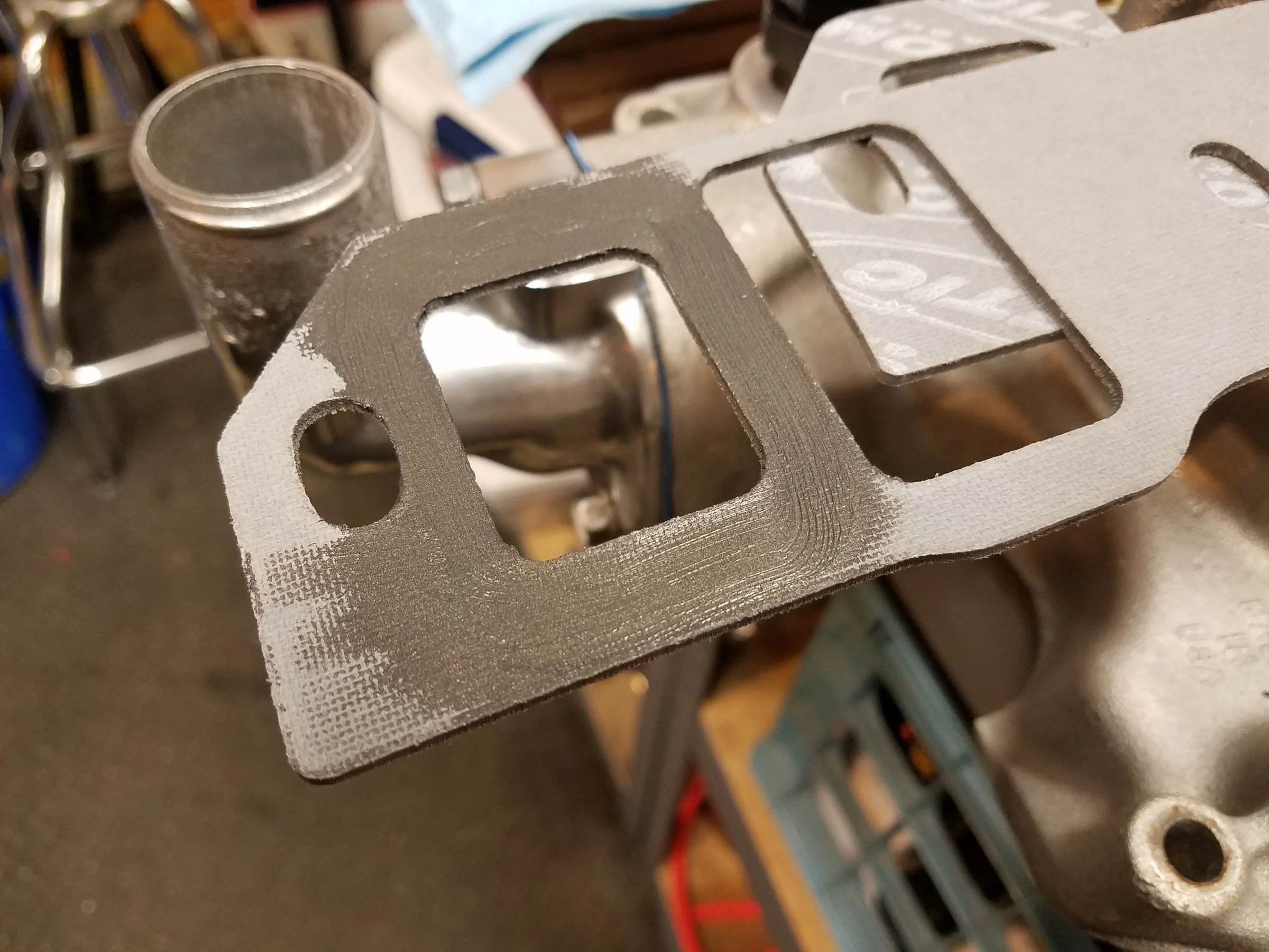

I havent used any of that stuff so i really have no opinion on it. $30 for each gasket is a little steep but Ed's gotta eat too. Since you are the type of guy who would probably be into this, ill tell you what i did...
I didnt want to buy an off the shelf gasket for my highports and deal with cutting a gasket up every time i have the intake manifold off, dealing with oversized water ports etc... So after telling my engine builder, he suggested calling cometic and seeing what a custom set would run me. So i called cometic up, and they gave me a rough estimate price wise, which seemed more than reasonable for a gasket that was 100% custom for me. I made a paper template, sent it off to them and within a couple weeks they called me to ask what material and thickness i wanted. I want to say the gaskets were like 12 or 15 bucks each, and they fit perfect. I would suggest if you go this route to oval out the holes for where the intake bolts are.
I also made an exhaust template after seeing how good the intake ones came out.
I have heard of cometic's custom gasket service, it sounds like an awesome option...
Just a thought.
That's a good call. I can probably do it in the lab at work actually.

If heads have been decked much that can throw off the geometry of the head to intake mating faces. So ive been told. Ive never saw it happen.

the state of your current gaskets is fairly common with all the older felpro gaskets (1250, 1262, 1262r etc). remember that they were designed for racing applications 40+ years ago with iron heads (iron distorts way less when hot compared to aluminum).
the 1250 and 1262 have been updated to the -s3 version, which is a steel cored, fiber gasket with printed rubber. much better on the durability, but the 1262r has been neglected.
the oem-replacement felpros are a steel core rubber (or silicon). these are the best for durability but are sized for the small iron e7 heads (though i used them on my old gt40p setup, just barely big enough for that).
fwiw, except for a quick mist of spray on low-tack gasket adhesive if they're being stubborn on alignment, i install these things dry and havent had an issue. you want your mating surfaces as clean, smooth, and dry as you can get. rtv of your choice on china walls, and use studs in the corners to guide the intake on. torque to 25 following the sequence twice, wait a half hour or more, and do the pattern again, and let dry for overnight or two before filling fluids.
Just a thought.
that is why there is a torque sequence.

@90lxcoupe
Alright, after reading horror story after horror story on the internets about Fel-Pro 1262-style gaskets failing, I convinced myself to call up Cometic and inquire about a custom set. All you have to do is ask them for a 1262R substitute and they know exactly what you're talking about- they already have the pattern. I went with the aramid fiber (kevlar) @ .094 thickness, for no other reason than it's close to the .090" thickness of the 1262R and that seemed to work for me.
He quoted me $13something over the phone, each. Incredibly reasonable pricing.
Their lead time is 4 days, which again, seems very reasonable for a custom gasket, but it does mean the car is going to have to sit a while longer... Oh well.

Ah but if you coated the threads for the water-jacket bolts, it will change your torque value. Some of that stuff is pretty "slickery".

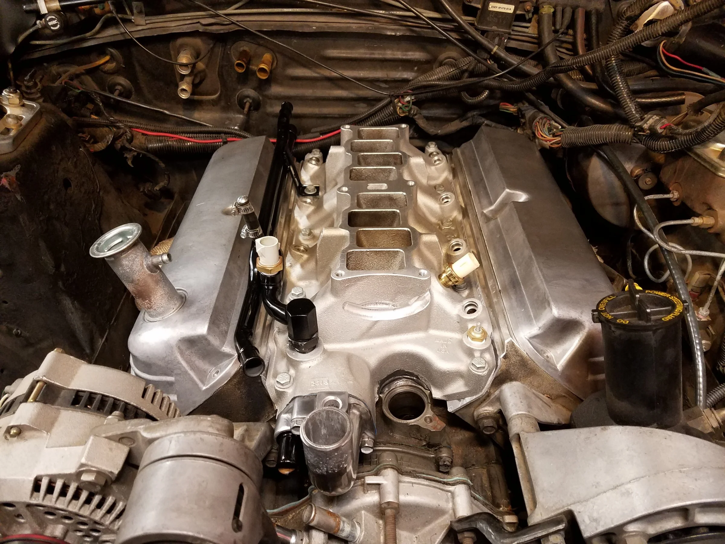

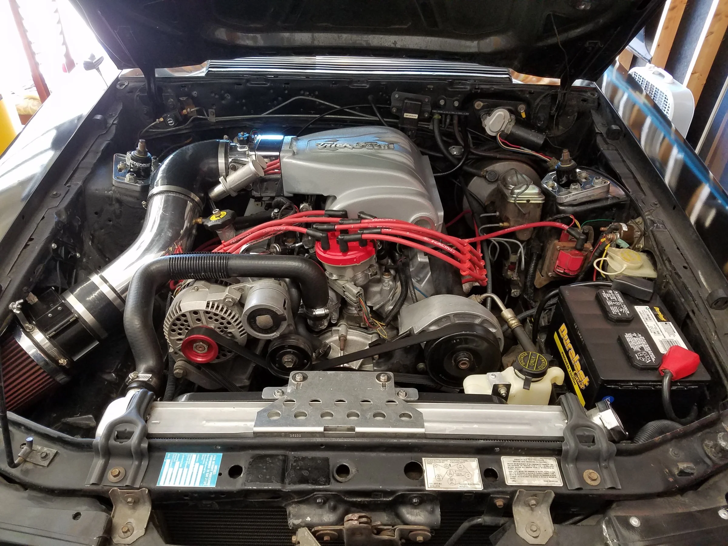

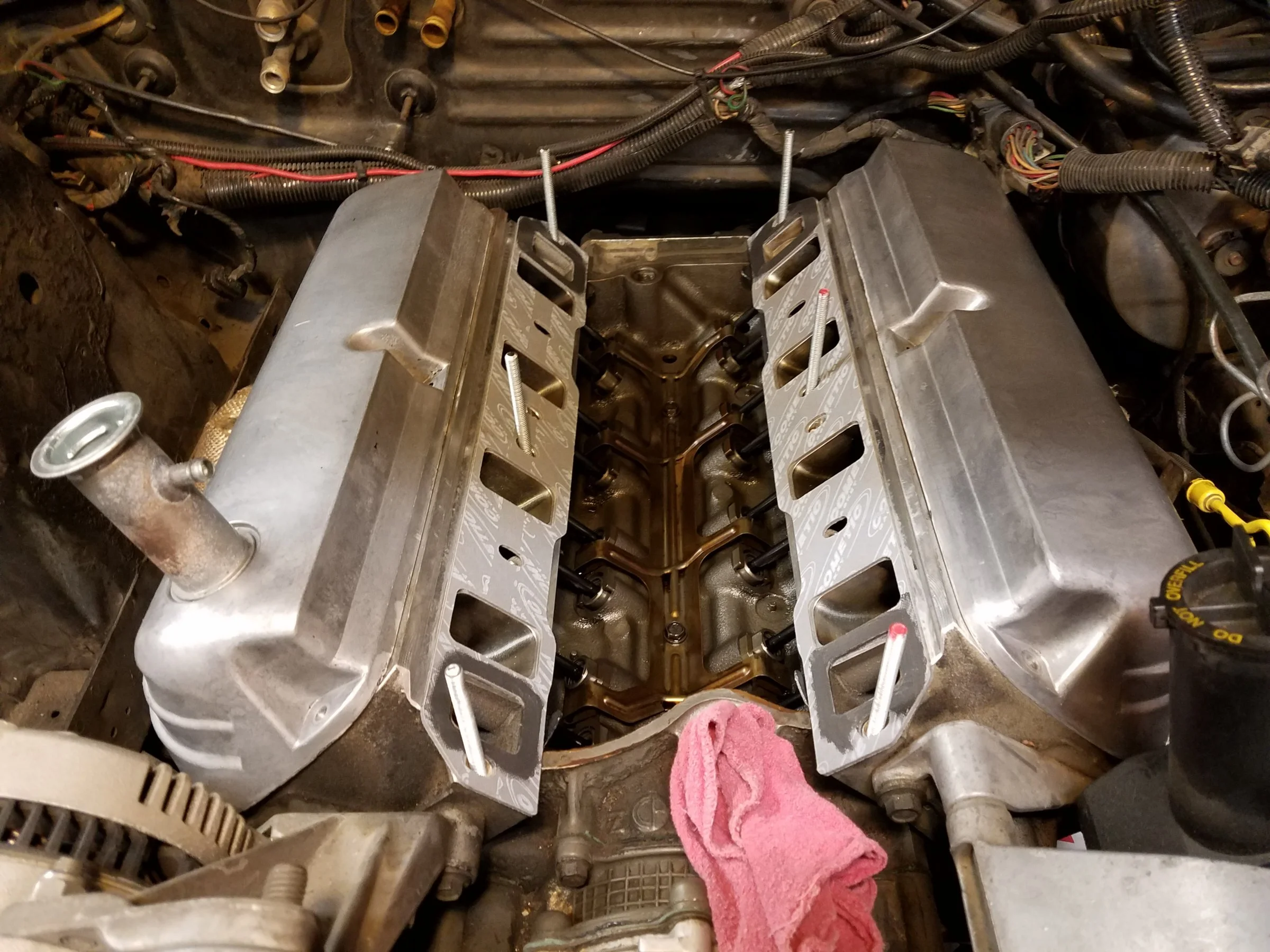

Some reassembly pics, because why not? This actually took place weeks ago, I've been driving the car.
Super thin coat of black RTV around the water ports for good measure.
Yea I know, that oil fill neck is ugly. The valve covers used to be rattle can black, I've stripped them and this winter they are going to be refinished and powdercoated. In the mean time they're just bare and ugly.
Fast forward to fully assembled. Sorry, I know my engine bay isn't as pretty as some of the cars around here... Maybe someday. I actually did do a little bit of degreasing, bracket painting, and a little more wire tucking before this shot, but in general it has a long way to go IMO.
