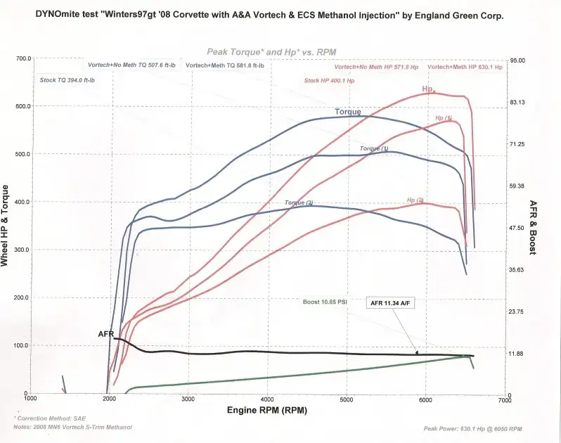

This is what meth did for me. I am completely hooked on the stuff. I know exactly how much throttle to add to get in to boost without using any meth. Mine is set at like 4psi but also has to do with how far I push down on the gas, and I have a bit of timing I could have added to get another 10-20hp. I gained 5mph at the track with it. I also only added .5 pounds of boost. With 3psi and meth, I'd guess you would pick up 50-60rwhp(Im winters"97gt" on other sites)
I was a big skeptic and scared of all the "what ifs" before I added the system. Not anymore. If the motor blows, it is my fault for not making sure the green light in front of my face was on for the meth, or it was just time. I feel that meth is a win/win for me.

Crazy numbers, man. Why did the other guy gain over 100 hp vs. your 60 hp? Intercooler?

He has a little more efficient blower than me, and he cranked up the boost and meth. Guy is nuts. He self tuned his car at the shop I use, and the owner told him that he had "big brass ones" when he was on the dyno. The car is still in one peice and is a beast.
