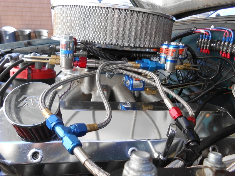

It all works now. Each kit can be fired independently or together.
Reactions: Davedacarpainter, A5literMan, Combat Medic and 3 others

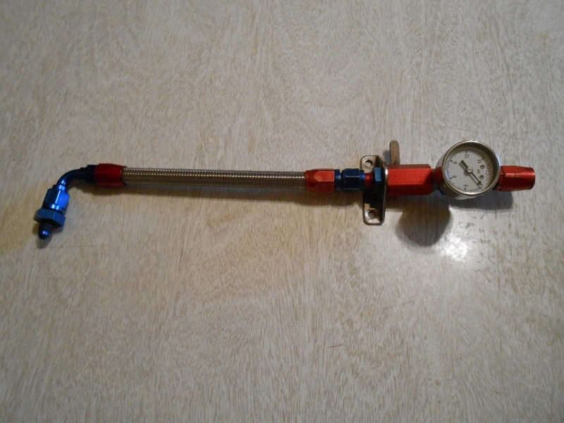

Nitrous Outlet stand alone with adjustable low pressure switch.
Reactions: 90sickfox and General karthief

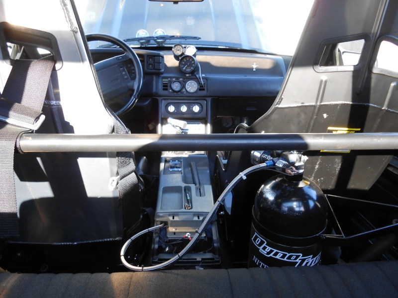

Ignition box,retards,controller
Reactions: A5literMan, 90sickfox and General karthief

2 kits?
I would still love to see a full break down of this engine/build. Is it a grudge type car?

Yes 2 kits. Pump gas street car.
Dart block 427 11-1,tfs 20511r heads.
Drive it all day h/r cam. fti ported super vic.
950 quick fuel,black magic. 1.75 headers,
3.00 exhaust. t56 with 2.66 first,mcleod
twin disc. spool.
Next test hit will be around 200 total,first kit window switch and wot switch.
2nd kit, window,button on the shift handle. Radio cd player.
Reactions: A5literMan, RaggedGT, 90sickfox and 1 other person

Borrowed a flow tool. Will set pressure and start pulling fuel jet out.
Reactions: A5literMan and RangerJoe
