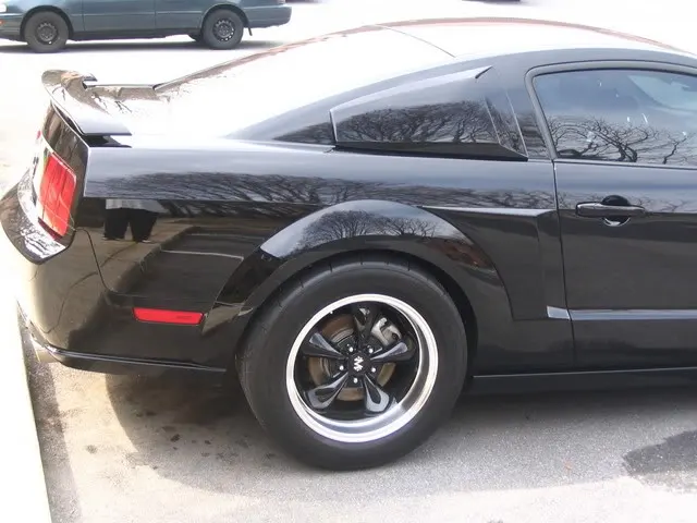

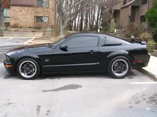

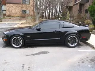

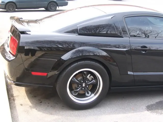

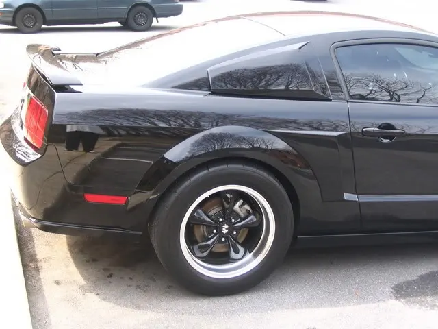

I have the Nitto 555 DRs 305/45/18s they are on 18 by 10 DD chrome bullitts. My car is lowered 1.5". It looks awesome, fills the wheel well out very nicely. I have never had an issue with rubbing.
got any pics? i am not concerned they are taller than stock, actually prefer it myself. i used to run BFG DR's on my old 92 coupe 275/60/15 and they filled up the wheel well nicely...
What's been keeping me from buying them is I don't want the ass end of the car to looked jacked up at all do to the taller tires. Any pics on a level surface?
The 305/45/18's are perfect. I thought you were going to go with them anthony05. I have them and they rock.

man, those do look sweet...i just ordered 295/45/18's for my wife's car. we are running 9" wide rear wheels, they should be ok on them, right? Nitto's run smaller than most tires, or so i have read...it's too late now, so hopefully they will work out nicely...
