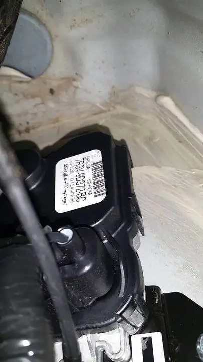

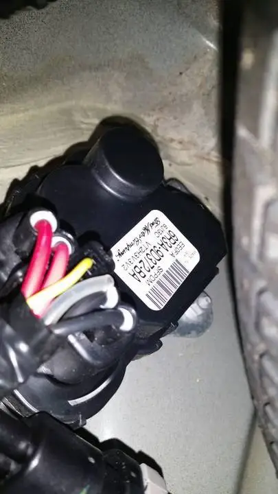

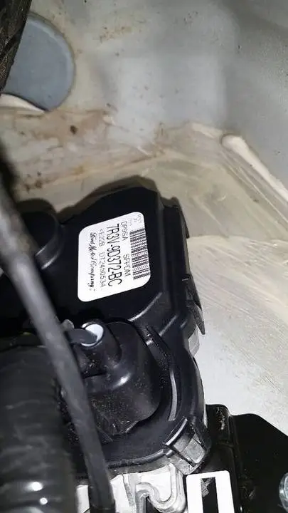

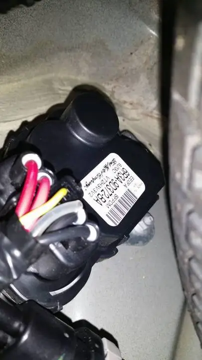

The GT500 fuel pump system adds a second FPDM (Fuel Pump Driver module). Look in the trunk in the spar tire well for two black boxes with wiring running forward towards the back seat where the fuel pump connections are. If you only have one FPDM, you don't have a true GT500 fuel pump system.

Thanks for the info! I just checked and I do have 2 of them.
I hate to pay what Roush is going to charge, but I think I need to have them look at it.
