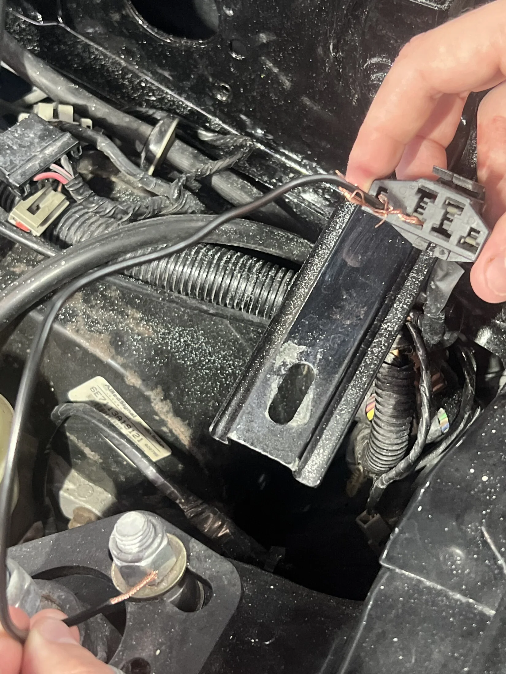

I took my car to get painted and it ran great. Now I got it back and the fuel pump is not working… Any tips on how I can trouble shoot my way to finding the problem? I did a wire tuck so the pump relay and all those wires are all pretty hard to get to now. However I took the front bumper off and reached inside the fender where I hid the relay and I feel and hear it clicking. What else can I check?

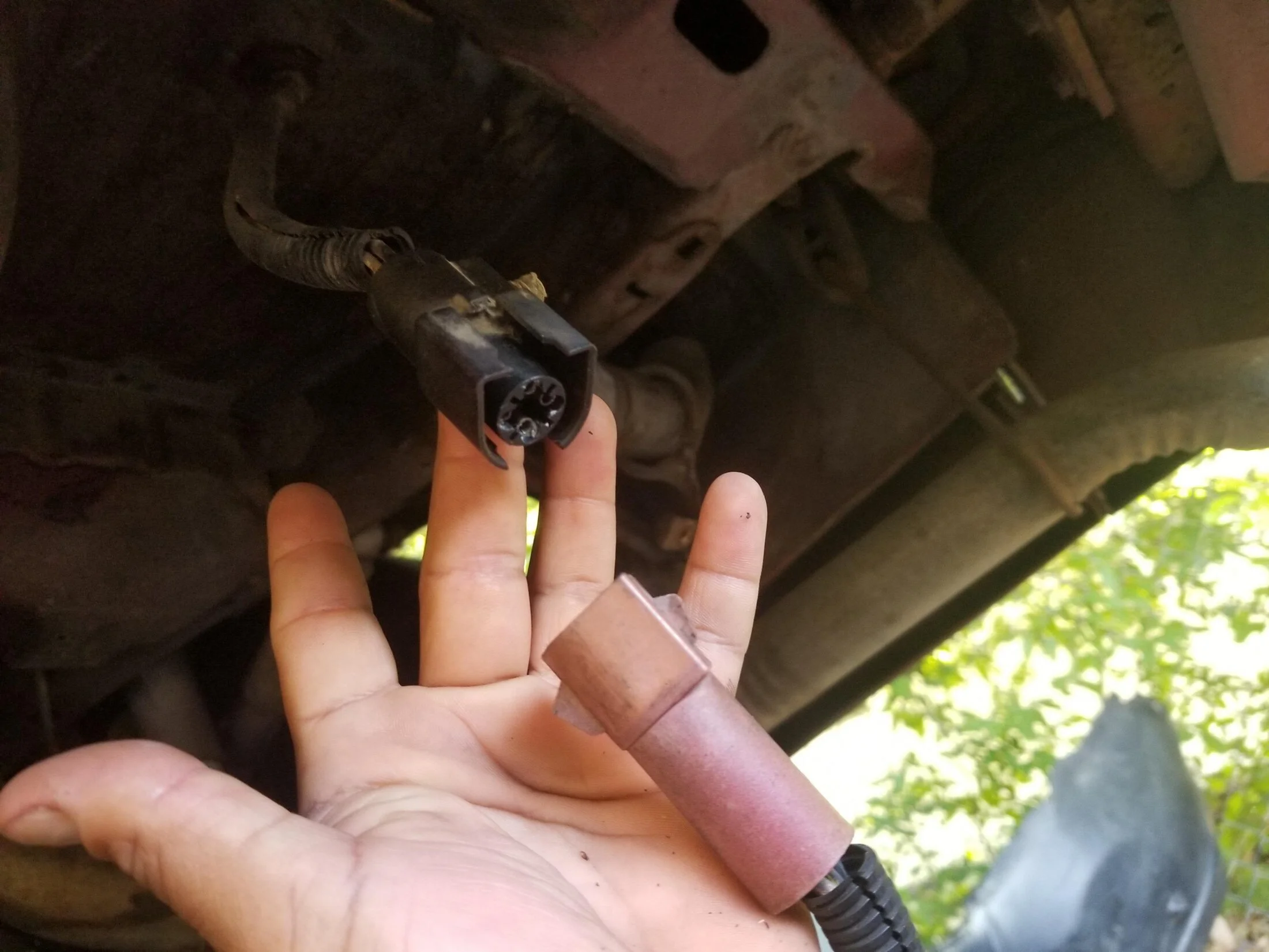

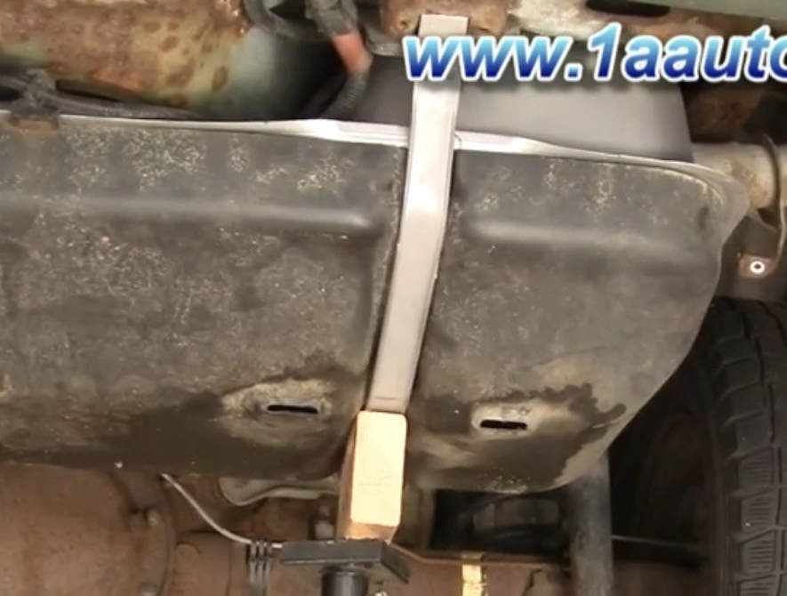

Behind the bumper cover, under the car and just above the fuel tank. This one:
Which you can see in the very upper center of this picture:
So good news I have power at that fuel pump connection you told me to check. Should I just order a new fuel pump and filter and knock that out or are there any more tests I should do to check if it’s anything else
