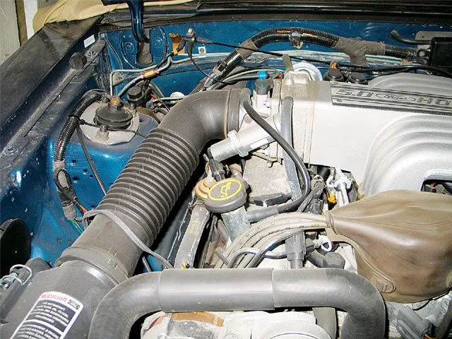

A couple weeks ago I sold two H-pipes to a kid. He pulls up in an ragged out GT. We talk for a little bit and I ask to look under the hood. I was shocked that there was no mass air or speed density on a fuel injected mustang. I stood there in shock. The kid said he bought the car this way and said it thought it idled rough, yeah no kidding.
Why in the world would someone do this? Clearly than can not be a benefit to this, I mean air filter connected to the tube run straight to throttle body, nothing else. Maybe I am stupid and I am not seeing the picture, I highly doubt it though, could there be any benefit to this? :shrug:
Just wanted to know why someone would do this.
Sounds like Speed Density to me:shrug:
you mean it looked like this?
Haha. I forgot why I loved stangnet. "Speed density" is not a physical object that you can see in the intake. Its just a type of fuel injection. It uses just a map sensor rather than a mass air sensor. If there's no mass air then its a SD car.
