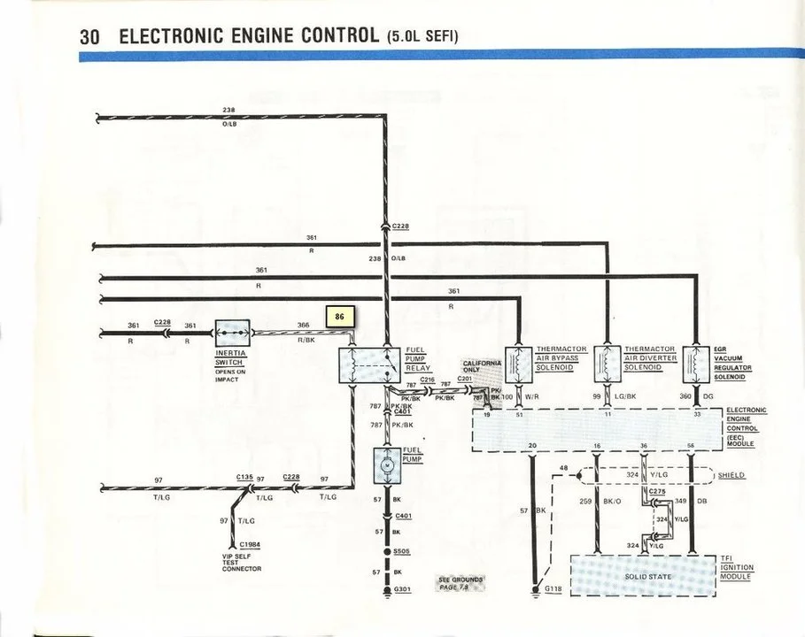

As much as I stare at those diagrams, it still comes down to me trying to trace the actual path of the wires on the car. For example, now that I know the red wire is the one I need to follow, how do I know where it goes next? Which connector does it end up at? I just need diagrams of what wire is what on all of the connectors involved with the fuel pump.
Only two wires on the fuel pump power connector back at the tank - pink/black= power and black= ground.
Check the inertia switch located under the driver's side plastic lining over the taillight. See what color wires are connected to it. The wire colors will help determine which wiring harness/fuel pump wiring scheme you actually have.
After stripping some loom off at the fuel pump relay, I found that the org/blk wire I spoke of looks wht/blk (weird how it could be so different). But bottom line is, it serves the same function as pnk/blk, so I'll call it pnk/blk from here on out, since all the other colors at the relay match what the 91-93 diagrams says they are.
Now with the key in the run position, grn/ylw has power like it should. I went over to the driver's side kick panel area where those connections are, and grn/ylw has still power there. But from there it would normally go back to the inertia switch (if I had a 93 chassis harness). But it connects to a pnk/blk wire. Which I have to assume goes to the relay under the seat, right? The pnk/blk wire at the relay under the seat has 12v only with the key in the run position, then stops there. Now at this point, I'm not sure if that relay is bad, or if it's waiting to receive a signal from somewhere else to click it on.

Plan A: Read this plan over several times before you get started. It will save you much trouble and aggravation.
It is possible to wire up the fuel pump so that it runs, but you will have to add 3 wires to what you already have.

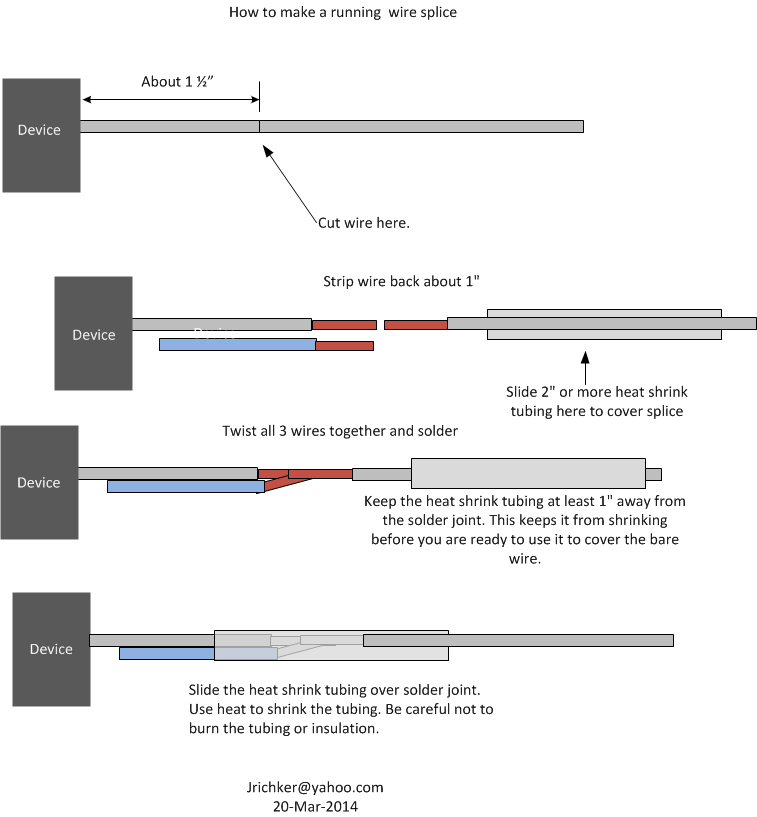

All wire is 105 ○ C temp rated stranded automotive wire. Try to use the same solid wire color scheme to make it easier to troubleshoot. DO NOT USE CRIMP SPLICES TO ADD THE WIRES All splices are soldered and covered with 1/4" or 5/16" heat shrink tubing to insure maximum performance and minimum problems with moisture and corrosion. The heat shrink tubing is available at auto parts stores, Radio Shack, Home Depot and electronics supply stores like http://www.parts-express.com/.
You are going to have to cut the existing wires on the relay socket. See the picture on how to make a proper running wire splice. You may have to unwrap part of the harness to have enough room to work. See the drawing below for the how to do it right.
Use some string to lay out the wire path from one relay to the other. That will give you an idea of the routing and how long the wires need to be. The best path for the wiring is the same one that the harness uses to connect to the computer.
Run 1 length 14 gauge wire from the pink/black wire on the under hood fuel pump relay socket to the orange/lt blue wire on the relay socket under the driver’s seat. This is the power feed for the fuel pump
Run 1 length of 18 gauge wire from the red wire on the under hood fuel pump relay socket to the red wire on the inertia switch. The inertia switch is located the driver's side hatch/trunk under the plastic cover over the taillight. This includes the inertia switch in the fuel pump relay coil circuit to turn the fuel pump off in the event of a collision. This is the power for the fuel pump relay coil.
The original red wire to the inertia switch starts somewhere up near the driver's seat or driver's side kick panel. There is a mystery connector that runs wiring back to the rear of the car in the driver's side kick panel or dash. I have never seen it, but it shows up on the drawings. You may decide to dig for it if you are so inclined. Finding it will save time and wire.
Run 1 length of 18 gauge wire from the lt blue/orange wire on the under hood fuel pump relay socket to tan/lt green wire on the relay socket under the driver’s seat. That is the signal from the computer to close the relay contacts and supply power to the fuel pump.

Something else to consider. There is 12v AT the pink/blk wire in the trunk, before it goes through the floor. Does that make any sense? Also, the car ran at one point the way it is before I acquired it. My brother said it just died one day.
Thank you for your patience and time with all this so far.
Do you have a known good or new relay to swap for the one you currently have?
Does the 12 volts on the pink/black wire go away when you turn off the ignition switch?
Fuel pump power connector - located in wiring harness under the car. It may be hidden between the fuel tank and car body. Check voltages and ground on it.
attachment.php
Power at the pink/blk wire goes away with switch off. All voltages before and after the power connector are what they should be.
Are we talking about the connector a between the body and the fuel tank?
If so, the fuel pump or the connections inside the tank are the only things left.
