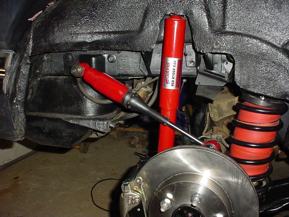

They were On there when I got the car outside of noting that there were aftermarket I'm not really paid that much attention. If I get a chance I'll see if I can crawl under there and find any kind of markings or get a good picture the only thing I know for sure is that they are red.
Yeppers,
